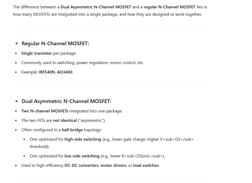

    I have water damage on this HP board and found another HP board with a similar mosfet.
    The big difference I can find on the datasheet is that one is a "30V Dual Asymmetric N-Channel MOSFET" and the other is a "30V N-Channel MOSFET"
    I'll Link the datasheets
    https://www.aosmd.com/sites/default/.../AONH36334.pdf
    https://www.aosmd.com/sites/default/.../AONS36316.pdf
    I could just try it but I'm worried that I might blow other components.
    Anyone have any insight as to whether it's safe to try to replace the component?

    You can ask chatgpt the same question:
    'can you replace AONH36334 with AONS36316 ?'
    Then ask:
    'what is the difference between Dual Asymmetric N-Channel MOSFET and N-channel mosfet?'
    Short answer - NO. One device is with 2 x internal mosfets; the replacement is a single internal mosfet. You may be able to find a proper replacement through Digikey / Mouser / Arrow electronics. If not in a rush, order through Aliexpress.

      Wow I didn't even think to ask AI.
      Okay great. Thanks so much for the help!
