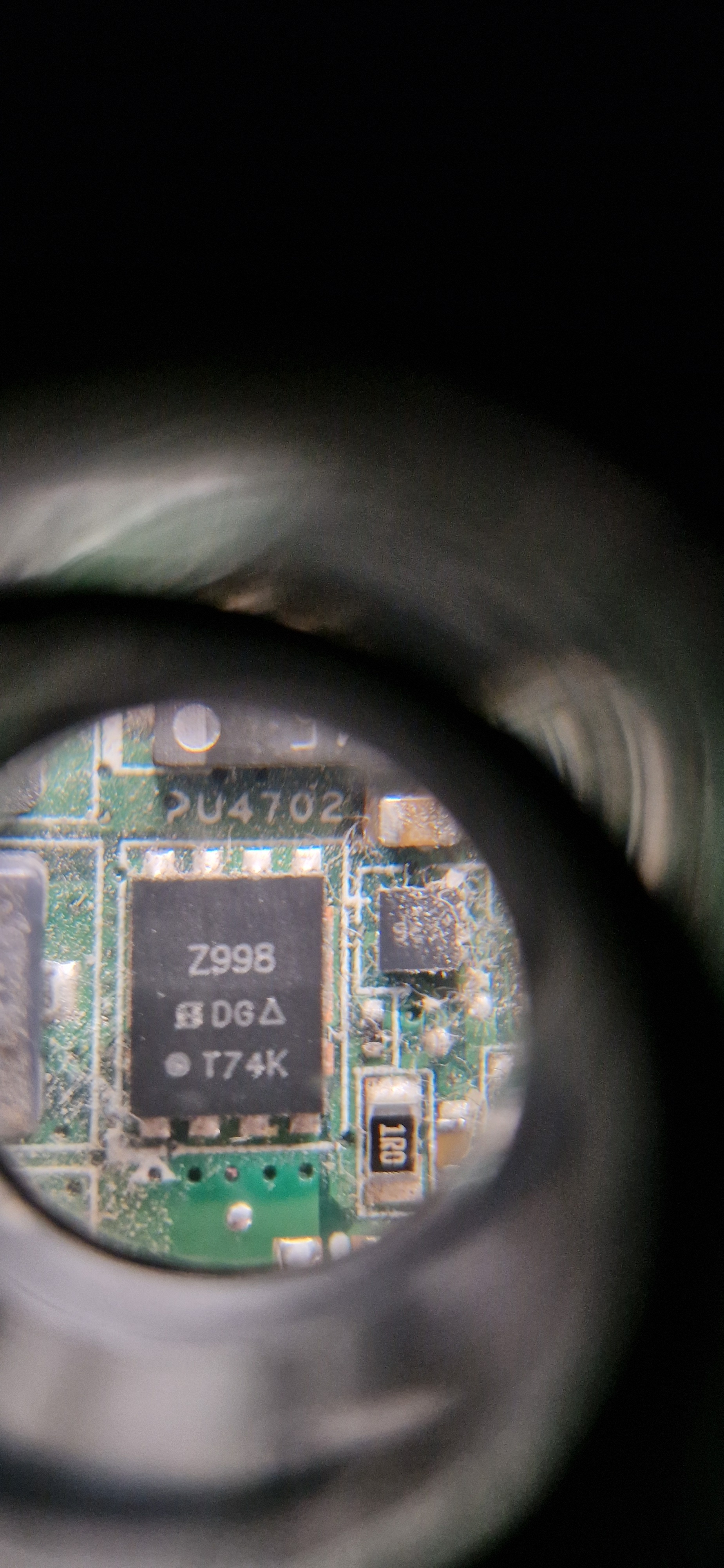

                                    Checked 12 motherboard. not able to found this or anything compatible, very powerful and dual mosfet, rare.
                                    Ordered some, i'll get back when they arrive. I think this was the cause of the problem and i hope CPU is not damaged.

                                      #38
                                      Originally posted by khaahk
                                      Layout is a little different, also less powerful. Try to find some other options.
                                      Replaced the PQ1005 and I get power led when I connected power supply, then I installed some ram and the fans to check post and video output but I never saw power led again.
                                      I think the PQ1005 is not soldered firmly, this motherboard need very high heat to melt solder well.
                                      How can I check if PQ1005 is soldered correctly or not?
                                      • khaahk
                                        • Dec 2013
                                        • 820
                                        • Estonia
                                        #39
                                        Visual inspection only (with microscope if have). Use preheater and remove old solder and add leaded solder. When soldering gently press and solder should come out underneath, then remove excess. Then it should be correctly soldered.

                                          #40
                                          I solder the FET, the motherboard powered up, i installed heatsink and RAM and never came up again, i see strange voltages the are around 500mV and going up and down, meanwhile i just realized the genuine psu of it is faulty, it has 20v but cannot charge any other Lenovo that i have here. Now i'm using a 170w of mine but still no power.
                                          What do you want to measure?
                                          Incredible mess.
