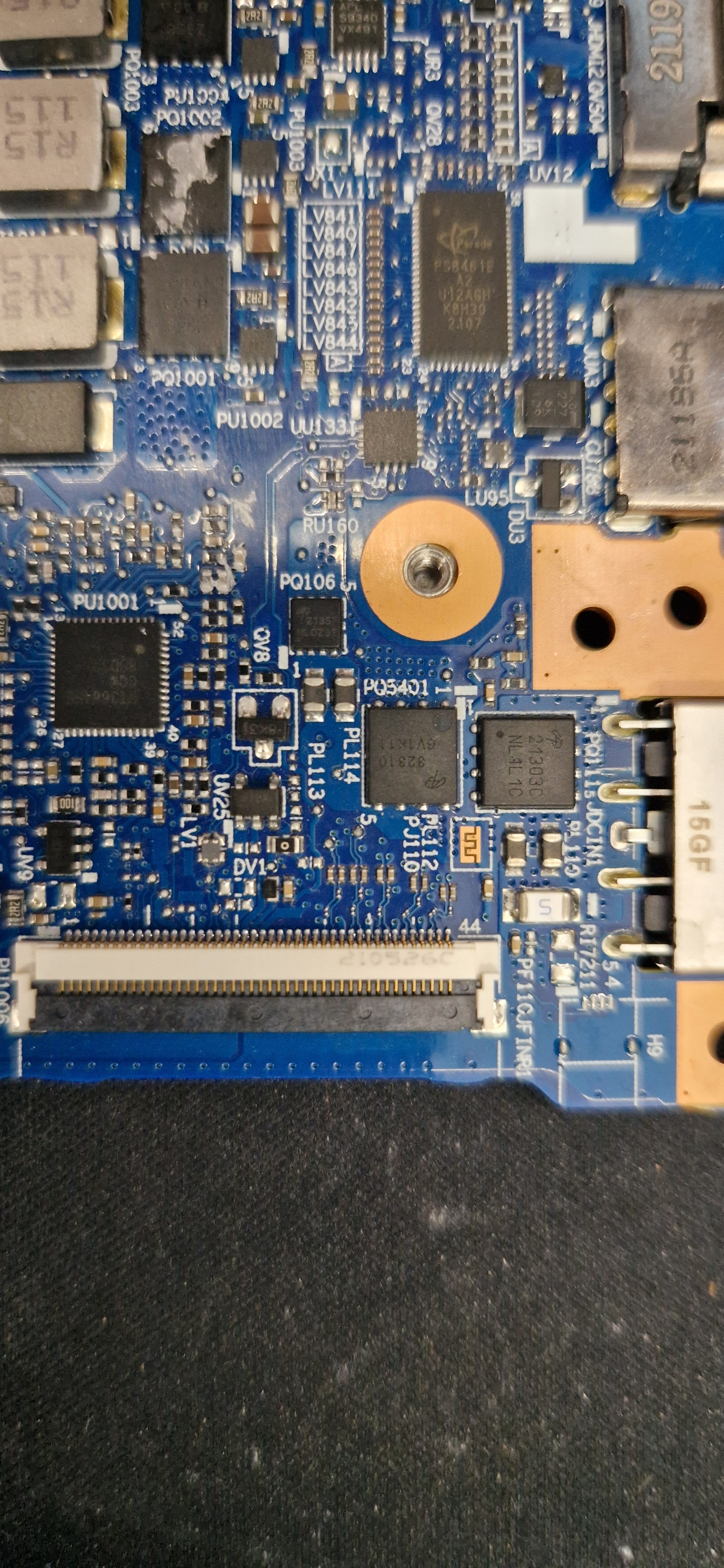

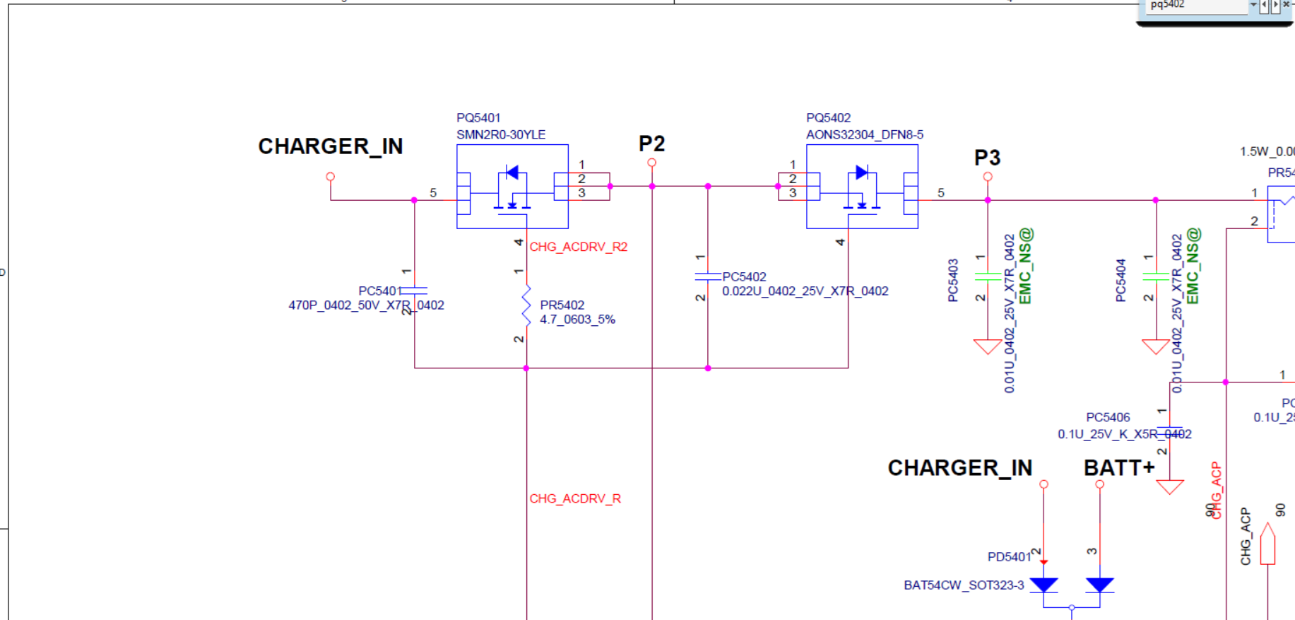

    Hello!
    Today i received a Legion 5 pro with motherboard NM-D562 that suffered water damage, no power at all, no led, no fans, nothing.
    I measure 20v on PQ5401 at pins 5, 6, 7 and 8 but 0v at 1, 2, 3 and 4.
    Is this normal?
    Thanks in advance!

      I have no 3v. I think i get no voltage from PU5401 but not sure, i'm totally dumb in reading schematics.
      If someone is willing to help i'm on the bench now and for the next hours. Thank you!

              PU5401 gets its power via pd5401.
              Voltages on pin 5, 6, 24, 28 of PU5401
              Resistance to gnd on PR5401

                Thank you for replying. To make sure i understand, you want to measure all these voltages and check ground resistance on PR5401 ?

                    Here are the measurements:
                    PR5401 16Ω on both pins to GND
                    PU5401 voltages:
                    pin5 0v
                    pin6 2.68v
                    pin24 6v
                    pin28 30v
                    • Andreasbest

                      *pin28 20v

                        Measure resistance on pin 5 to gnd. If low ohms, remove 24780s and retest. If it changes to high value change 24780s. If not you might have problem with ec.
                        If originally pin5 to gnd measures high resistance - check pullup resistor re42, if it is ok then change 24780s anyways.

                          450KΩ pin5 to GND
                          What is 24780s ?
                          • khaahk
                            • Dec 2013
                            • 820
                            • Estonia
                            PU5401 = 24780S charger ic
                            Change it, most likely at fault.

                              Since i must order it and wait 3 weeks for delivery is there any other measurement to take to verify it's faulty?
                              Also if the charger ic is faulty the motherboard should power up if i connect a charged battery, correct?

                                I don't know no checks that can be done, it is ic-s internal fault. If mainboard has no further problems then it probably should work from battery.

                                  Still dead with fully charged battery. The problem must be somewhere else. Any ideas?
                                  • mon2
                                    • Dec 2019
                                    • 14732
                                    Test the resistance across the 2nd dcin mosfet.
                                    source / drain
                                    source / gate
                                    gate / drain
                                    often 2nd dcin mosfet is defective and takes down the 1st dcin mosfet since they share the gate pins.
                                    no power to the board during these tests.
                                    • Andreasbest
                                      • Aug 2014
                                      • 1197
                                      • Hellas ( Greece )
                                      Thank you but which one is the second dcin mosfet?
                                      • mon2
                                        • Dec 2019
                                        • 14732
                                        PQ5402
