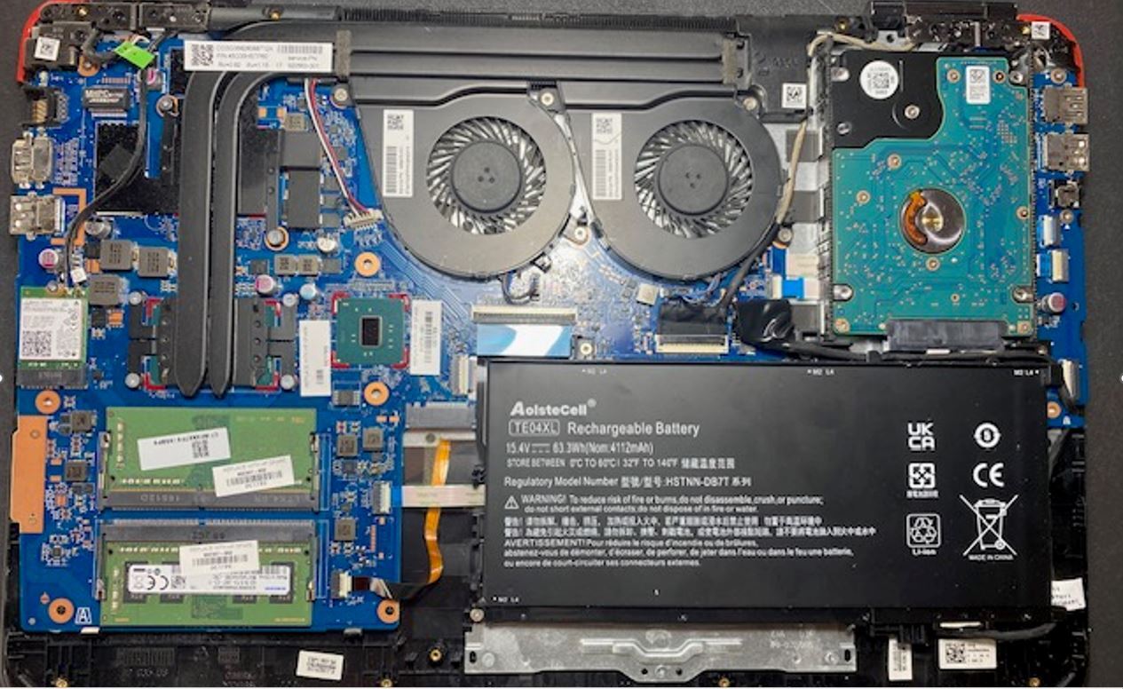

    I have an HP OMEN 15-ax204ns laptop, purchased in 2018, with the following specifications:
    • Intel(R) Core(TM) i7-7700HQ CPU @ 2.80GHz
    • 4.00 + 4.00 GB RAM
    • 1TB hard drive
    • Product ID: 00325-96088-89605-AAOEM
    • Operating system: Windows 10 64-bit
    It is in its original state, with no hardware modifications except for the battery, which had swollen and was replaced with a compatible one.
    Haga clic en la imagen para ver una versión más grande  Nombre:	001.jpg Visitas:	0 Size:	181,5 KB ID:	3672586
    For three or four months, I used the new battery without any issues, but one day it wouldn't charge past 20% — it just stayed stuck there. I searched online and found suggestions to disconnect the battery to reset it, which I did, and the problem disappeared — the battery charged to 100% again. However, a few days later, the same thing happened. I disconnected it again, and it returned to normal.

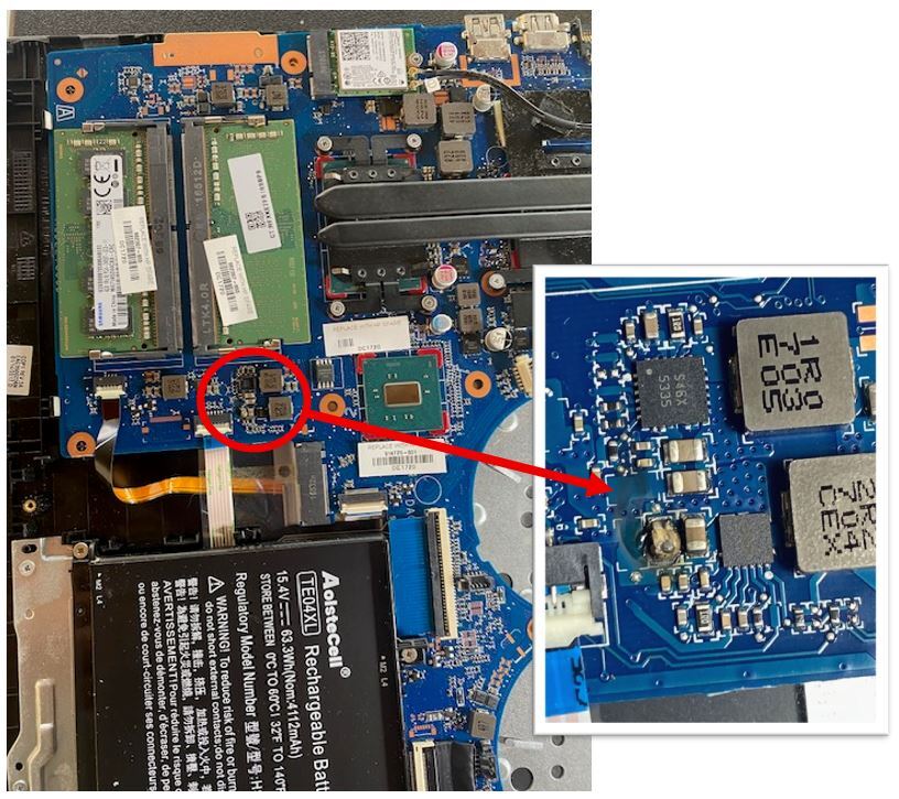

    While working with the laptop on battery power, it suddenly shut down and I noticed a faint burning smell. I opened the laptop and found this component melted:

    The burnt component is a capacitor, likely in parallel with the one next to it
    It can be removed with no side effects, try with the soldering iron, adding leaded solder to both ends, as you have a plastic connector very close to it that can get burned with hot air
    Usually that type of caps fail shorted
    Remove the motherboard from the chassis first
    If you wish to replace it, very likely it's a 10uF 25V 0805 size ceramic capacitor

        Usually ceramic caps sometimes fail shorted on their own, sometimes you can see a tiny crack with a microscope
        In your case it likely failed shorted, then burned until it's no longer a short
        The exact cause of ceramic capacitor failure is unknown to me

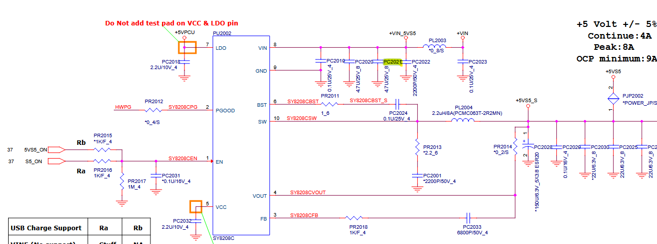

            I think its this one DAG35DMBAD0, the board number is under the keyboard connector; post #3
            https://www.badcaps.net/forum/troubl...men-15-ax205ns
            Burnt cap is PC2021, 4.7uF 25V 0805 size; according to the schematics and boardview
