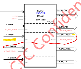

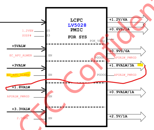

    Do you mean EC_APU_ALWEN? Pin 34 of UE1, also available at RE66
    Click image for larger version  Name:	18valw.png Views:	0 Size:	70.8 KB ID:	3668884
    If the 1.8VALW works, then the LV5028 should create APUALW_PWRGD, this block diagram is slightly wrong as 0.9VS is enabled from SUSP# (not EC_APU_ALWGD), according to page 41

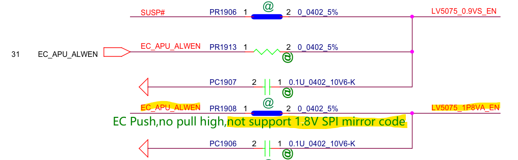

    There's an interesting note on page 41 "EC Push,no pull high,not support 1.8V SPI mirror code", maybe it means that the EC cannot program itself from BIOS when empty?
    "EC Push,no pull high" probably means that there's no pull-up resistor (actually, there's a pull-down RE66) and the EC "pushes" 3.3v to enable the 1.8VALW
    I'm trying to make sense of the notes left by the Lenovo engineers on the schematics....,
    Click image for larger version  Name:	ec_apu_alwen.png Views:	0 Size:	50.5 KB ID:	3668885
    It could be the result of the EC not being programmed

      You did have 1.8V before, something changed here
      Yes Before EC replacement 1.8v was present
      Yes I mean that, it does not present that is why 1.8v not turning on.
      This is where i got also confused because i was thinking maybe 1.3v is there because a pull-up resistor, and it is nedded for EC self programming, but this BIOS chip needs 1.65v at least to read, so no idea whats going on.

        Expert says that until i dont have 3VS i wont be able to program the EC with Vertyanov, and since SUSP# (3VS_EN) is missing here (3VALW and 5VALW Powergood signals present)
        I dont know it anything will help or the new EC is faulty.
        • questore
          • Dec 2015
          • 462
          • csongrád
          I have managed to write the EC (it was not empty but full of code)
          After reprogrammming with correct EC firmware now the 3VS and 1.8VALW is good ,
