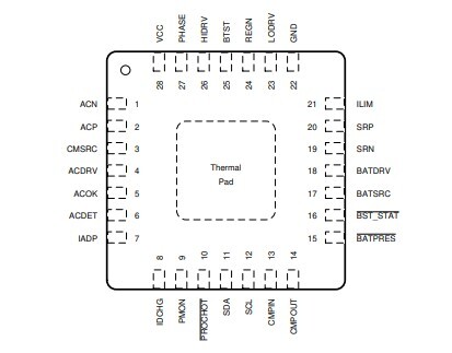

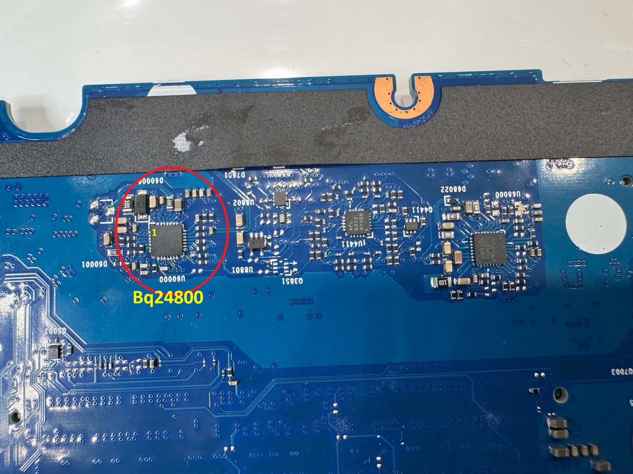

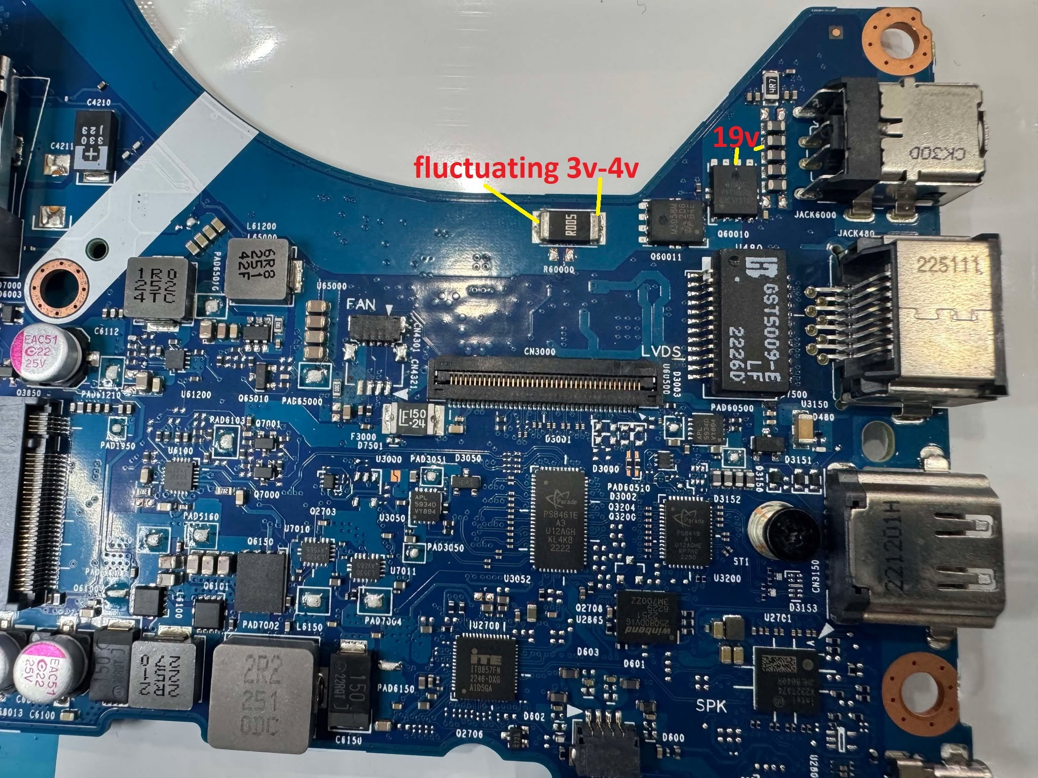

    I have ASUS laptop FX507 when i plug-in the charger nothing happens or the amperes not even raising up it stays to 19.5v(SETTINGS). I decided to disassemble the back case to check the voltages first. I found out that when i test the current sensing resistor for voltage it was fluctuating voltages(3volts to 5v then loop), i checked the voltages of the BQ24800 Battery Charge Controller:..i started with the pin 1 and the results are:
    1. 3.5v to 3.9v
    2. 3.5v-3.9v
    3. 0.3v-1.4v
    4. 0.3v-1.2v
    5. 0v
    6. 2.6v
    7. 0v
    8. 0v
    9. 1.6v
    10. 0v
    11. 0.04v-1.1v
    12. 0.2v- 1.2v
    13. 0.2v
    14. 6v
    15. 0v
    16. 0v
    17. 0.2v
    18. 0.2v
    19. 0.2v
    20. 0.2v
    21. 0.2v-0.9v
    22. 0v
    23. 0v
    24. 6v
    25. 6v
    26. 0.2v
    27. 0.2v
    28. 19.5v
    i Need help, Any idea before i change anything or i suspect the charging IC to be replace, i test the 1st and 2nd mosfets from chrging pin it is not shorted or leaky.. thank you.

    ACDRV pin #4 is not boosted to the expected ~25v so there is a fault in the power path.
    The DCin mosfets are still suspects. Remove all power. Meter in resistance mode.
    Measure each of the DCin mosfets:
    source / drain
    source / gate
    gate / drain
    Post each measurement. Start with the 2nd DCin mosfet (as per sticky above on charger circuits by piernov).

        Resistance to GND on Current Sensing Resistor?
            i try to read the resistance to ground on Current sensing resistor is 20Mohms, seems to be good.
