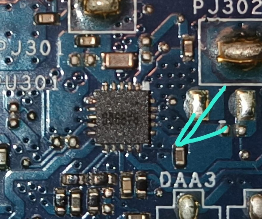

                              Do us a favor share a new picture of this exact controller including the surrounding circuit. A clear and high quality close-up please. Thanks.

                                #95
                                Like this? Click image for larger version

                                  Originally posted by giulio93
                                  Like this?
                                  Measure resistance to GND and voltage at this cap.

                                    #97
                                    Just 2.7 Ohm. you were right! So the pin17 rail Is shorted to gnd.. to find the shorted components i can inject 1V in this cap and see what goes hot, correct?
                                    • Sephir0th
                                      • Oct 2020
                                      • 1289
                                      #98
                                      Yes, there will most likely appear the embedded controller being shorted.
