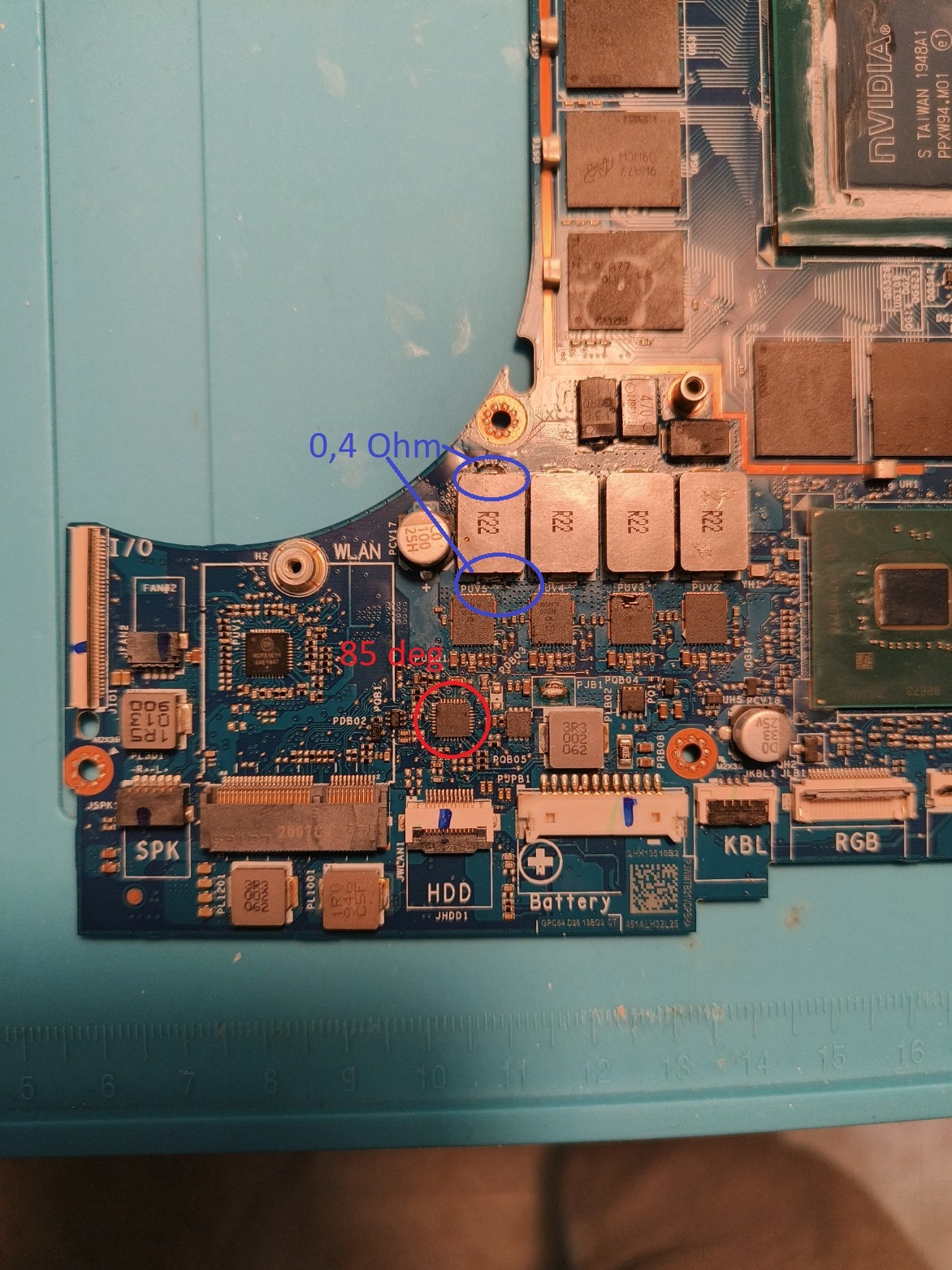

    Hi everyone, I have this gaming laptop that during the usage suddenly shutted down. I disassemble it and take some mesurments. I have a lab supplier and a thermocam. I tryed injected voltage at the DCIN connector and I see this little chip went up to 85 deg (at 19V) this chip should control the battery charge. Next i mesure the resistence at the big coils on top of it and the value is 0,4ohm so dead short.. Those 4 phases are the power supply of the Nvidia GPU?
    I tried to inject 1V at that coil and i get 1.35A dwawn but nothing heat up

    Do not worry about the GPU rails as GPU devices, in general, will have a low resistance to ground and this is by design.
    What are the top side markings of the part that is heating up to 85 deg?

      0,4 ohm is still a normal value? I hope i did not damge anything with the injection. Fortunatelly i stay low at 1V
      Intersil 88739A

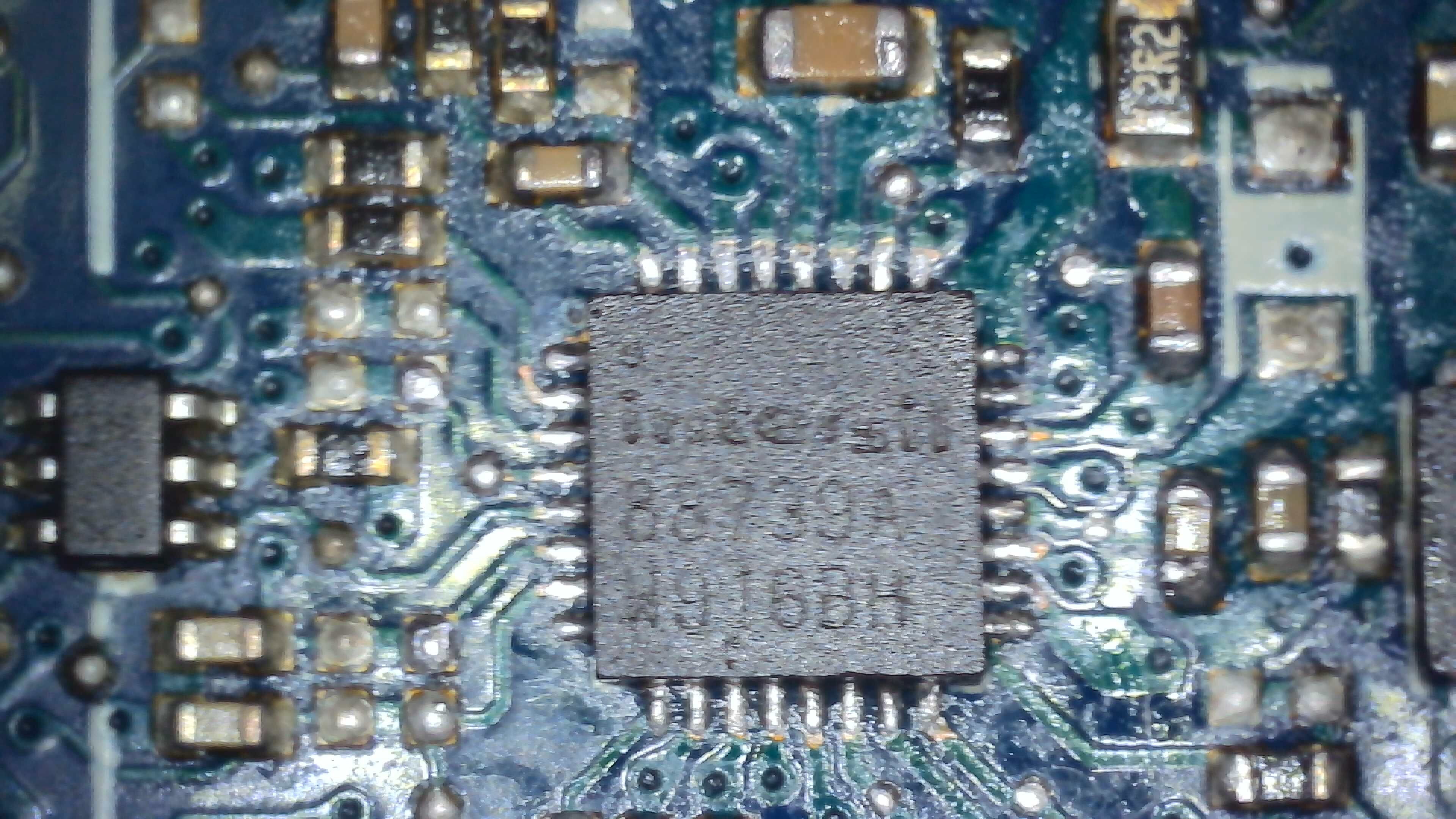

            The new Intersil Chip arrived from Aliexpress. I tried to solder it on the mobo but it seams like the new chip doesn't take any solder but on the gnd central pad. Why? It is normal? How can i fix that?

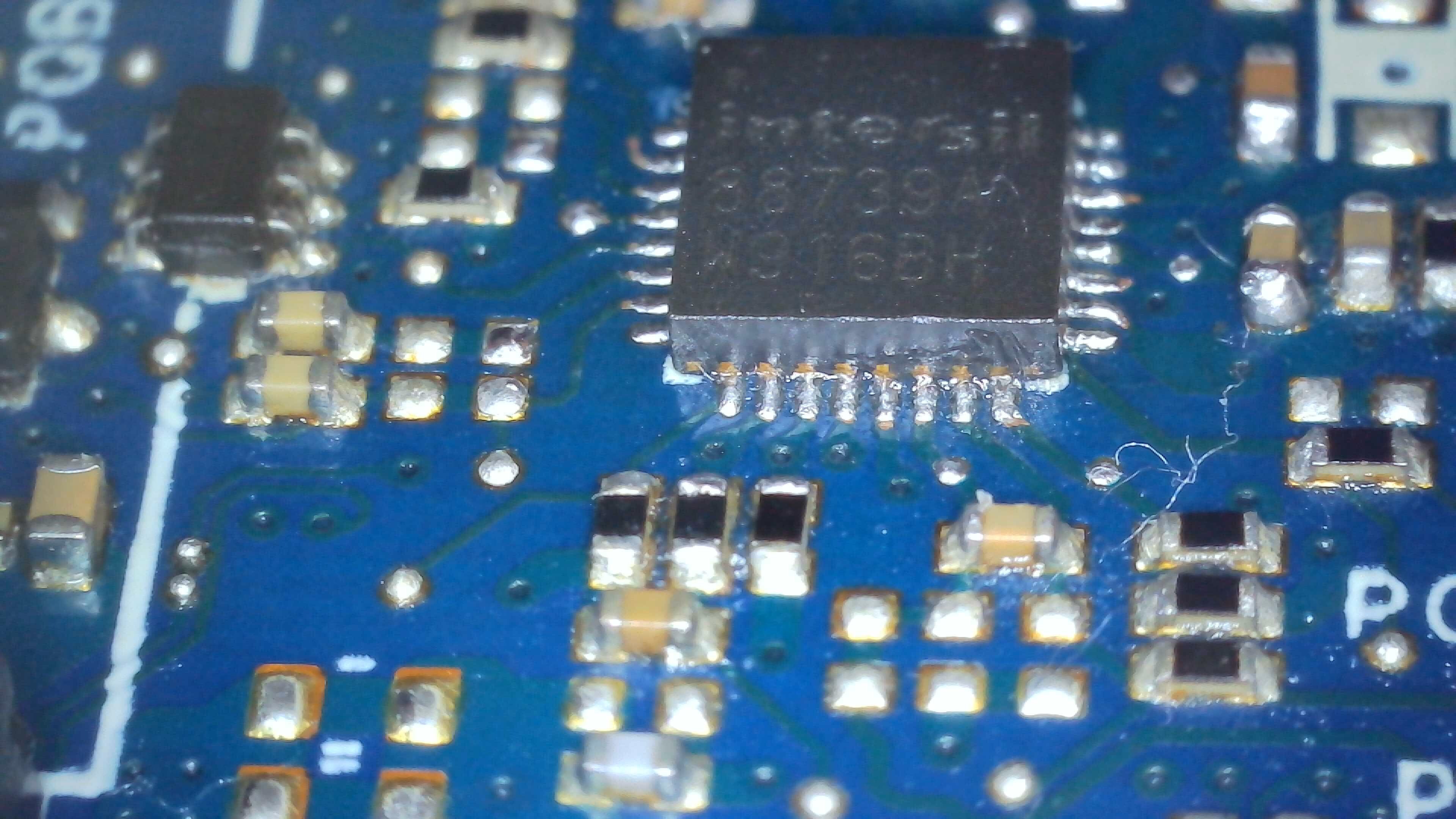

              I think now i solder the chip well and i have the same problem as before. Some of the nearby lines get shorted and chip chip reach immediately 90° if the charger is plugged in. Can anyone can help me figuring out the problem?

                I don't understand the theory. With the chip on board the I have some shorted linea around It, if i remove It the short disappears. So the problem should be the chip? Isn't It?

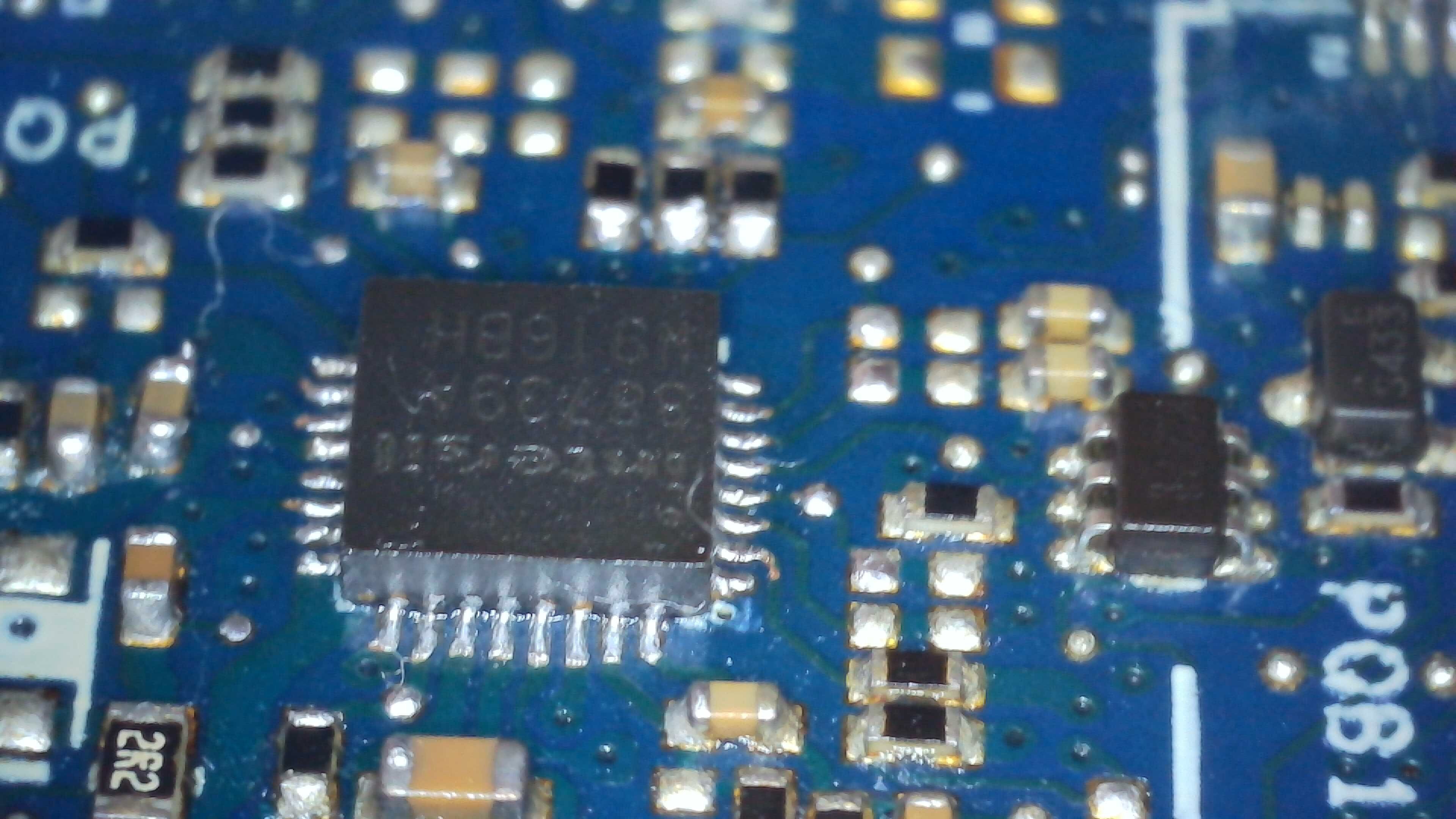

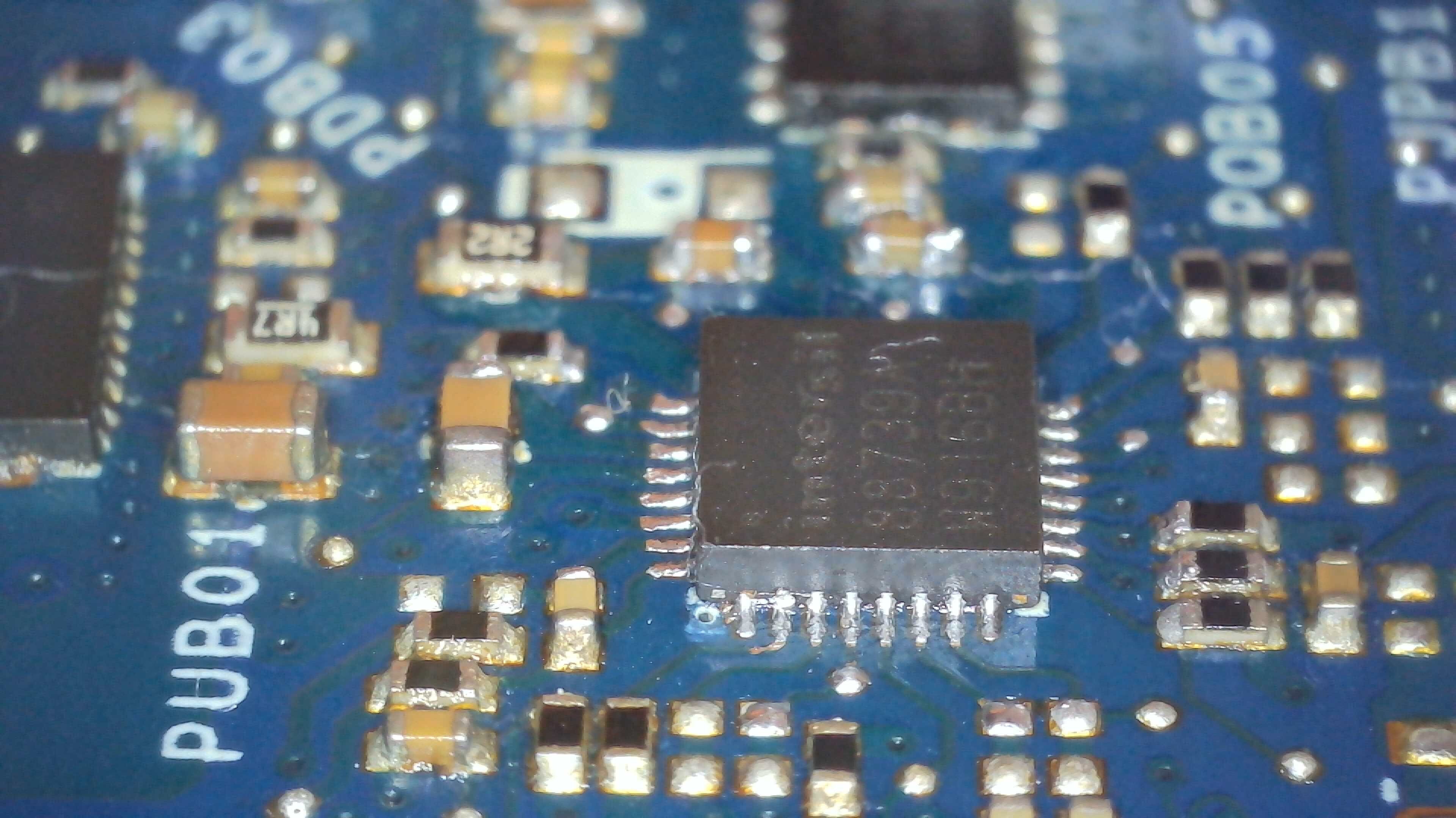

                                Here the solder joint. They seam fine to me, what do you think?

                                  CLR stands for current sensing(limiting) resistor.Usually located after 2 dc -in mosfets.
                                  Charging IC seems properly soldered,however, ACOK is pulled low.
                                  You have not shared the resistance readings of 2 dc-in mosfets .
                                  Measure voltage on pin 1/4/8 od 2 dc in mosfets also.
                                  You bburnt the ic while measuring 'coz your multimeter probes are thick.Get a needle sharp pair of probes.
