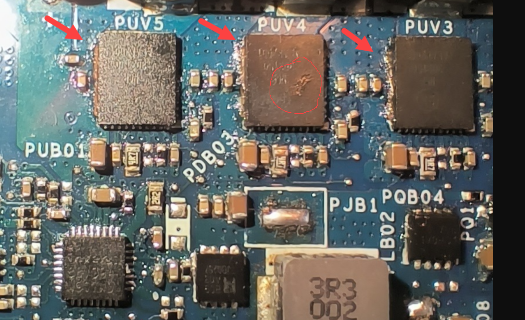

    Trying to relate to your board layout and agree that PUB01 is your charger IC. Not confident the 3 devices are the mosfets of interest.
    Is there a mark on the middle device? Is this a defect on the top surface? If yes, this part may be defective and needs to be replaced. What are the topside markings of each of these parts?

      #42

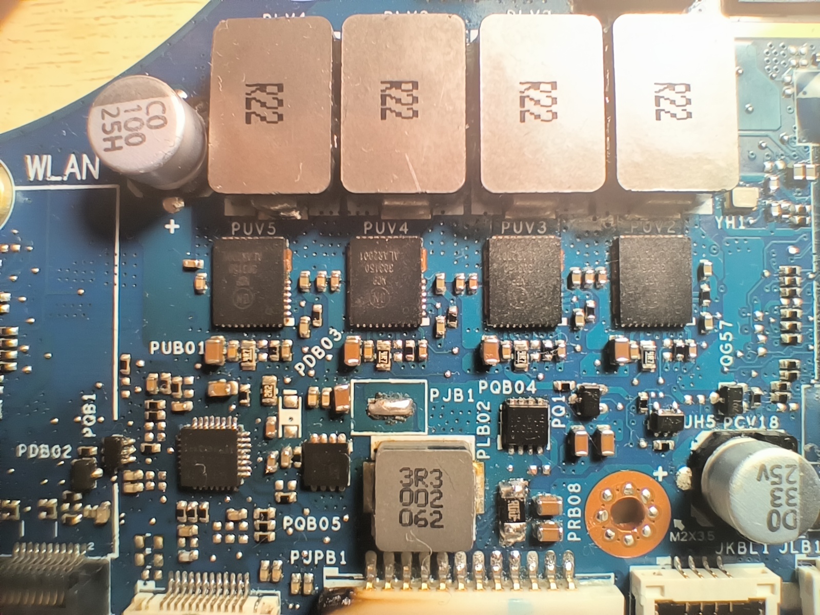

      Sorry mon2 I ddidn't understand your reply.
      We were talking about the voltage of the ACOK that seams to be low, we are still looking in that direction? I'm confused
      Here the pics of the 4 mosfet you ask me for. Top marking ON NCP 303150 ALAR2001

        #43
        The 4 mosfets are not the mosfets of interest to us at this time. These parts are the multiphase power supply mosfets that take turns to power the cpu so that not one mosfet is burdened by the heavy demand. The cpu is a large current draining device and a single mosfet would heat up too quickly.
        Share again the full topside markings of PUB01. Often this part is the charger IC. From this detail we can find a datasheet and locate the ACOK pin then trace that signal further. On the ACOK pin will be a pull up resistor. We need to hunt for where this resistor travels to locate the power rail that may be defective.

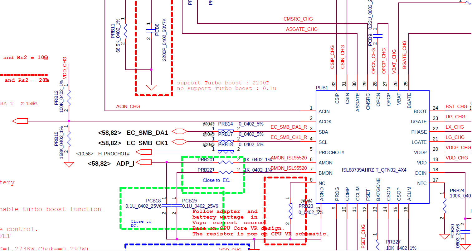

                Yes, it is stupid mentality of the semiconductor and the logic board companies to hide datasheets like this one from the public. Anything can be hacked and reverse engineered with enough time. What is to be gained to hide the datasheet for this part? It is only a battery charger IC. Throw it in the garbage if it is not available? Obviously everyone and their mother can access all sacred documents. They always leak out overseas. For a price, anything can be purchased.
                The charger IC from the posted schematic is very likely to be similar to your board here:
                Review the location of pin #1 which will be dot on the IC. Then count counter clockwise to locate the next pin = pin # 2. Nearby this pin should be 2 small tiny black parts (resistors) camped on this pin.
                One will be a pull-up and another a pull-down like the above schematic. Confirm their location. Post close up clear pics of PUB01 on your board. This should allow us to hunt for these parts. This is the ACOK pin.

                  #48
                  Your pics in post #16 offer details of pin #1. Top left side is pin #1.
                  Go down by 1 pin for pin #2. To the left of this ic are 2 black resistors. With no power, measure their resistance across their body. Post the measurements.

                              The 2v8 looks to be in the proper range for a logic '1' = true state that the adapter is OK. The pull up voltage of 5v2 is important.
                              What is the voltage to ground of pin #1 (Vin)? Assuming it is the adapter voltage since ACOK is '1'.
                              If you meter probes are fine enough, continue to monitor each of the pins on this charger IC with a steady hand. Post the full list of the voltages and their pin #1 (with function) for a review.
                              For example, suspecting that the SMBUS lines SCL / SDA should be ~3v3 each.

                                      #58
                                      Pin 1 is ACIN
                                      Pin 2 is ACOK ; voltage on this pin is 0v?
