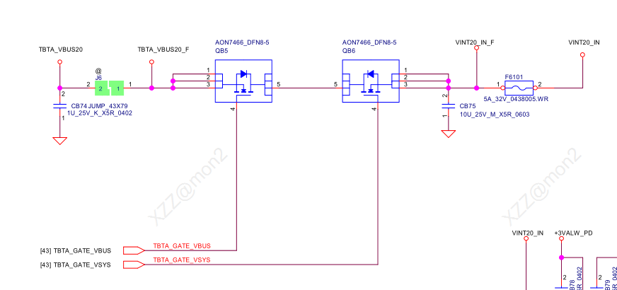

Lenovo E14 gen. 2, NM-D011, no start
  • dhs6512
    • Oct 2019
    • 38
    • Литва
    Lenovo E14 gen. 2, NM-D011, no start
    Hello, Lenovo Thinkpad E14 Gen.2 Type 20TA, GE4B0/GE5/B0 NM-D011 Rev. 1.0 board. Arrived in the following state: the device is always on and goes in a cycle: the "on" LED lights up, goes out after a few seconds and lights up again, cannot be turned off with the button. Inspection of the board is ok. The charger switches from 5V to 20V. I read that it seems to be a typical problem: the input MOSFETs QB5, QB6 do not open enough and get very hot due to the fact that TPS65994ADYBGR does not supply 28V to the gates. In my case, there were 21.4V on the QB5 gate, 28V on the QB6 gate, but the input MOSFETs do not heat up. The board is leaking, it seems to be approximately in the TPS area. The type-c jack is ok. The TPS strapping is ok. I changed the TPS (took from 2 sources), changed the input MOSFETs, no changes. The voltage of 21.4 V is not constant, but has a sawtooth shape, as if it is trying to reach 28 V and drops to 20 V. Consumption is 4-5 mA. Voltage and resistance on the TPS are ok, there is exchange on CC1 / CC2. I removed the capacitors that could theoretically affect (CB74, 75, 81) and the DB18 diode - no changes. Please tell me what else to look at, what could be leaking, are there really 3 TPS and all of them are defective? Thank you
  • mon2
    • Dec 2019
    • 14672
    For each mosfet in the power path, test the resistance with no power to the board.
    Measure:
    source / drain
    drain / gate
    gate / drain
    Post each measurement. Each should be hundreds of k ohms or higher else the mosfet may be defective. Test QB5 & QB6 for now.
    The gate voltage on an N-channel mosfet must be boosted to a higher value than what is being passed between source / drain pins to enable. If you see 28v on QB6, I can only assume that QB5 should be similar unless QB5 is defective.
    • dhs6512
      • Oct 2019
      • 38
      • Литва
      Thank you.
      Measured:
      QB5
      source / drain 1,08kohm
      drain / gate 3mohm
      gate / drain infinity
      QB6
      source / drain 1,08kohm
      drain / gate 3,1mohm
      gate / drain infinity​
      • mon2
        • Dec 2019
        • 14672
        The source / drain on each is too low. Flux and remove the mosfet(s). Test them again when they are on your workbench. Both may be defective.
        • dhs6512
          • Oct 2019
          • 38
          • Литва
          Thank you, you have right, one of them (was new !!!) was defective, replaced both, now I have 28v at both gates, power consumption 8-12mA
          • hamzafox
            • Nov 2019
            • 87
            • SYRIA
            Originally posted by mon2
            The source / drain on each is too low. Flux and remove the mosfet(s). Test them again when they are on your workbench. Both may be defective.
            Hello i have same board no power ,Q85 Drain 4,5v source 4,5v
            Q86 Drain 4,5 v ssource 0,4 v
            I have replaced a new chiip ub7 but to no avail. Please can you help me
            • mon2
              • Dec 2019
              • 14672
              ,Q85 Drain 4,5v source 4,5v
              Q86 Drain 4,5 v ssource 0,4 v
              I think you are referencing QB5 & QB6 = AON7466 N-channel mosfets?
              Datasheet:
              https://www.aosmd.com/sites/default/...ts/AON7466.pdf
              Being N-channel, the gate voltage must be higher than the voltage being passed between source / drain pins to enable this solid state switch.
              What is the voltage to ground on the GATE pin # 4 of QB5? QB6?
              Remove all power. Meter in resistance mode. Measure the resistance to ground of the SOURCE pins (1-2-3) - pick any of these pins. We are testing if there is a shorted part on the main power rail which may be causing this mosfet to remain disabled. Driven by the TBTA_GATE_VSYS signal.
              Also, what is the source of UB7? Was it from a donor board or a vendor? Not sure at this time if the chip needs to be pre-flashed to use as this is the PD controller for the logic board so there is a need for firmware. Perhaps the firmware is injected by an outside host on the board or local flash IC or even the main BIOS.
              • hamzafox
                • Nov 2019
                • 87
                • SYRIA
                Originally posted by mon2
                I think you are referencing QB5 & QB6 = AON7466 N-channel mosfets?
                Datasheet:
                https://www.aosmd.com/sites/default/...ts/AON7466.pdf
                Being N-channel, the gate voltage must be higher than the voltage being passed between source / drain pins to enable this solid state switch.
                What is the voltage to ground on the GATE pin # 4 of QB5? QB6?
                Remove all power. Meter in resistance mode. Measure the resistance to ground of the SOURCE pins (1-2-3) - pick any of these pins. We are testing if there is a shorted part on the main power rail which may be causing this mosfet to remain disabled. Driven by the TBTA_GATE_VSYS signal.
                Also, what is the source of UB7? Was it from a donor board or a vendor? Not sure at this time if the chip needs to be pre-flashed to use as this is the PD controller for the logic board so there is a need for firmware. Perhaps the firmware is injected by an outside host on the board or local flash IC or even the main BIOS.
                Q85 drain 8.80V source 4.95V GATE 4.70V
                Q86 drain 8.80V source 0.440V GATE 0.8V
                I replaced a new chip UB7 and I don't know if it was programmed before, but I still have the original part.
                • mon2
                  • Dec 2019
                  • 14672
                  The drain pin measurements do not make sense. The Vin is ~5v from the USB Type C power adapter so the most you should see is ~5v on the drain pins. Can you confirm the meter you are using is with fresh batteries?
Name:	dcin_mosfets.png
Views:	169
Size:	38.2 KB
ID:	3627345
                  Remove all power. Meter in resistance mode.
                  Measure the resistance across the mosfet pins:
                  source (1-2-3) & drain (5-6-7-8)
                  source (1-2-3) & gate (4)
                  gate (4) & drain (5-6-7-8)
                  Post each measurement. Test both dcin mosfets.
                  • hamzafox
                    • Nov 2019
                    • 87
                    • SYRIA
                    Originally posted by mon2
                    The drain pin measurements do not make sense. The Vin is ~5v from the USB Type C power adapter so the most you should see is ~5v on the drain pins. Can you confirm the meter you are using is with fresh batteries?
                    Click image for larger version  Name:	dcin_mosfets.png Views:	0 Size:	38.2 KB ID:	3627345
                    Remove all power. Meter in resistance mode.
                    Measure the resistance across the mosfet pins:
                    source (1-2-3) & drain (5-6-7-8)
                    source (1-2-3) & gate (4)
                    gate (4) & drain (5-6-7-8)
                    Post each measurement. Test both dcin mosfets.
                    Q85 source, drane 7,15M OHM
                    source gate 9,20M OHM
                    gate drain infinity
                    Q86 source, drane 7,15M OHM
                    source gate 9,05M OHM
                    gate drain infinity
                    When I connect the MOSFET Q86 to a wire it works but the battery must be connected when I remove the battery the device stops working
                    • mon2
                      • Dec 2019
                      • 14672
                      The mosfets do not look to be shorted but are not enabled under normal wiring.
                      When I connect the MOSFET Q86 to a wire it works
                      ?? Provide more details. Which wire? Which pin? Also the mosfets are QB6 - right? Not Q86. Q86 is not showing in my schematic.
                      Also, with the 'wire connection' - can the power adapter power the logic board or do you still need the battery? The battery cannot power the board unless you connect this bypass wire?
                      • hamzafox
                        • Nov 2019
                        • 87
                        • SYRIA
                        Originally posted by mon2
                        The mosfets do not look to be shorted but are not enabled under normal wiring.
                        ?? Provide more details. Which wire? Which pin? Also the mosfets are QB6 - right? Not Q86. Q86 is not showing in my schematic.
                        Also, with the 'wire connection' - can the power adapter power the logic board or do you still need the battery? The battery cannot power the board unless you connect this bypass wire?
                        Yes, that's right. I didn't pay attention well. İts QB6
                        When I remove this mosfet QB6 and connect source with drain with tweezers the device is workink but must battary be connected when i remove the battery the device not working
                        • mon2
                          • Dec 2019
                          • 14672
                          Measure the voltage again on the drain pins of these mosfets. Red meter probe on drain pin (5-6-7-8); black to ground. This voltage should be the Vin from the USB-C Vbus pin.
                          • hamzafox
                            • Nov 2019
                            • 87
                            • SYRIA
                            Originally posted by mon2
                            Measure the voltage again on the drain pins of these mosfets. Red meter probe on drain pin (5-6-7-8); black to ground. This voltage should be the Vin from the USB-C Vbus pin.
                            QB5 drain 4.66V SOURCE 5V GATE 4.5V
                            QB6 drain 4.66V SOURCE 0.4V GATE 0.1V​
                            • coasterghost
                              Lenovo T14 Gen 2 Type 20XK Model 20XK0069US Odd Charging Issues
                              by coasterghost
                              For Badcaps Readers, Please note that I am hopefully going to present this same message to Lenovo to see if they have any insight to the matter as well and figured to share the entirety here for clarification. The System is out of warranty as it is but does have the option to have it extended.
                              Model Information: T14 Gen 2 (Type 20XK, 20XL) Laptop (ThinkPad) - Type 20XK - Model 20XK0069US
                              Board: T14 Gen 2 (Type 20XK, 20XL) - Type 20XK.
                              System Hardware:
                              Processor: AMD Ryzen 7 PRO 5850U
                              Memory: 1x 16GB DDR4 3200 (Soldered on Board); 1x Crucial 32GB DDR4...
                              09-08-2025, 10:46 PM
                            • tantr13
                              Lenovo Ideapad 5 14ITL05 not powering on
                              by tantr13
                              Hi everyone,
                              This is my first post so I'm hoping to get some help on this awesome forum. As a preface, I'm an amateur at electronics, especially troubleshooting complicated devices like laptops. However, I'm trying to develop a skill for it so I can learn how these devices work and how to repair them without continuing the wasteful tradition of throwing them away and buying new. 🤮
                              I've had a Lenovo Ideapad 5 14ITL05 for a few years now, with motherboard LA-K321P. I would never leave it plugged in unless I was using it, and always turned it off after I was done, but last week...
                              06-28-2024, 06:28 PM
                            • NanoTesting
                              Lenovo Ideapad 15IIL05, turns on and off with charger BUT works by injecting 20v after main mosfets
                              by NanoTesting
                              I got a 15-IIL05 that failed to turn on BUT IT DID TRY TO TURN ON and then turned off after 30+- seconds, i disassembled it and found a screw loose inside the case.
                              With charger it turns on, fan spins but gives no image.
                              Tested main mosfets no short, tested 3.3v,5v,DRAM, CPU etc and they were present.
                              Reflashed BIOS, same problem.
                              Replaced both main mosfets.
                              Checked main mosfets again and i noticed that they closed once the laptop shut down, so i decided to bypass them and used a bench PSU to check how much power the laptop was drawing while trying to turn on, 20v@3A,...
                              10-30-2024, 10:48 PM
                            • tofik
                              MOSFET equivalent K8A60DA
                              by tofik
                              Hello guys,
                              I have a shorted MOSFET K8A60DA with the following characteristics:
                              Type Designator: TK8A60DA
                              Marking Code: K8A60DA
                              Type of Transistor: MOSFET
                              Type of Control Channel: N -Channel
                              Maximum Power Dissipation (Pd): 45 W
                              Maximum Drain-Source Voltage |Vds|: 600 V
                              Maximum Gate-Source Voltage |Vgs|: 30 V
                              Maximum Gate-Threshold Voltage |Vgs(th)|: 4 V
                              Maximum Drain Current |Id|: 7.5 A
                              Maximum Junction Temperature (Tj): 150 °C
                              Total Gate Charge (Qg): 20 nC
                              Rise Time (tr): 25 nS
                              Drain-Source
                              07-19-2023, 05:18 AM
                            • mkdj
                              Acer TravelMate P214 - N19Q7 main power rail shorted to ground
                              by mkdj
                              Dear all,
                              I have taken out the motherboard of a Acer TravelMate P214. There is a short to ground on the main power rail (19V). I don't have the schematics or boardview for this board (DAZ8IMB1AA0 REVA). But I have found 4 MOSFETS close to the main power rail : 2 N-Channel and 2 P-Channel.
                              I have checked resistance across each of the 4 MOSFETS. I have the following readings:
                              Both N-Channel Mosfets: nothing odd
                              P-Channel MOSFET number 1:
                              source - drain : 117 kOhm
                              source - gate: 96 Ohm
                              gate - drain: 117 kOhm
                              P-Channel MOSFET...
                              08-20-2025, 06:08 AM
