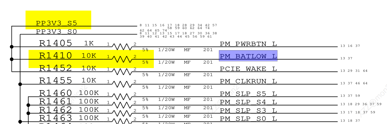

                In my schematic, there is no SMC_BATLOW_L but there is a PM_BATLOW_L.
                For PM_BATLOW_L, confirm the presence of the pull-up resistor. Confirm the high side voltage of the resistor @ R1410.

                    Test the voltage on resistor R1410 but the pin that mates with PP3V3_S5. There must be a stable voltage of 3v3 here for this signal to be parked to the logic '1' state. Easier to test both sides of R1410 for a voltage.

                      0v on both sides

                        i've made a big mistake!!! pp3v3_s5 is not present at all!!! pp3v3_s5 amref smc is present! i've made a big mistake!!! pp3v3_s5 is not present at all!!! pp3v3_s5 amref smc is present!

                                What is the voltage to ground on each side of L5001?
                                Remove all power. Measure the resistance to ground of PP3V3_S5_REG_R rail @ L7560. Something is wrong with this rail since the enable for the power rail is OK and this rail should enable.

                                  3,42 on both sides of l5001
                                  0,35k on l7560

                                    SOLVEEEED! it was a broken trace on P3V3_S5_CSN2

                                      0,35k on l7560
                                      350 ohms to ground resistance for L7560 is too low.

                                        Just saw your post - excellent!!
                                        So the current loop circuit was broken and this half of the regulator was powering OFF because it felt the voltage was being created but tanked to 0v (due to the missing loop voltage) = assumed the load was too much so power it off.
