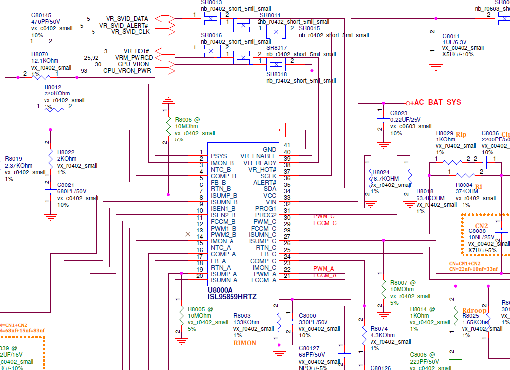

    Hi everyone
    I have a problem with this laptop that won't turn on.
    The +VCORE is not present and doing some measurements on the ISL95859 I notice this:
    VIN present 19.5V
    VCC present 5V
    VR_ENABLE present 3.3V
    PWM_A present 2.5V
    FCCM_A not present
    PWM1_B present 2.5V
    PWM2_B present 2.5V
    FCCM_B not present
    PWM_C present 0.32V
    FCCM_C present 5V
    In these conditions should the ISL95859 works and therefore enable the FCCM_A and FCCM_B pins or do I have to check other lines for it to be enabled?
    Maybe the ISL95859 is dead?
    I add the very very similar schematic
    Thank you

    Check the BIOS or if the CPU is damaged

      Sorry, but when I power on it the enable are 3.3v and when a power off the enable is 0v.
      I don't think the problem is bios and the cpu too becouse, vcore there isn't so the cpu not work

        Whether vr ready is 3.3V, CPU damage may also cause no vcore

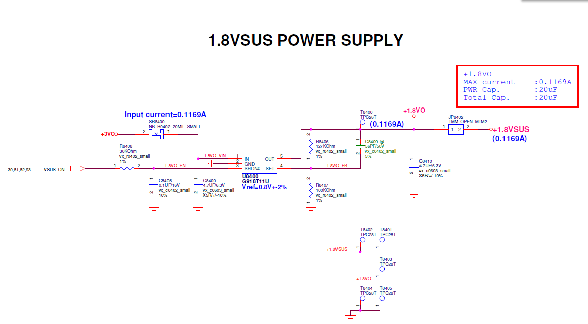

          1.8V rail is running?
            hi, if you mean 1.8VSUS, yes it's present.
            I add a photo about that.

              Yes the VR_READY is present 3.3V

                Someone can suggest me to try to replace ILS95859 or will it be useless?
