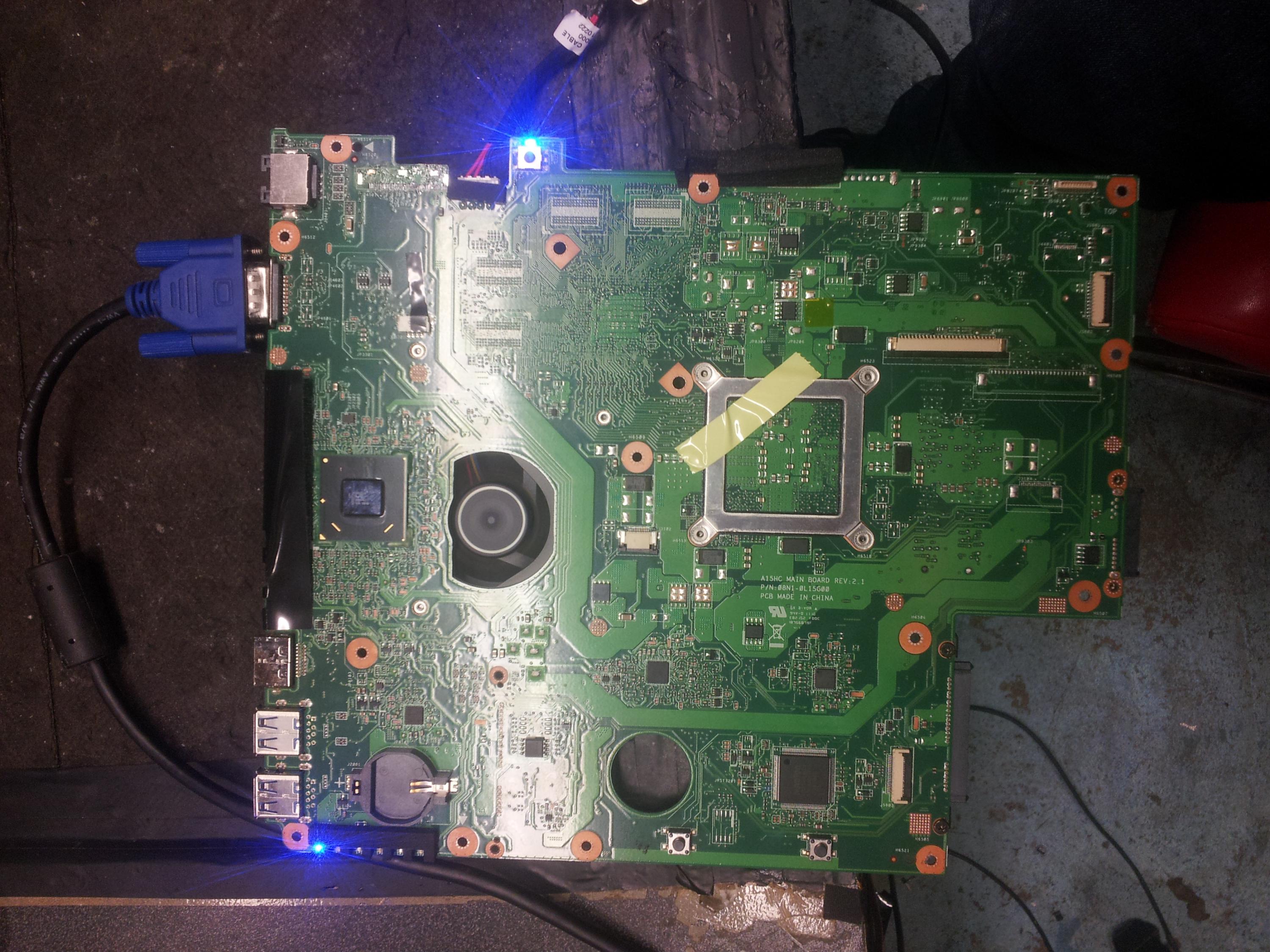

Novatech A15A
  • loser18
    • Nov 2013
    • 274
    Re: Novatech A15A
    Originally posted by dj_ricoh
    its there a pin to verify that has the same pin layout?
    Not really...You can try the pwron pin if goes low, but other pins may be different...
    • dj_ricoh
      • Jan 2013
      • 2073
      • uk
      Re: Novatech A15A
      the thing is if i connect the bios battery it does not power NADA nothing, no light.
      if i take it out it auto powers and you can shut it down from power button.
      p.s. on power button there is 3.3v and it drops when i press it with bios battery
      • loser18
        • Nov 2013
        • 274
        Re: Novatech A15A
        You need to check pwr button signal @ SIO pin...If it goes low & doesn't turn on it may be faulty...Without schematics, datasheet and power sequence it would be pain in the arse...Also your 5V alws (if it is 5V alws) power is fluctating...
        • dj_ricoh
          • Jan 2013
          • 2073
          • uk
          Re: Novatech A15A
          i found something i just need to confirm its the right file
          sry about the Post#3 i had a sony on my table and i miss write the kbc with that
          • loser18
            • Nov 2013
            • 274
            Re: Novatech A15A
            yep that's it...
            • dj_ricoh
              • Jan 2013
              • 2073
              • uk

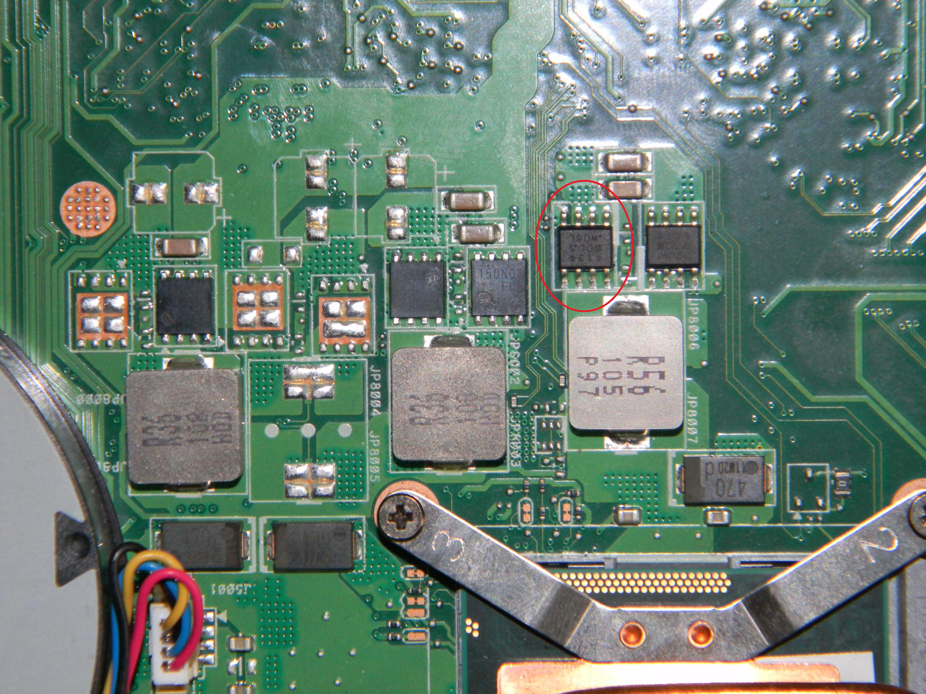

              Re: Novatech A15A
              i took that fet out and there is a short on the pads !
              BUMP! good for me there are no markings and no schematic!
              i`ll try to take the coil and found out where it goes maybe i can trace it down with some luck!
              off
              just saw a mobo on ebay . i`ll try not to buy it because i wanna learn more with this one but i`m afraid that it wont last long :-S
              • dj_ricoh
                • Jan 2013
                • 2073
                • uk
                Re: Novatech A15A
                So today i manage to power it up.
                It will not start from button only when i plug the adapter.
                It shutdown from power button but it wont power up back.
                Ofc with bios battery off
                • rock83
                  • Jun 2022
                  • turkey
                  Re: Novatech A15A
                  off
                  Do you remember how you solved this problem? Can you share it with me?
