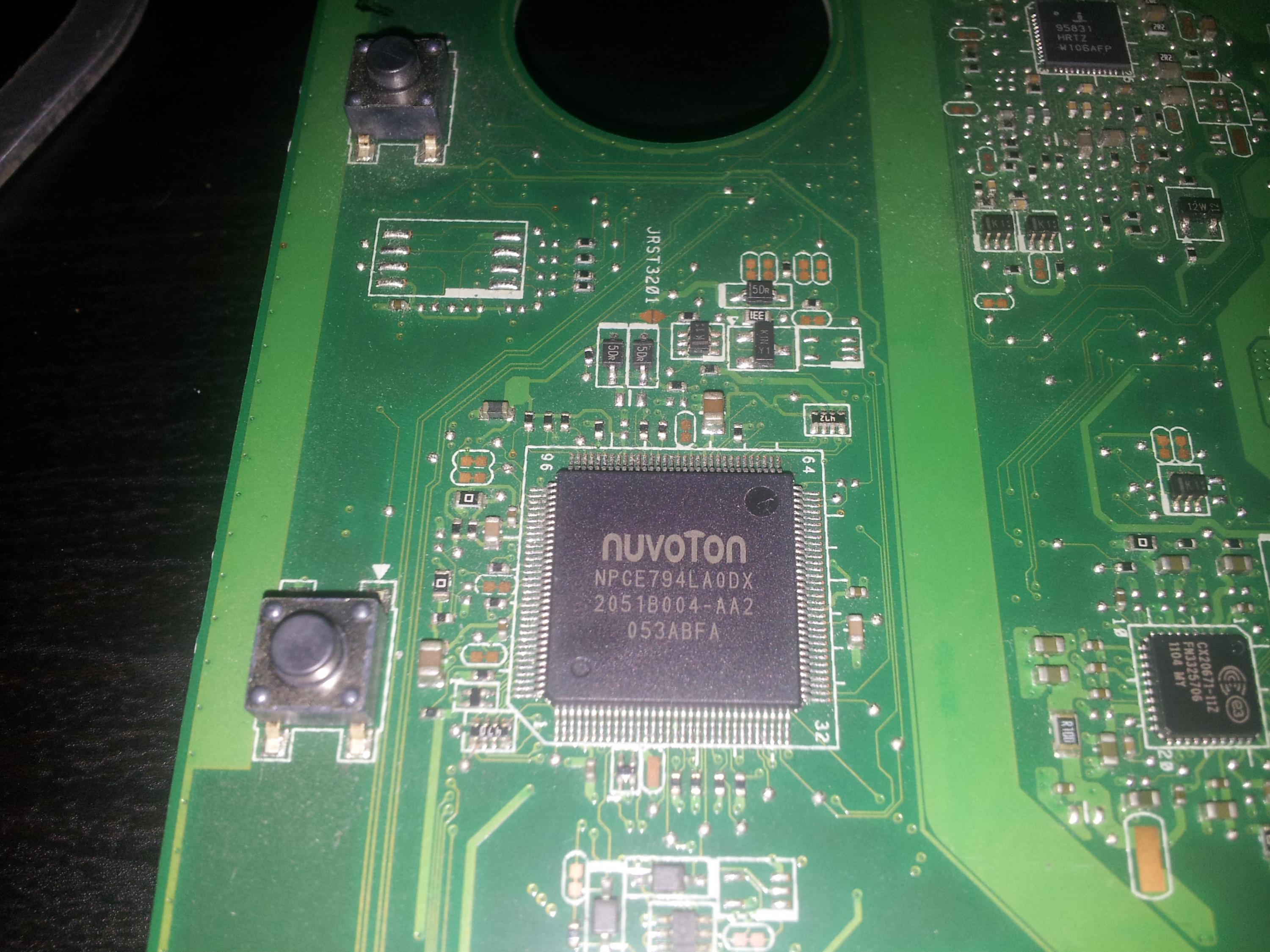

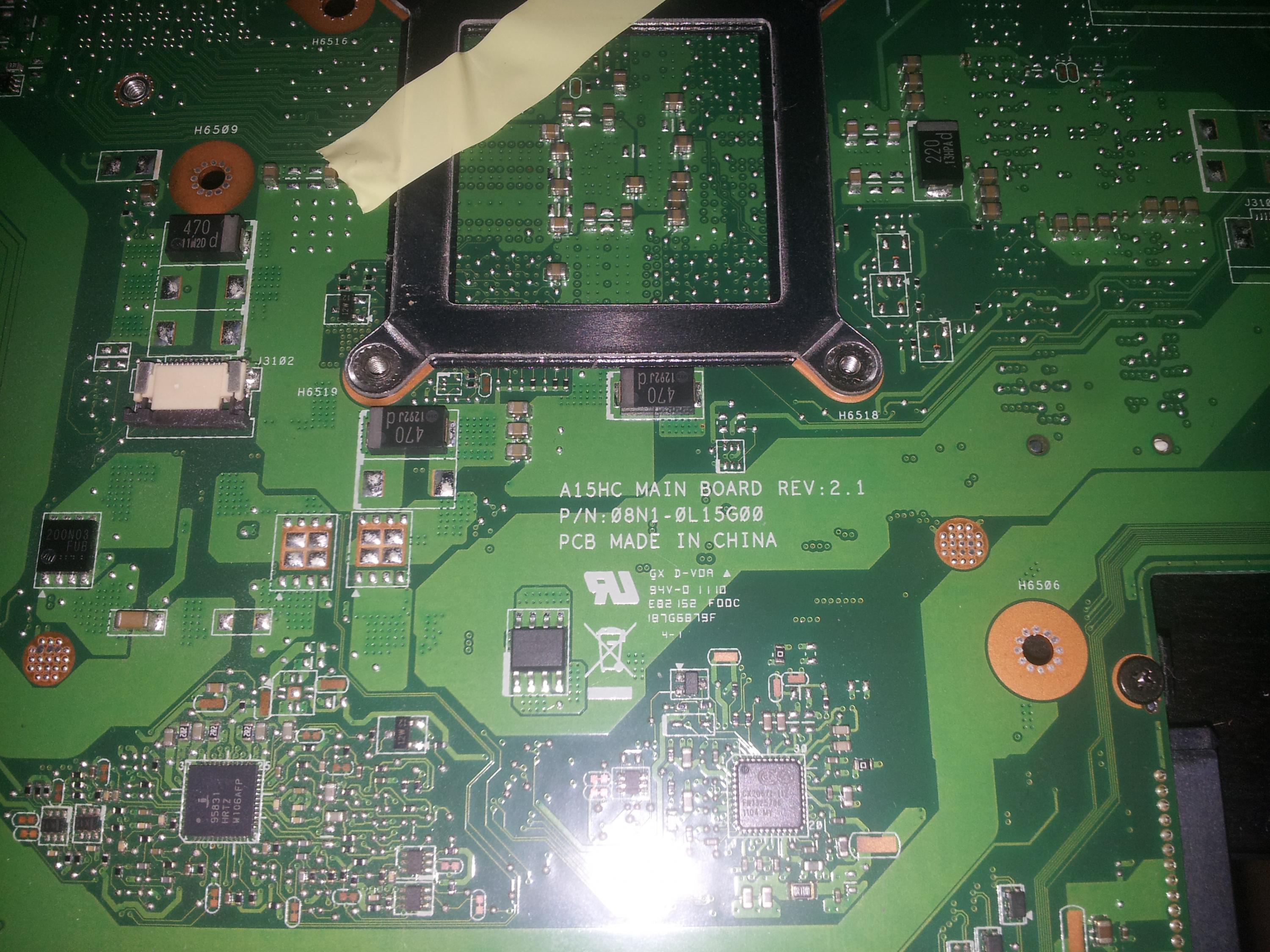

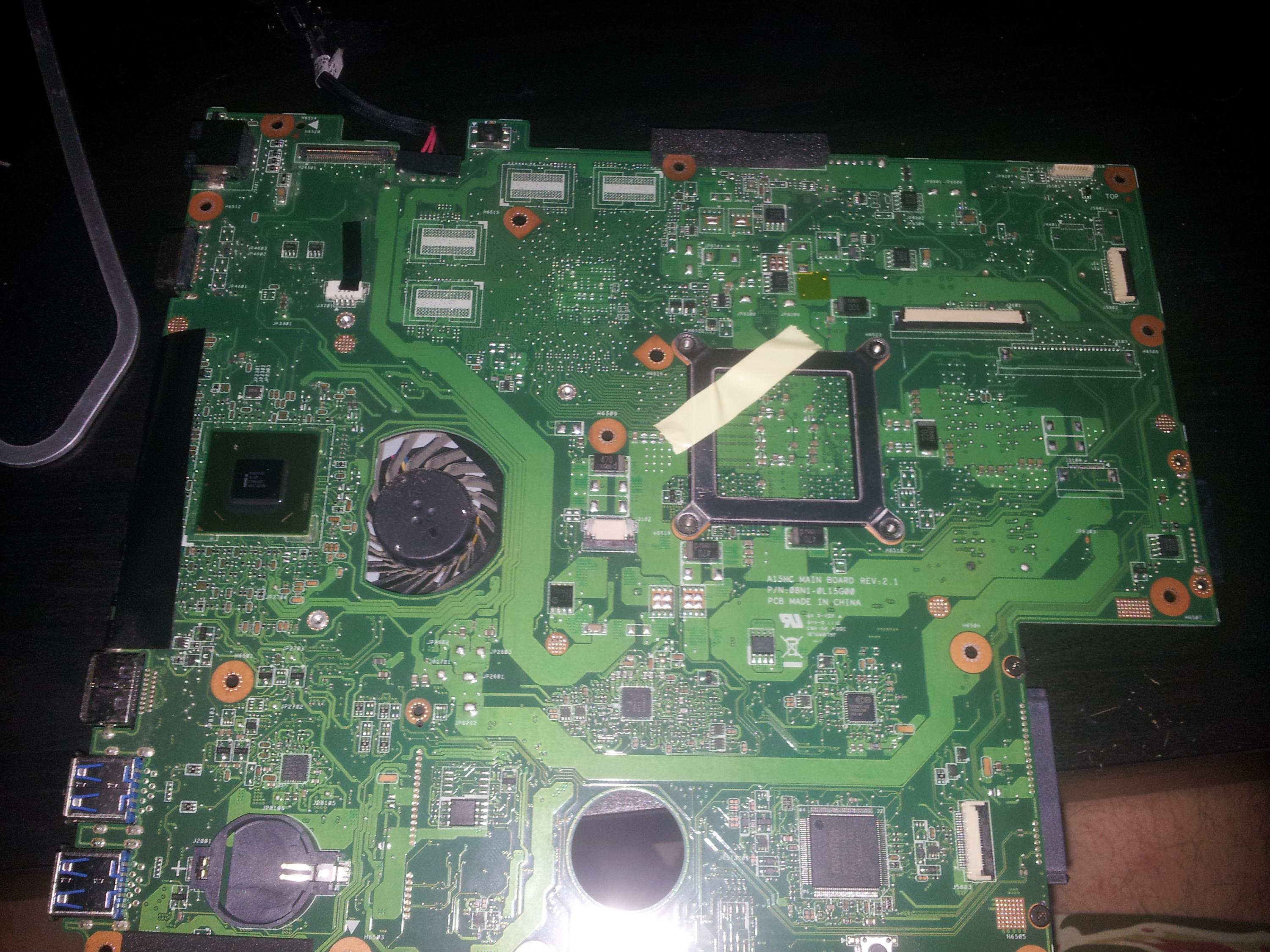

    Hello fellow technicians
    i got this notebook from somebody.
    it became mine, so i will like your brain if you can help me to solve this puzzle .
    the board code its in the picture.
    i can`t find any schematics for so if you got one please share it.
    p.s. i saw MSI uses this board to.
    let me begin .

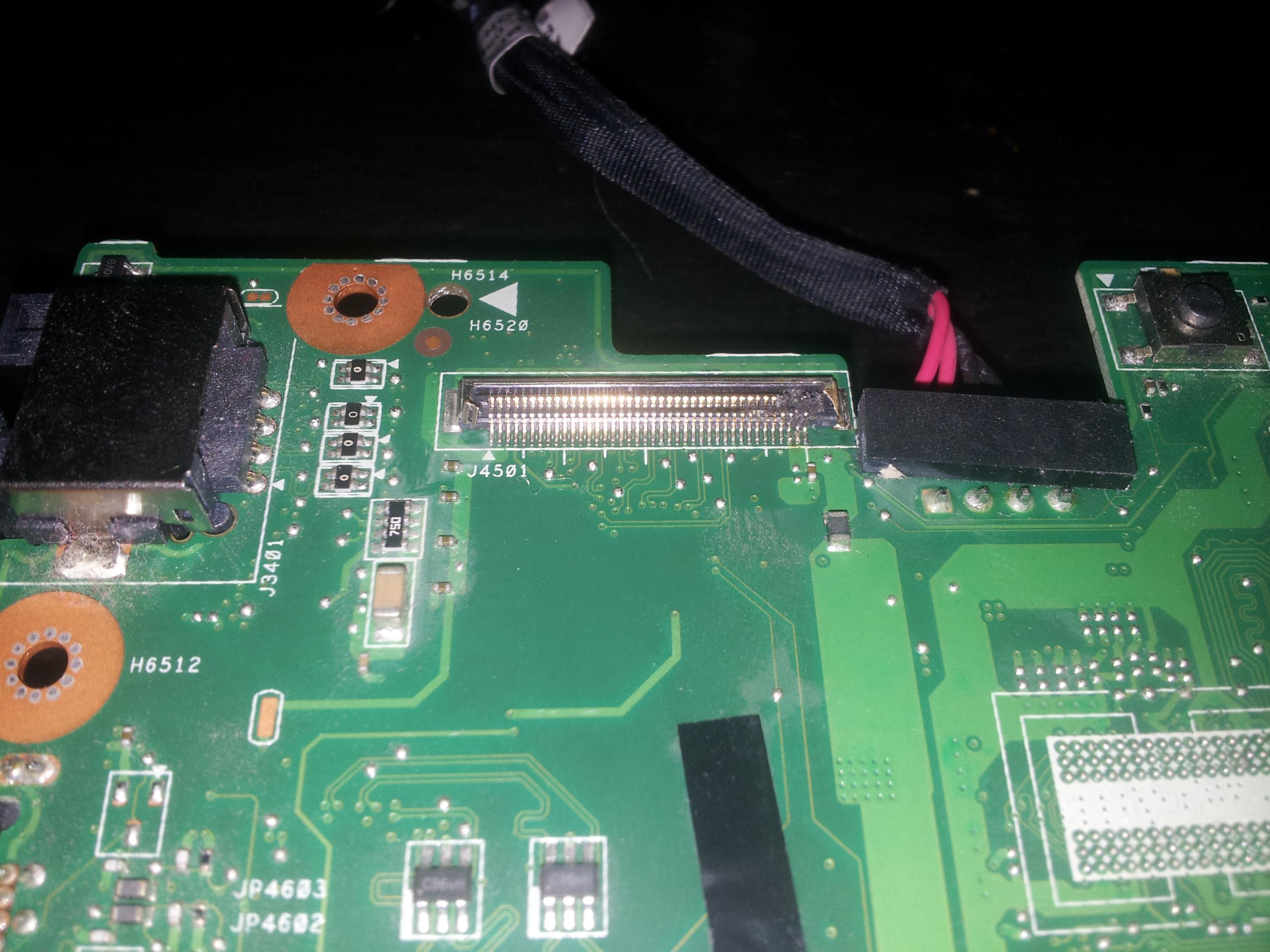

    somebody try to change the screen and ... yes they are not PROS.(connector pic)
    -there is voltage on power button and it goes down when its pressed.
    -no voltage on bios.
    -nothing its heating.
    -if i take the bios battery out and i insert the adapter its auto starting.
    I can swap the the LCD connector but i will try to fix it before.
    I never try to install ram on it but i`m 95% it will boot because i saw this case once but i did not even knew how to solder properly then.
    the Q: did you saw something like this? was the kbc bad?
    thank you

    anyone can help me with some info where i can find some data for this npce783la0dx?
    maybe i can find some data in another schematic.

      Re: Novatech A15A
      the only think i found its that NPCE781LA0DX can be replace with NPCE783LA0DX(mine)
      and NPCE781LA0DX can be found in Quanta ZQ1 Acer Aspire motherboard.
      Here
      it shuts down the board if i press power button but it does not power it back.
      that`s what i need

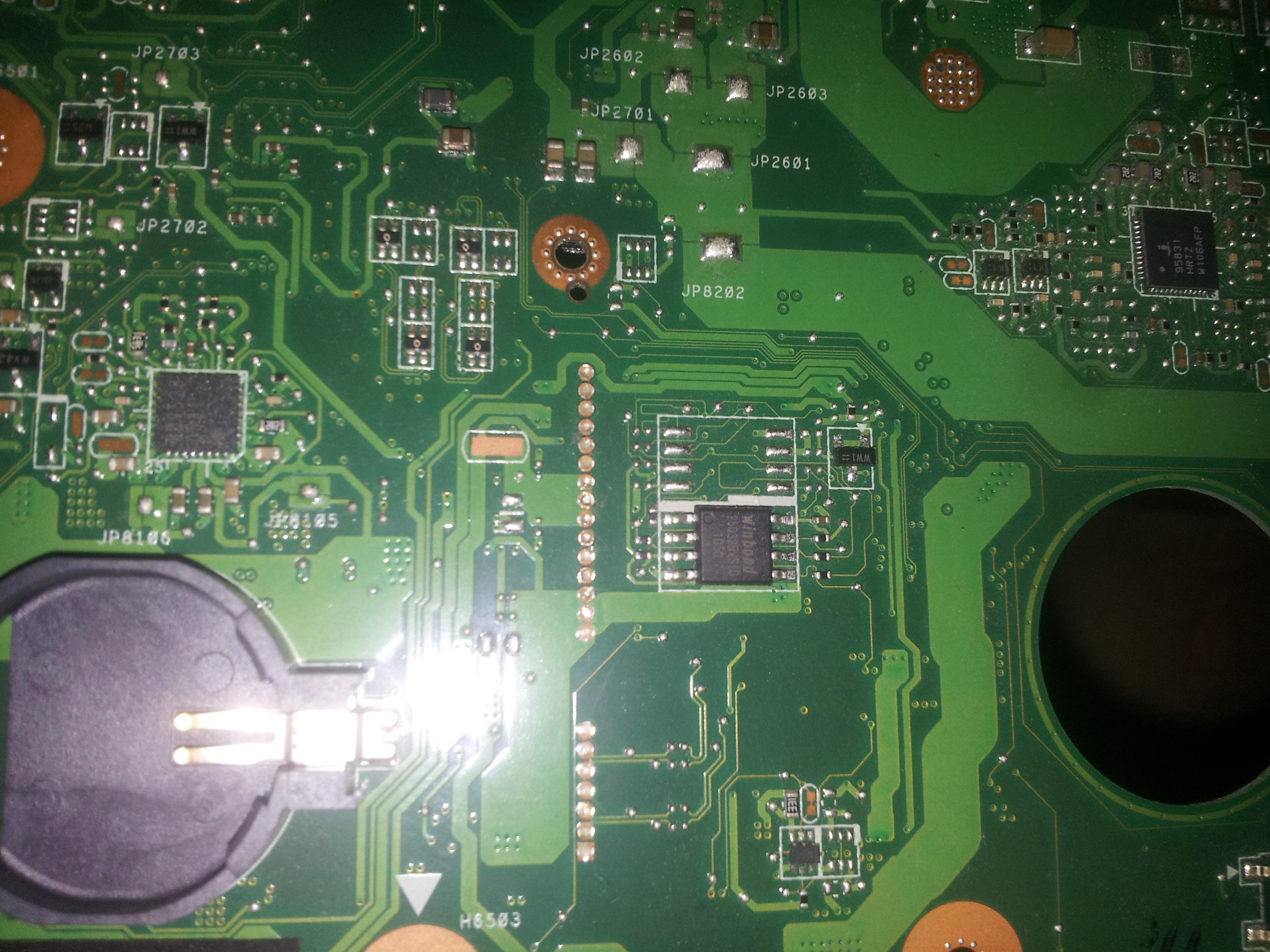

        i install a memory on the board and the BD82HM65 and the Memory(ddr3) are super heating up.
        yes the memory in the slot!
        dammm! there is no display

          i just saw now why its hard to find a schematic for this board!
          there are no marking on the board! 0 marking only jumpers
          • loser18
            • Nov 2013
            • 274
            Re: Novatech A15A
            That's why you need boardview as well...it's pegatron mobo & I doubt you'll find any...I couldn't even find a schematic...Did you check resistance @ all coils?
            And remove that fucked up connector before you power it up...
              yes! I will take that socket out and not power until then.

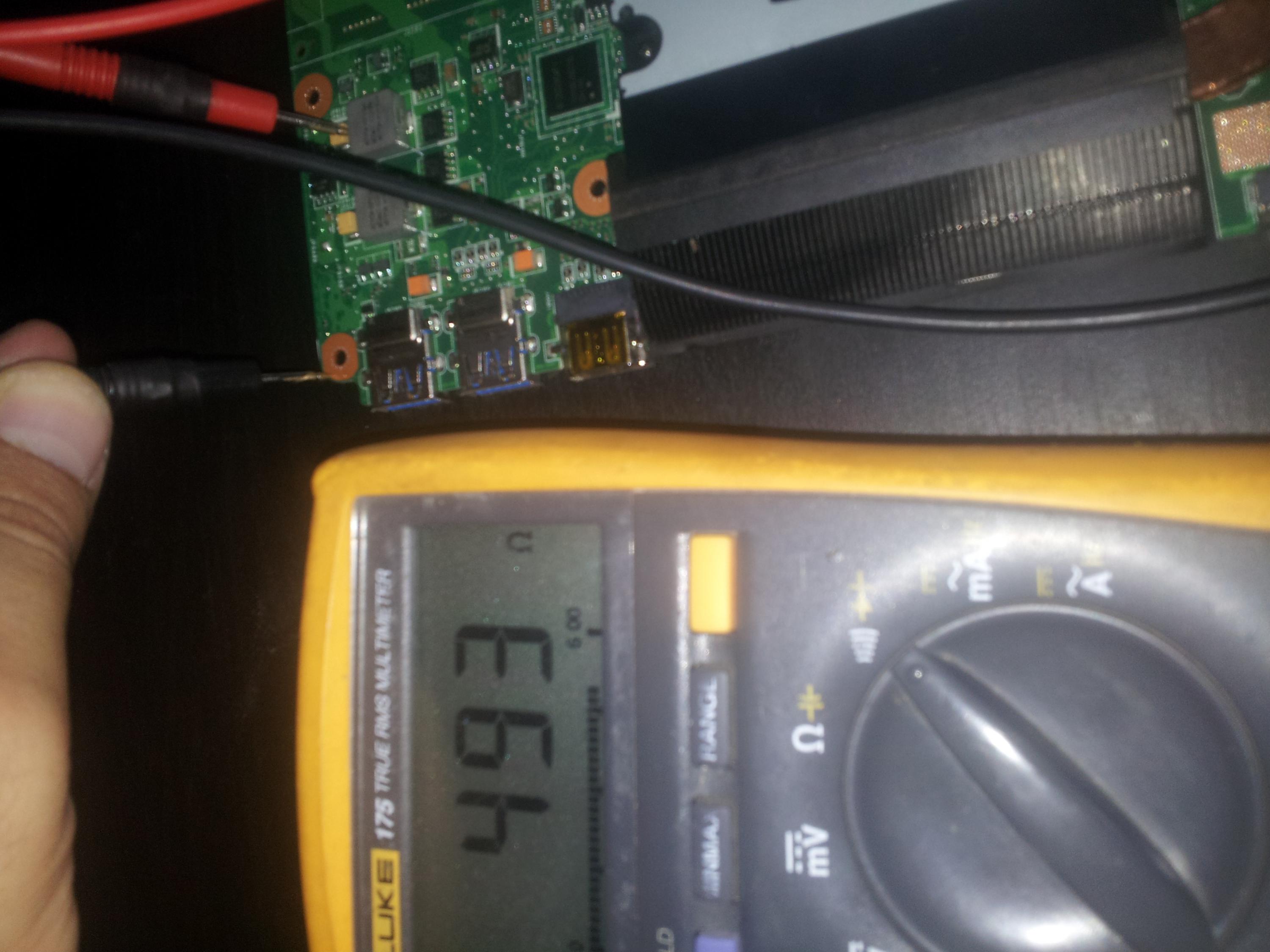

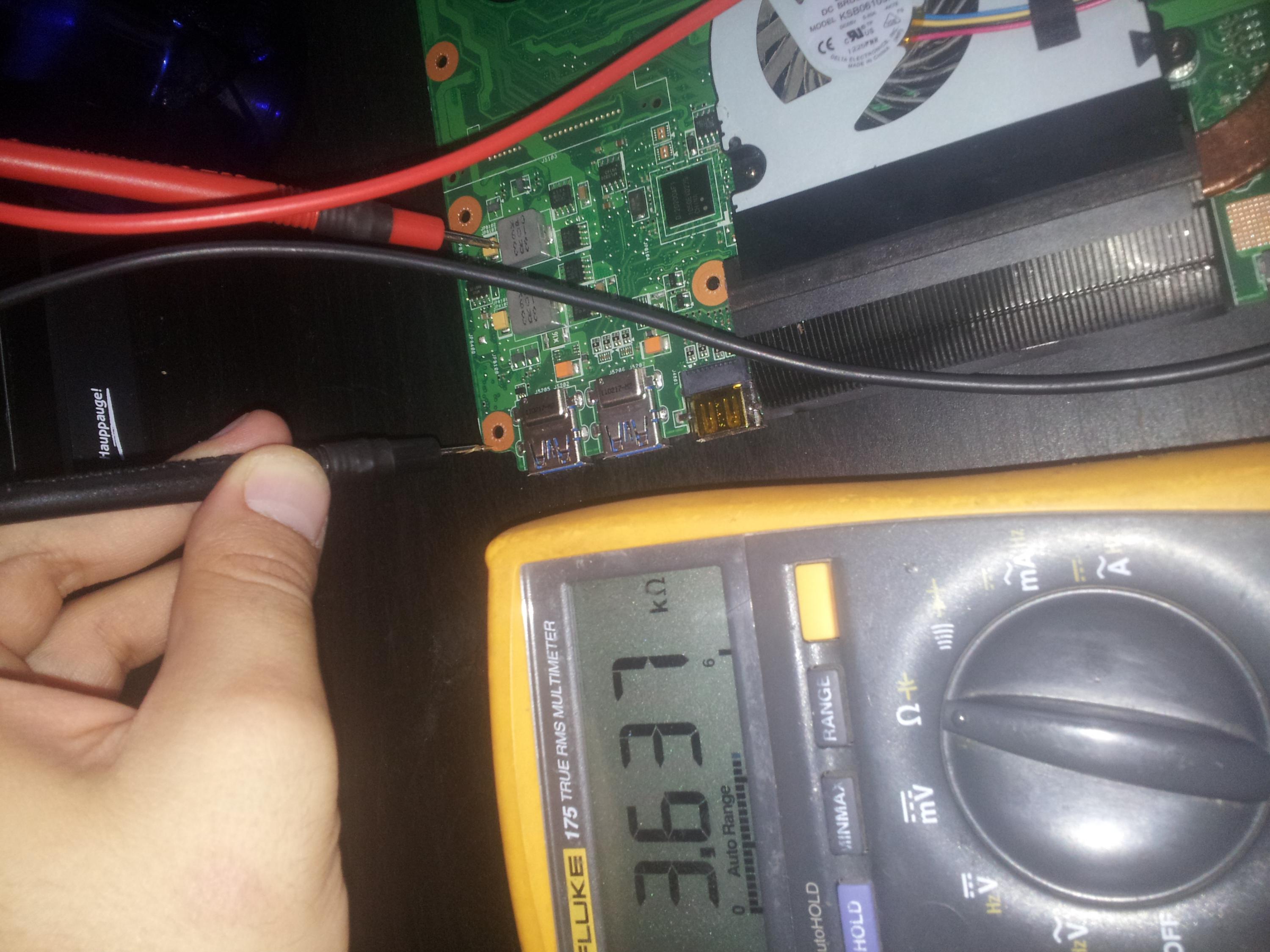

                  i check they all 14Ohms and 2 with 18Ohms and 2 with 2-5kOhms.
                  brb i`ll check the voltage

                    Those with 14 & 18 ohms indicates short somewhere...think that's too low, mate...But check voltages anyway...

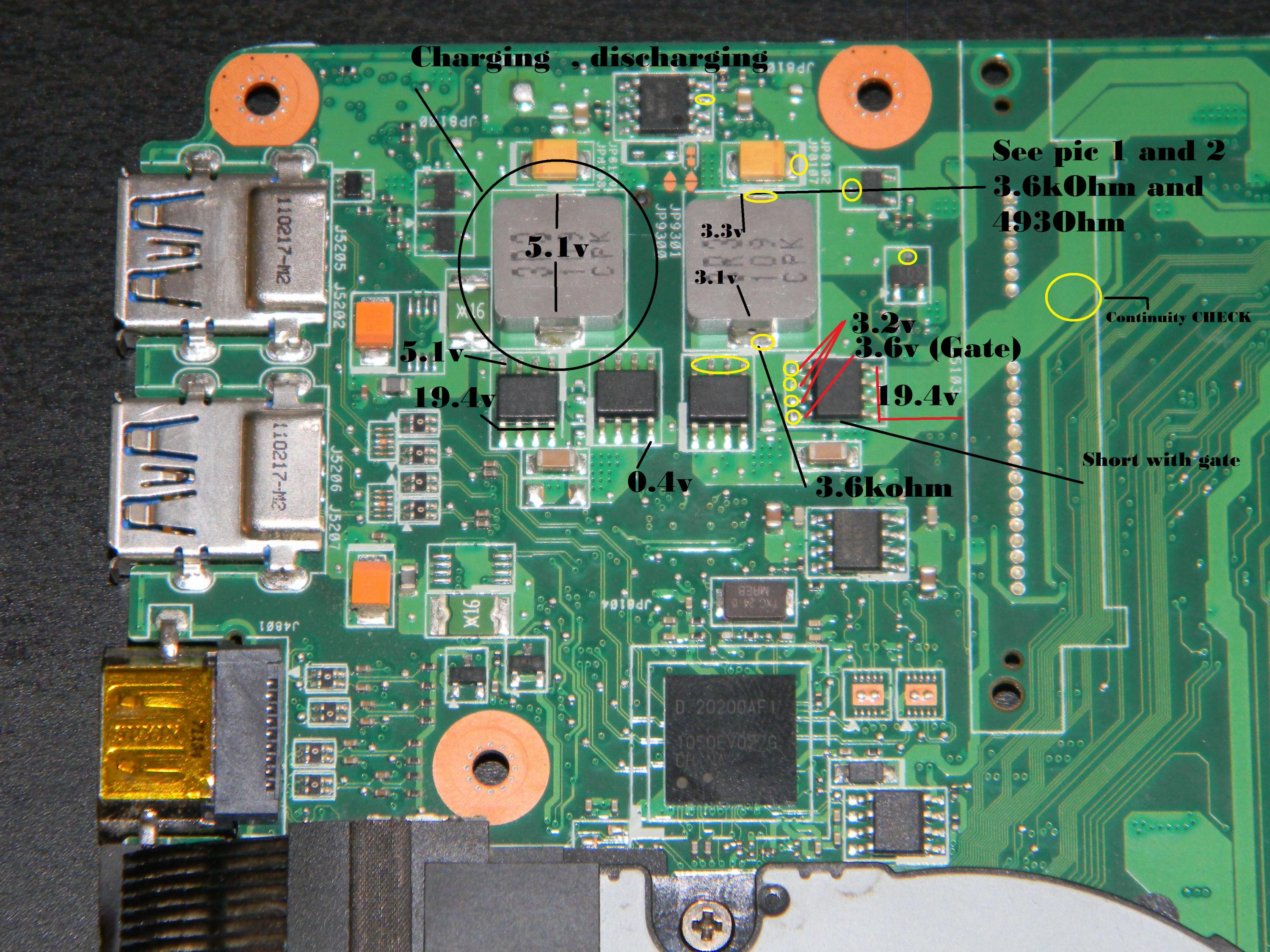

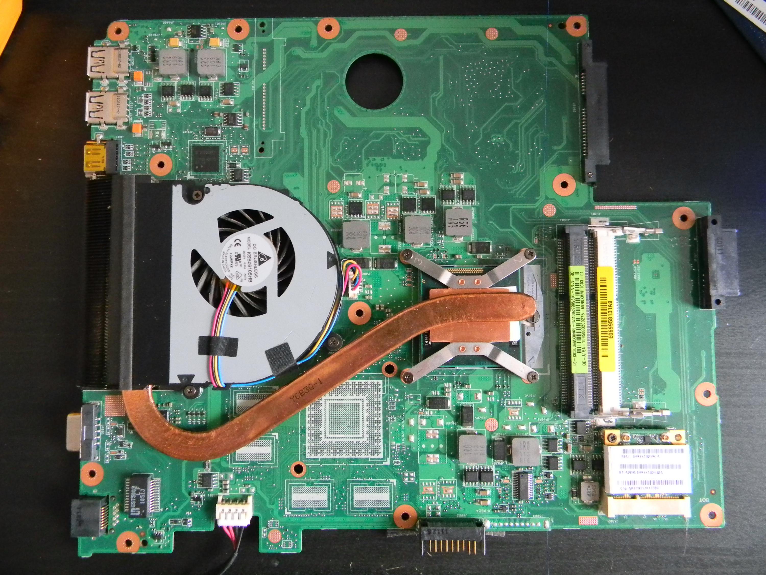

                      i`ll try to do a MACRO pic so i can map the board ohms voltage and how the trace go

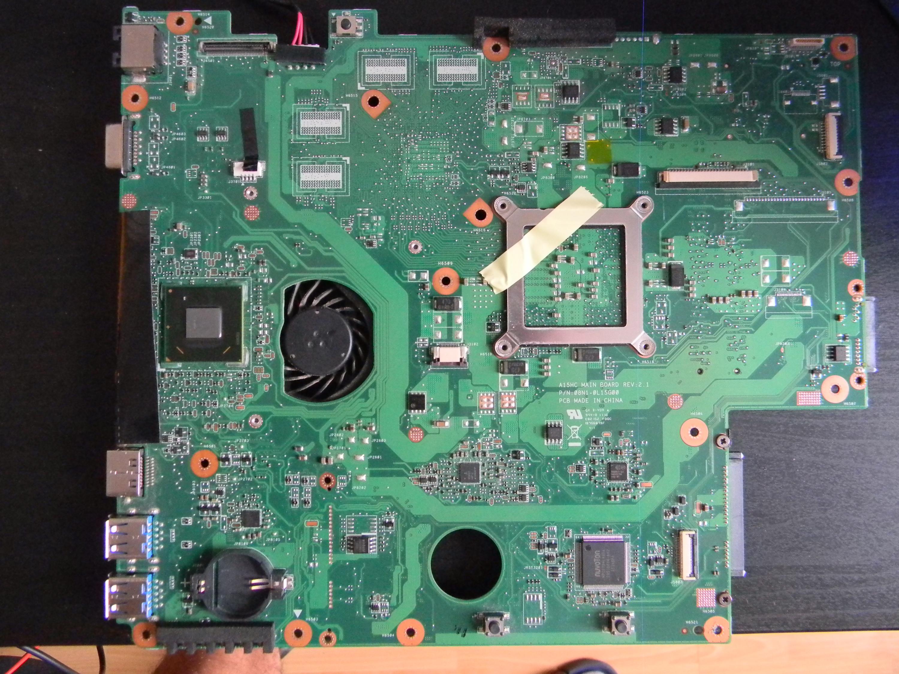

                                  ok got the generic pictures.
                                  brb i`m probing
                                  • loser18
                                    • Nov 2013
                                    • 274
                                    Re: Novatech A15A
                                    Can't even find SIO datasheet...
                                    Found schematic of Acer 7250 with NPCE795LA0DX...
                                    The weird thing is that hardware spec & config sheet says there's 794...Maybe the pinout is the same...
                                    & post those voltages...

                                      that fet in the picture with short i`ll take it out tomorrow so i can see if there is short on pad or fet
