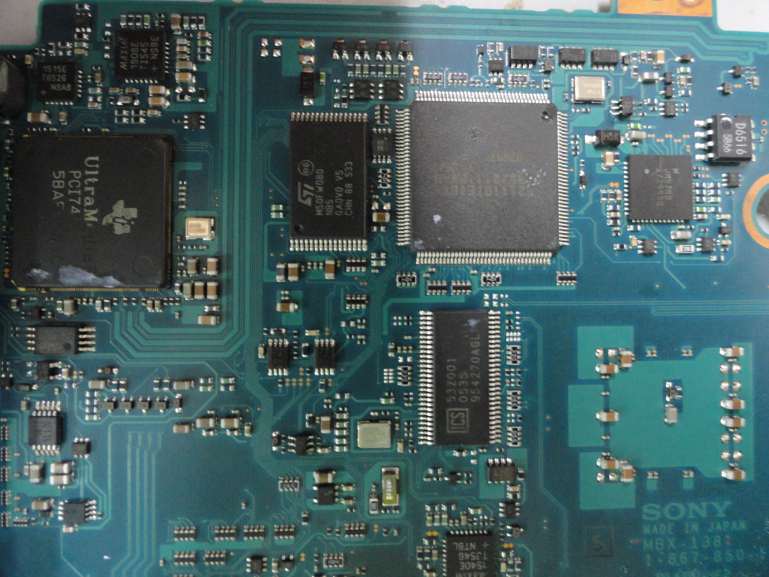

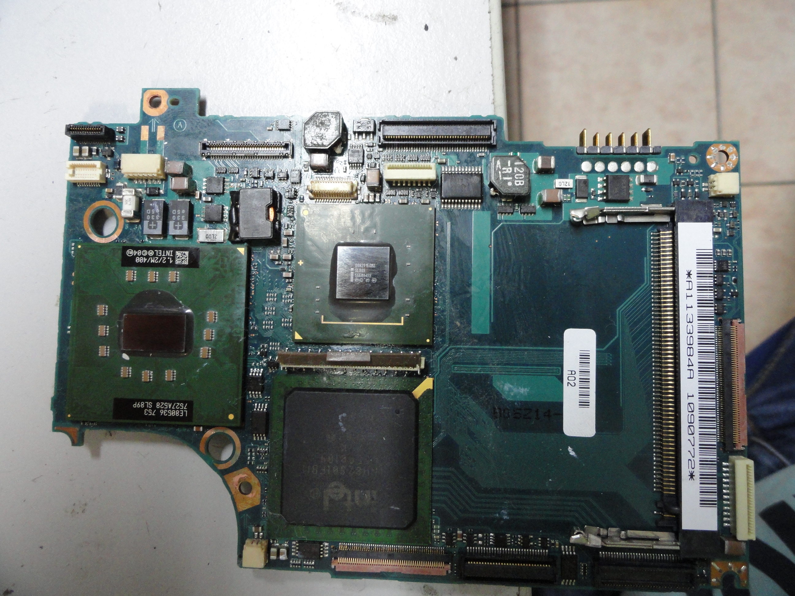

    Hello everybody,
    I wanted your help on this one. Laptop posts OK. It can't boot into operating system. After VAIO logo I have black picture and it stucks there. If I try to boot from an installation disc (tried windowsXP various discs, acronis bootdisc and others known to be working) I can hear the drive starting to read and on XP installation it stucks again after the very first screen that says windows is checking your hardware setup. I have already tried without the peripherals connected just the necessary ones (CPU, Intel GMA and 512mb Ram soldered into mainboard) and still the same.
    Does anybody have any schematic for this one? I am starting to think that there is a corruption into BIOS?
    Have also tried new hdd.(1.8").
    Re: VGN-TX1XP Strange problem

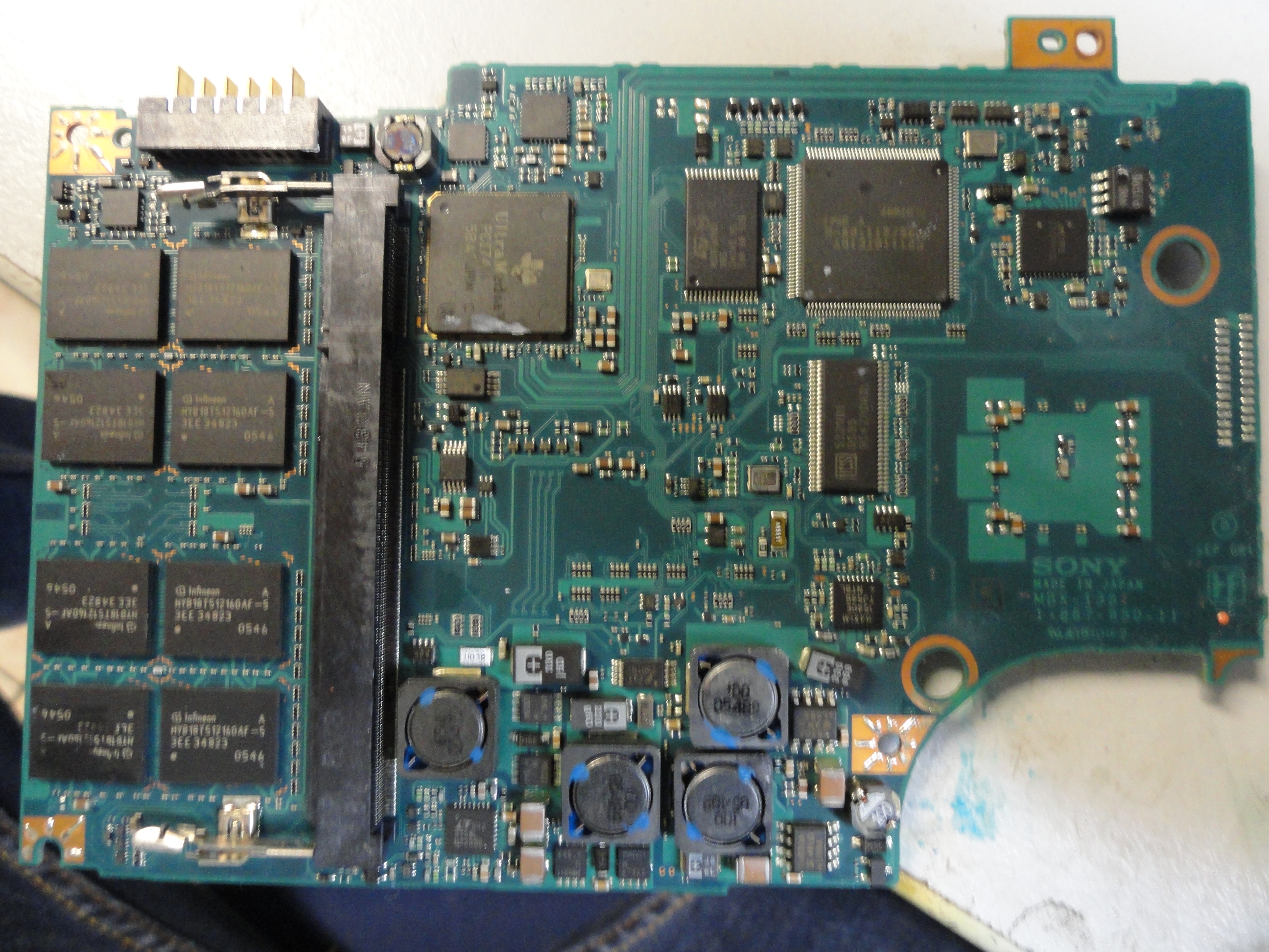

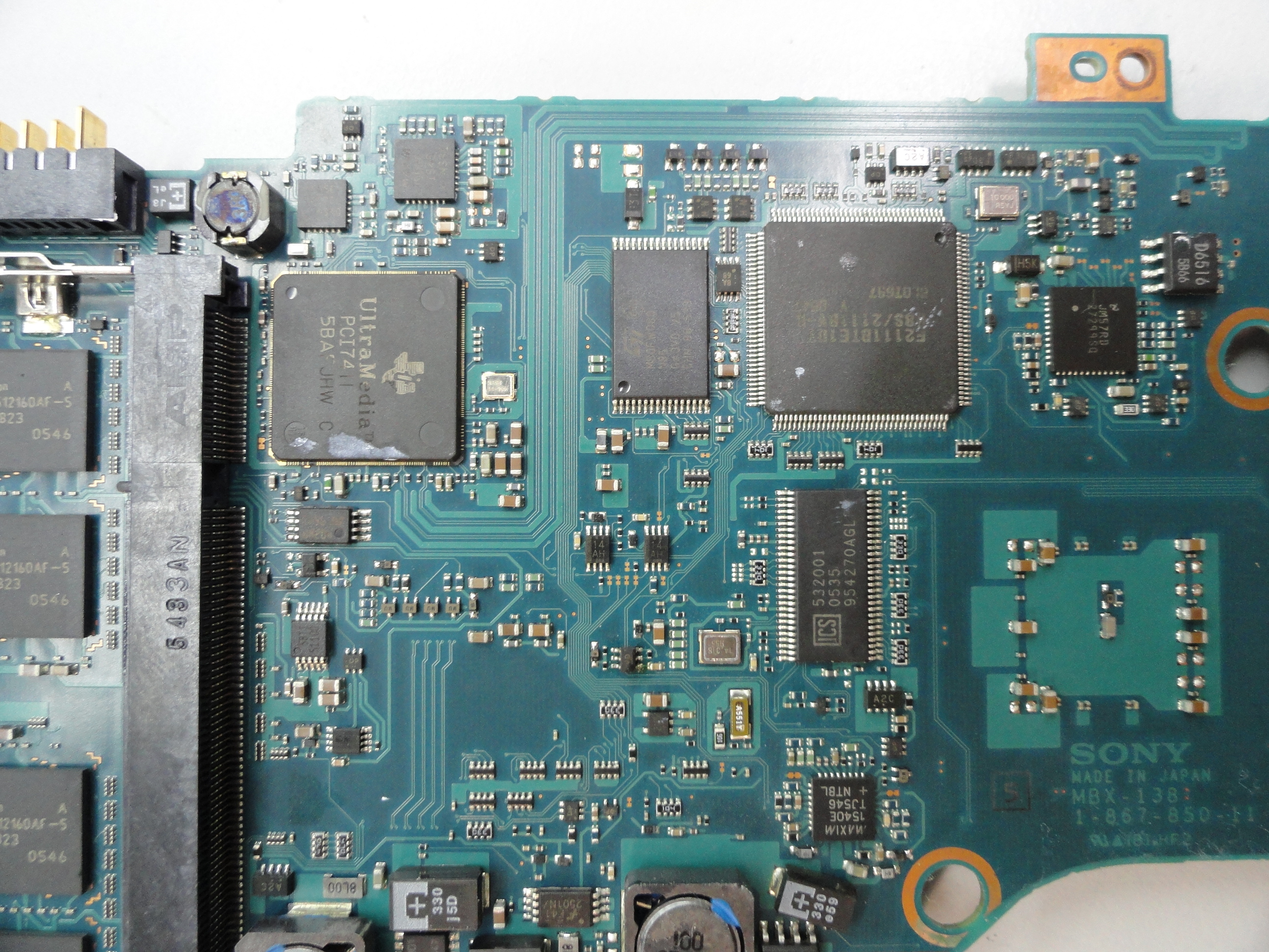

    Well I think that the problem is bios related.
    Can you please tell me which is the bios chip?
    I don't think it is the classic 8 pins chip. I believe it is the 24 pins next to the chipset (TPS22208 is written on it)
      try another pic and dont move it
      the second pic
        Better ?

            It's the ST M50FW080
              Thanks a lot atsio. Got to get one adaptor to reprogram it .
