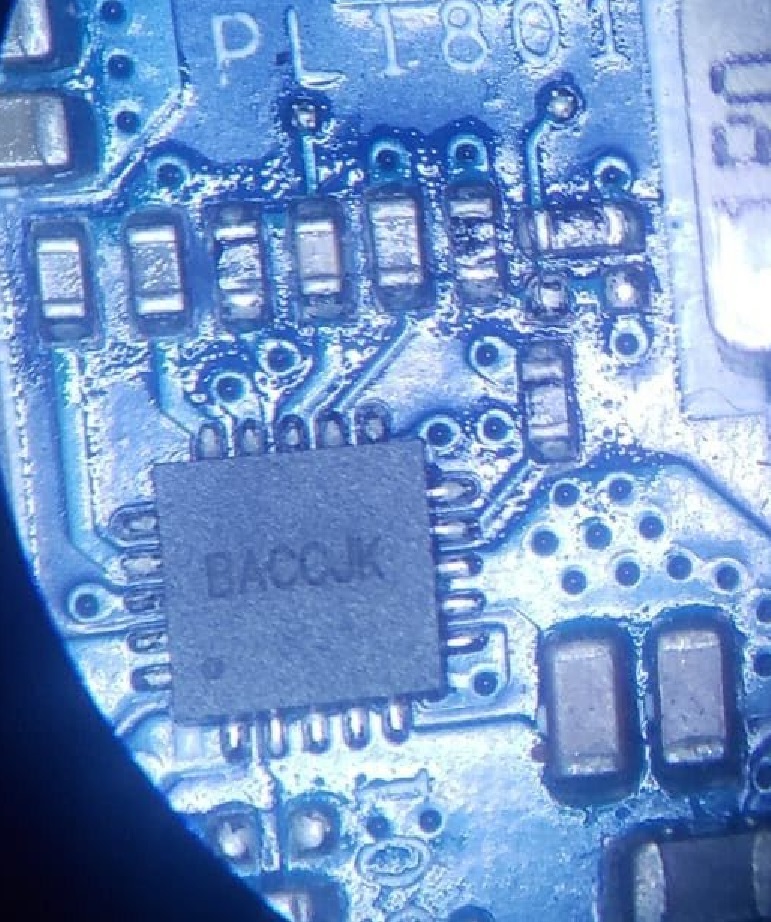

    Part Identification please.
    Hello all would any one know what IC this is please. what do I search for if needed a new one, BACCJK brings up nothing in a search, Thank you.
  • mon2
    • Dec 2019
    • 14344
    Search for 'Silergy BAC' as the rest are datecodes and are no care values.
    Part # SY8288CRAC
    https://cnlselectronics.co.uk/power-...y8288c-sy8288/
    Note: The suffix on the part is important for your replacement.
