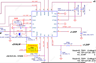

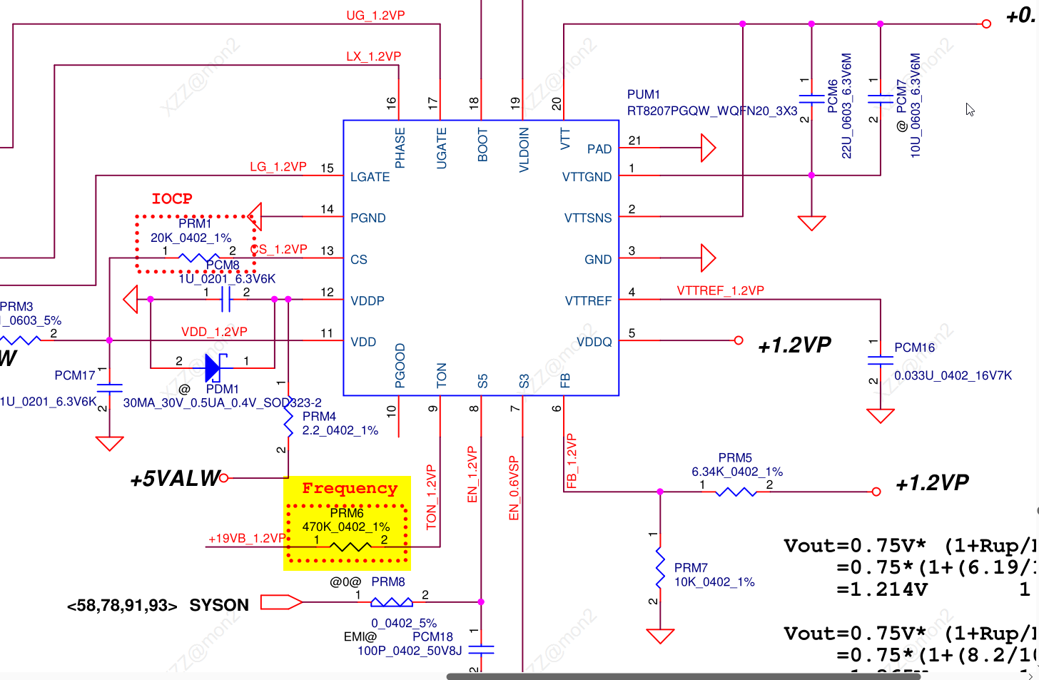

    Hi !
    I would need some help in part identification , on a GH53G-LA-L191P motherboard , i have downloaded a boardview file from here for LA-L191P there are some difference but essentialy its the same on this file it shows prm6 i would like to know the value of that resistor i think.
    Thank you !

    Attached.

      Damn that was fast, thank you very kind sir!

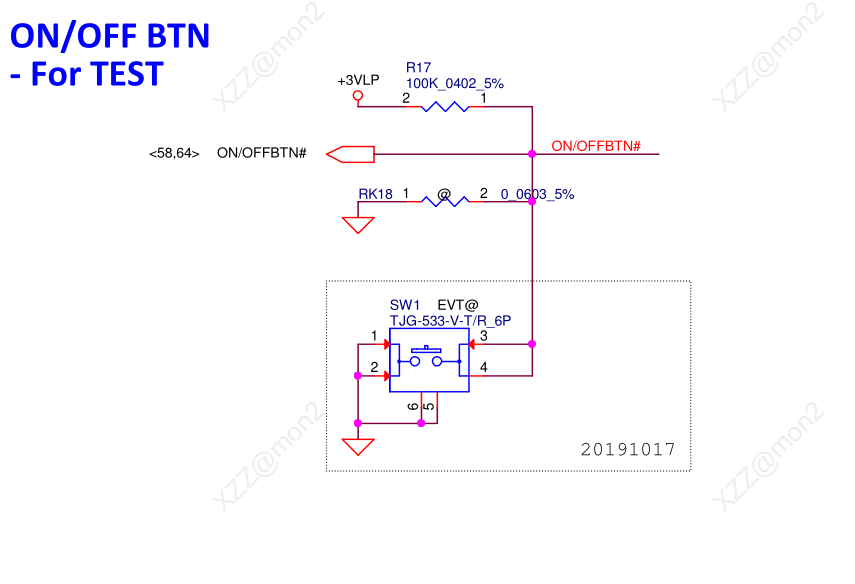

        Hi i need a little help with this laptop i have changed the resistor , before that the laptop the laptop had lights on the keyboard upon powering but no fans was spinning and there was no picture, now it wont turn on and if i plug the cable in something is ticking very silently above the cpu.
        20volts are prenesent on the board but after PQB1 the 20 volt are gone, maybe PQB1 only starts after powered up?
        How can i start this laptop without a power button?
        I would appreciate every tip what should i look for what to measure .
        Thank you !

          Locate the attached part of the circuit. Note that the netname (label) has the '#' suffix = means this is an active LOW signal. So if you make this line low (ie. ground the signal line), the board will treat this as an ON/OFF action to lower the board.
          Take a piece of wire and connect one side to ground (metal shield is ok / USB metal clamshell, etc.) and the other side to this signal line. If you see a pushbutton then this will of course offer the same result as the wire.

            Thanks For everything but the problem solved it self i was cheking for voltages and suddenly pqm1 is blown , now i think its beyond repair because the board almost burned throught.
            Could it be that because of the liqiud something internaly shorted on the motherboard? Because i have measured pqm1 before and it seemed fine also i pluged the cable in and out for like 10 times and nothing happend then suddenly it smoked out.
