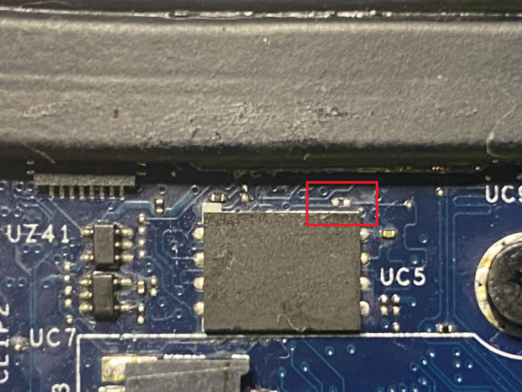

            Hi, remove heatsink, clean mobo with IPA and post picture of Bios area. How much heat did you use? Any short under wifi module, its close to bios chip.

              I removed the heat sink and these was a capacitor which got blown away from near to Bios chip, i soldered it back looking at old pictures to confirm where it should be. Now the laptop is booting fine.

                Can you please point the blown cap location please?
                • vidvansh
                  • Mar 2025
                  • 18
                  Black color capacitor got blown away from here which was stuck under the heat sink. I soldered it back and it worked.

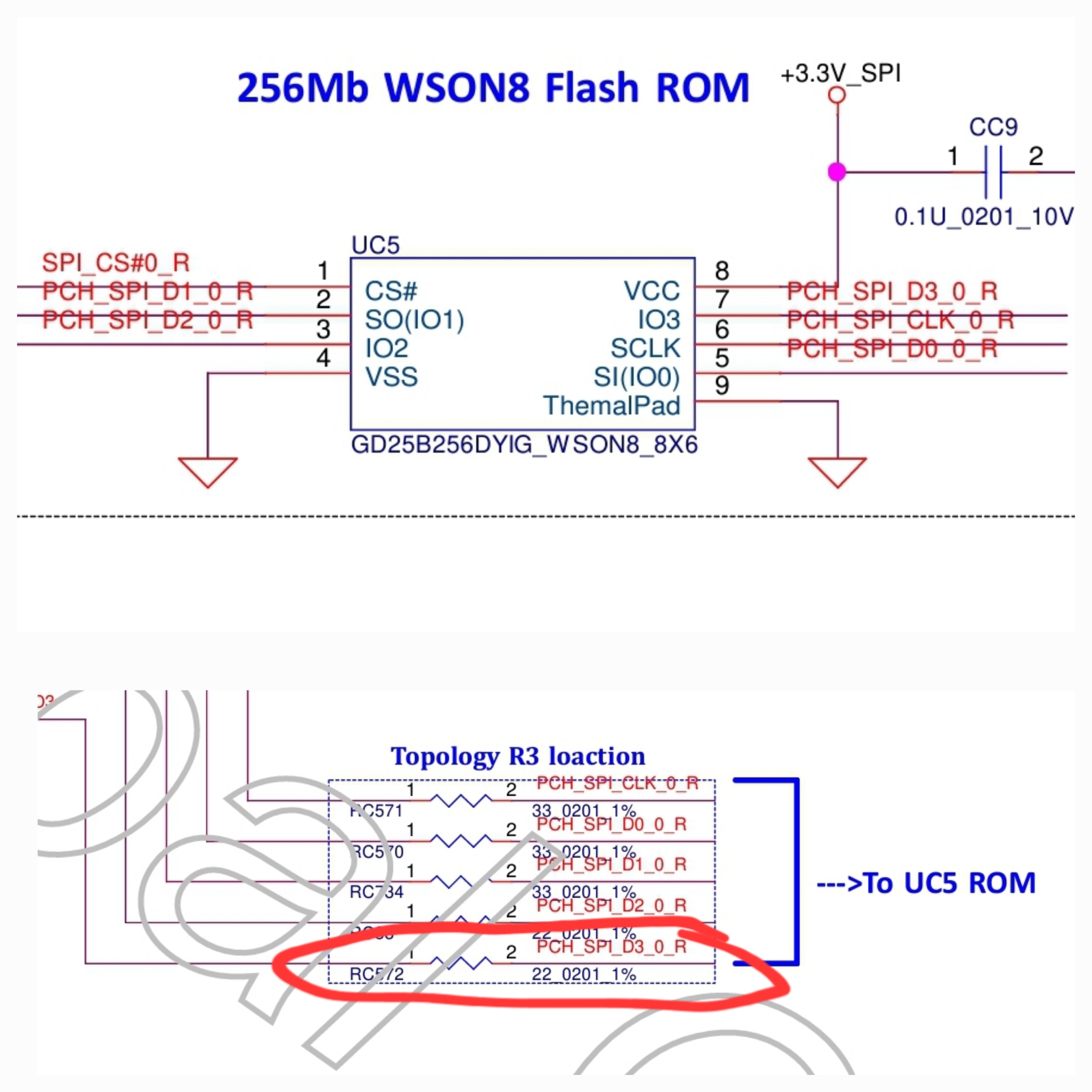

                  Can anyone help me identify what part it is called so that i can order some as i have one dell latitude 5400 where 1-2 capacitors are blown while removing bios chip and i cannot find them on the motherboard.
                  • Sephir0th
                    • Oct 2020
                    • 1260
                    #29
                    Compatible schematics was shared with Post #2 on Page 1. It is a 22 Ohms resistor.
