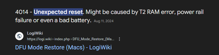

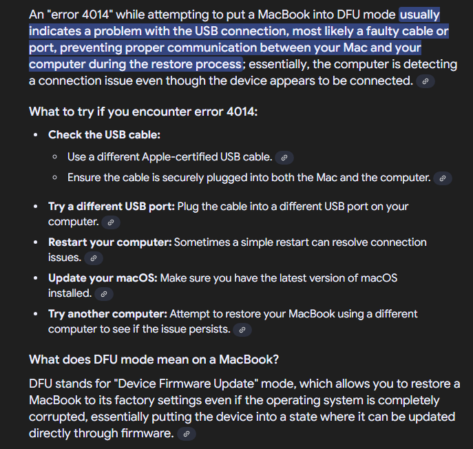

                                reflashing t2 rom with a dump from internet, i'm again in dfu, but it doesn't switch to 20v.
                                i'v tried revive and restore, but still error 4014.....
                                maybe it's normal that it is in dfu mode with "Non original" firmware and consequence is that it doesn't switch to 20v and MUST BE RESTORED...but restoring i have error 4014 (t2?!)
                                otherwise with original firmware it switch to 20 v because MAYBE i've fixed all main power supplies but that i have other problem (t2 that become hot?)
                                i wouldnìt like to give up...
                                is it possible that the solder blob between pin 1 of u4770 and pin 1 of c7920 has damaged t2???!??!?!?!
                                i'm very scared

                                  Monitor the spi lines for activity on the T2 ROM. The T2 is the SPI bus master so activity on these lines will confirm that the T2 is trying to boot.
                                  Yes, the board will be in DFU mode after ROM flashing. Watch the YT video by master Liu on the U-Bos2 tool. He does exactly the same.

                                        With Rom from Internet I have 5v with stable voltages , machine recognized in dfu and error 4014 at the beginning of the restore
                                        And this behaviour under thermal camera
                                        [URL unfurl="true"]https://www.dropbox.com/scl/fi/ik7cyevfxhhpqys09w6de/Video-05-01-25-17-05-19.mov?rlkey=yezd24vzetcua8qinvebq7l58&st=lyg5ct1b&dl=0[/URL]
                                        • mon2
                                          • Dec 2019
                                          • 14713
                                          #140
                                          Try another known good cable for the DFU. We use USB 4 type C cables.
