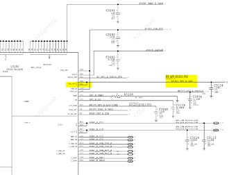

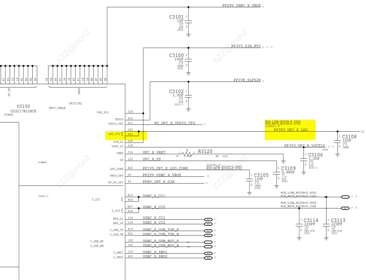

                                    • mon2
                                      • Dec 2019
                                      • 14713
                                      #38
                                      Similar logic flow in debugging.
                                      Search for 'LDO_3V3' and this should land onto the CD3217 balls that create this rail. Be sure to test each USB-C connector to test each ACE controller.
                                      • phantomEVO
                                        • Mar 2013
                                        • 509
                                        #39
                                        on u3200
                                        PP3V3_G3H_RTC 3,3v
                                        PP3V3_UPC_X_LDO 3,3v
                                        PP1V5_UPC_X_LDO_CORE 1,5v
                                        on u3100 all are 0v
