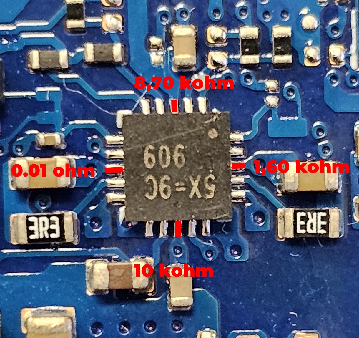

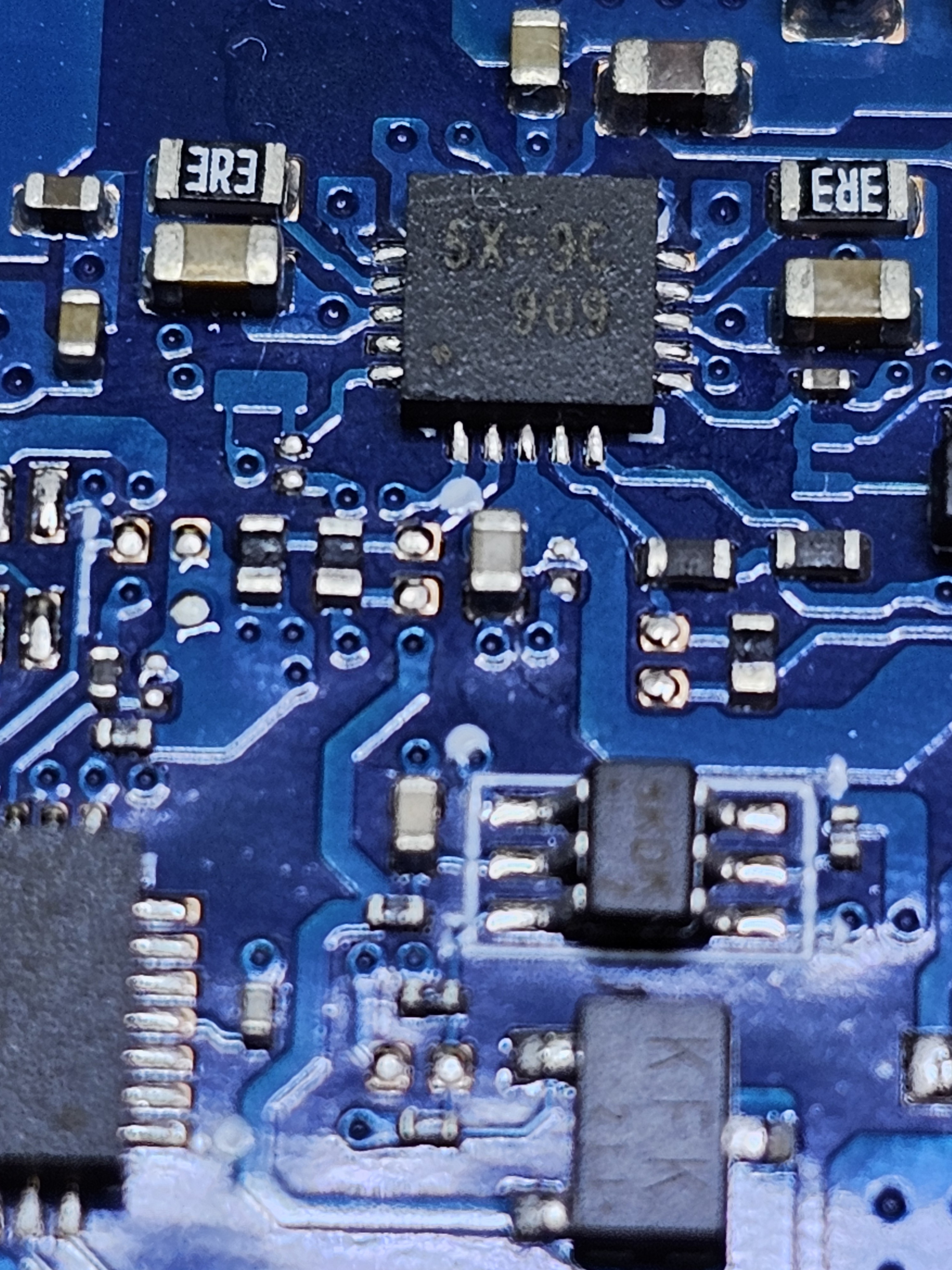

    I am looking for this component please : the mark is 5X = 9C 909
    The PC is a TUF517Z and the fault is: no boot.
    The charge seems ok although the orange light sometimes starts flashing but no boot.
    This happened after an object fell on it.
    I put the CM under a thermal camera and this famous component directly rises in temperature. So I assume that it is responsible for something.
    Do you have any idea what it could be please?
    Thank you.​

    RT6575DGQW
    Measure resistance to GND on pin3 and 13 of this IC without any power source attached.

      RT6575DGQW
      Thank you.
      Here are results :
      Pin 3 : 8.7 kohm
      Pin 13 : 10 kohm
      I followed the datasheet to find the pins, at least, the direction to read them. If I'm not mistaken, they are in the "counter-clockwise" direction but if I reversed it, then here is the result:
      Pin 3 : 1.60 kohm
      Pin 13 : 0.01 ohm.
      To be as clear as possible (I apologize for my low level of knowledge), I add to the message a photo with the measurements indicated according to the pins.
      Thanks again.​

        Yes, to be measured and counting in the counter clockwise direction. Dot is pin #1 and will be to the left of this marking.

          Ok, i knew for the dot but not the side
          So , pin 3 is 1.60kohm and 13 : 0.01ohm.
          Thanks for sharing your knowledges and your help.
