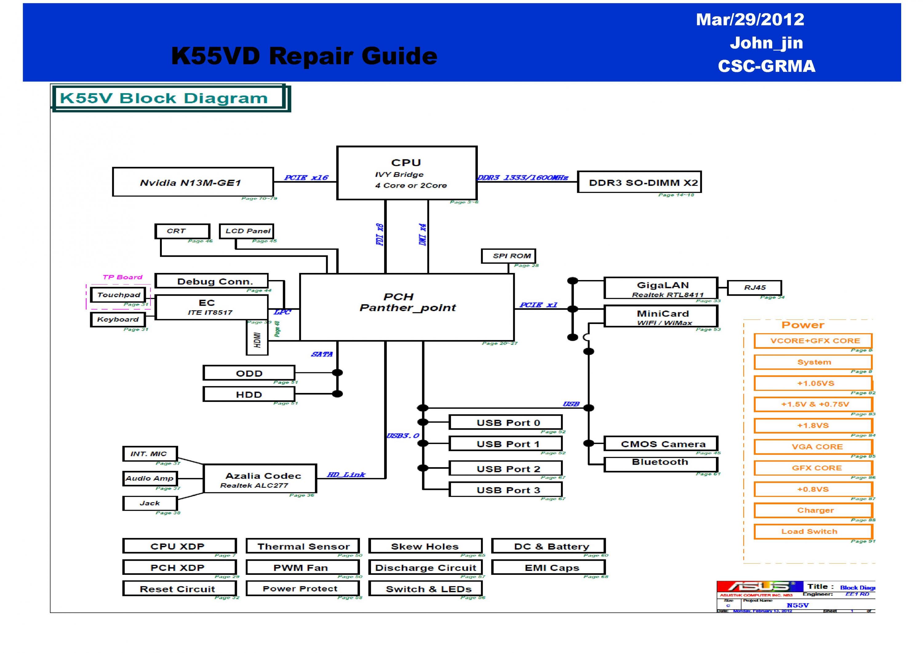

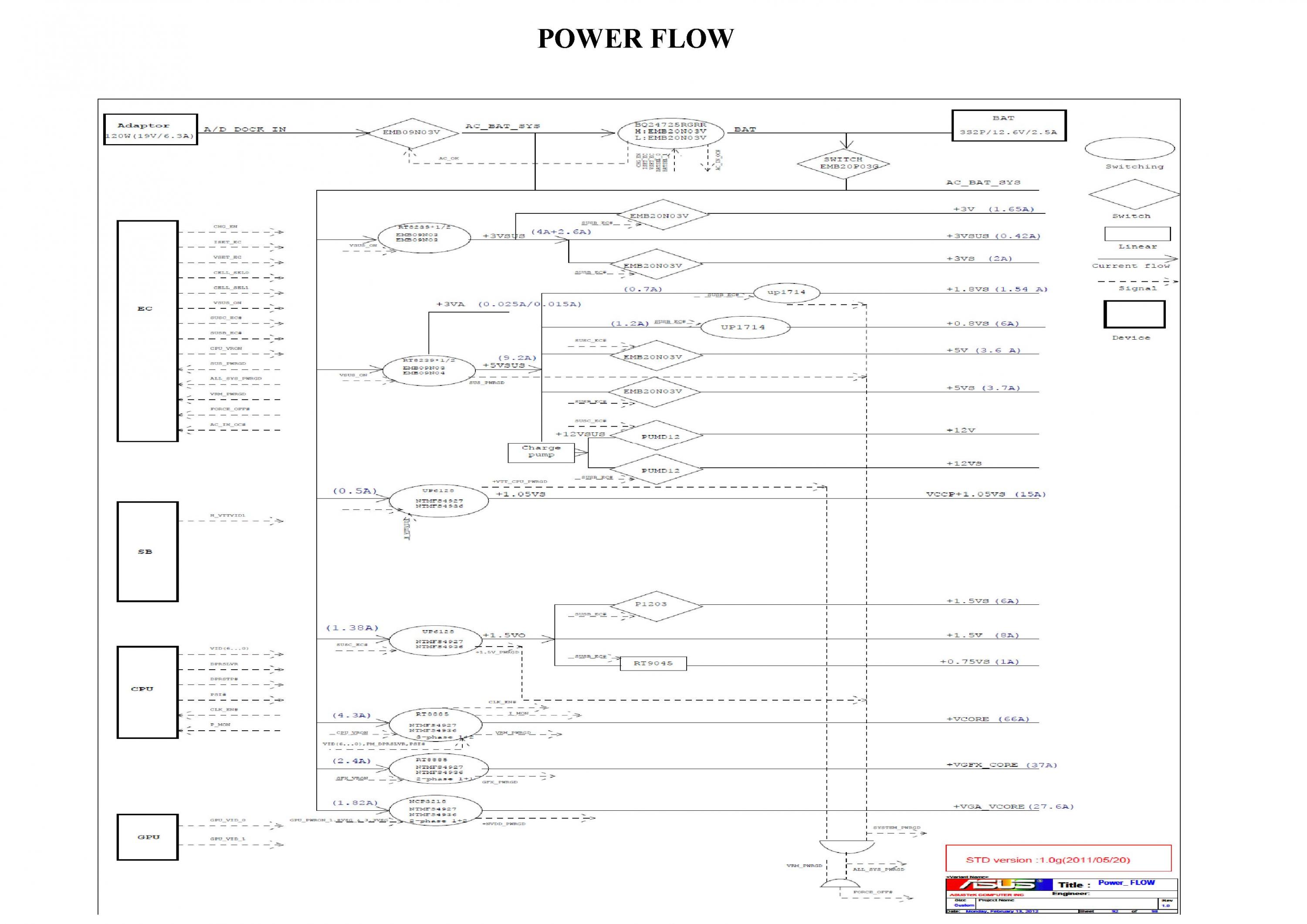

                          hi friends pleas i need schematic diagram asus k55vd ...

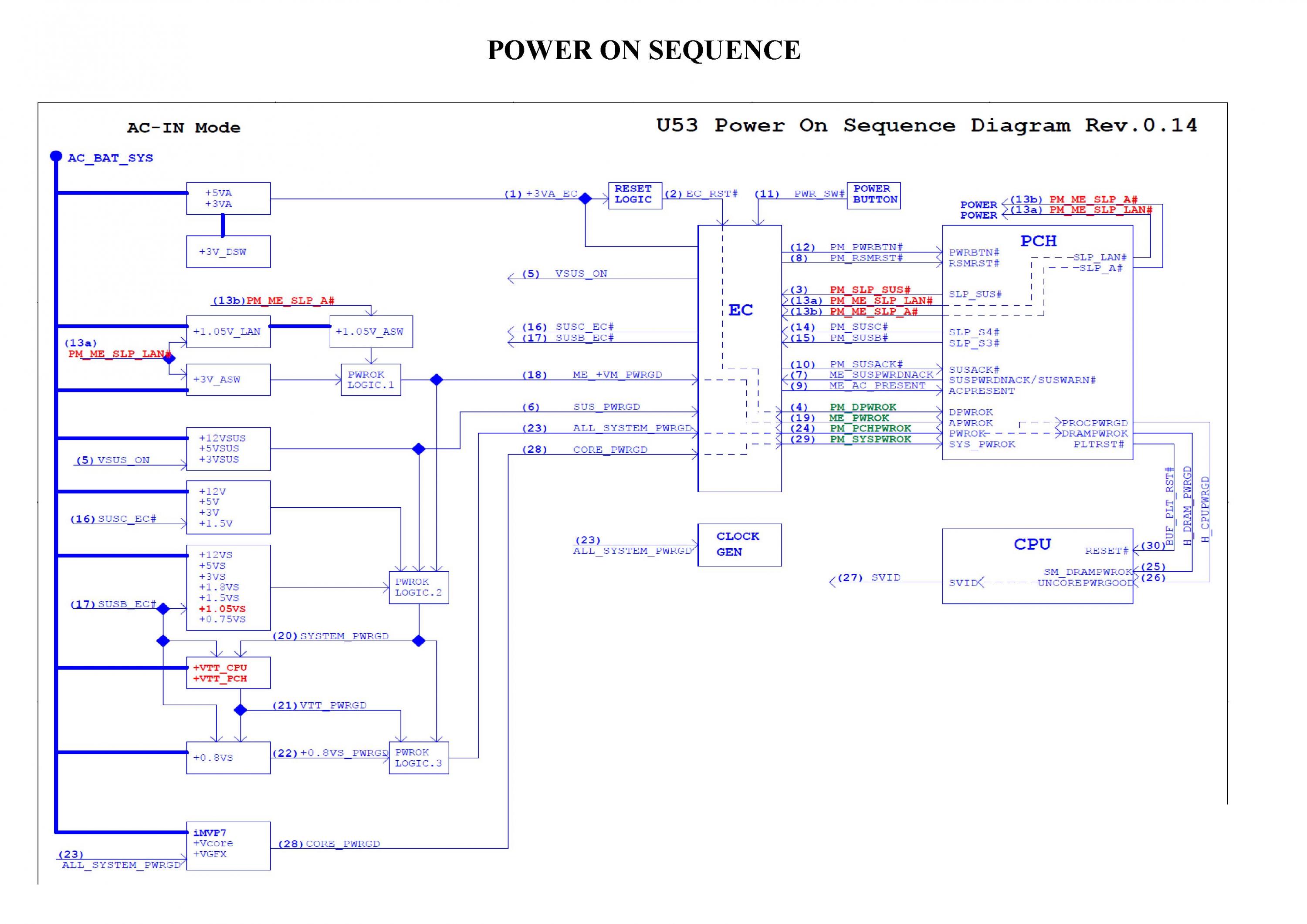

                              the LED energy is constantly on. LED lock 1 flashes twice. LED lock A glows constantly. After two seconds all the LEDs go out. the system does not start. the screen does not light up.. when the memory is removed. LED energy is shining. LED lock 1 is shining, constant glow. the processor is warming up, also warm bridges. After some time the fan turns on. the monitor does not light up. this may indicate a functional bios?
                                Re: asus K55VD - no power
                                PM_RSMRST & PM_PWROK low levels 3,28V (should be 4V)
                                ALL_SYSTEM_PWRGD 3,33v but the laptop turns off, if dismantled memory laptop will not turn off, but the screen does not glow
                                any ideas ???
                                  Those voltages are 3.3V AFAIK. If RSMRST# is low, the system shouldn't react to power button at all.
                                    problem with bios? I have no experience in diagnosis. any assumptions on the steps?

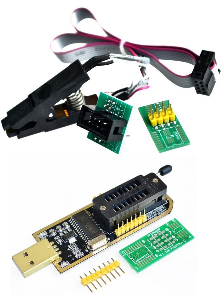

                                      the failure of the BIOS program was confirmed, at the comparative analysis of a dump of a bios from the given mb and the bios of the downloaded from a network with obviously working mb the distinctions. after the firmware the notebook revived. updated the firmware without soldering the chip with a clothes clip.
