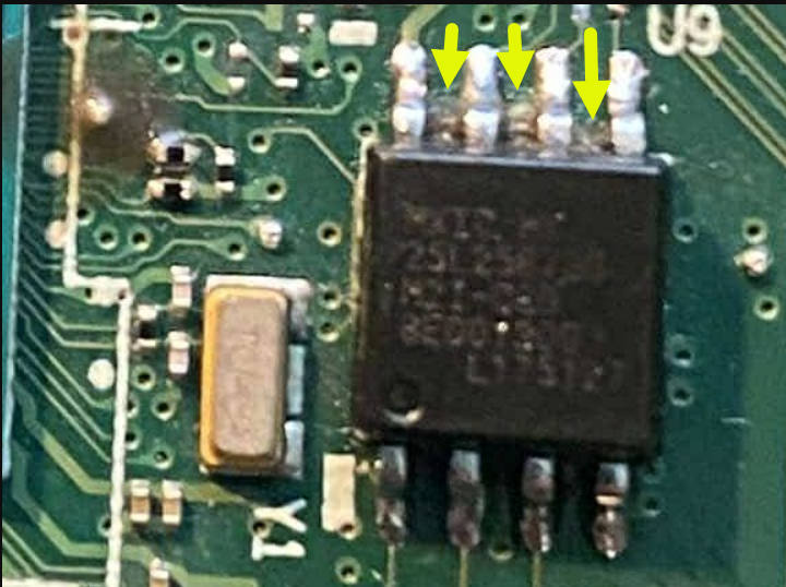

    Hi I search motherboard photo near Bios Ic. I try to remove password. Now when i flashed working Bios back. No power on, only power buton Blink 3 times.

    To the left side of the flash IC there are 3 black smd resistors. You have shorted one (vertical part) with solder. Have a closer inspection of these 3 parts. Fix the solder short and test again. Apply flux and carefully remove the excess solder.

      Its ok but still not working.

        See attached. Flux and clean up these areas.

          No change. Not working. I need photo

            Post a clear pic of this area again.
            Did you make a backup of the original bios?
