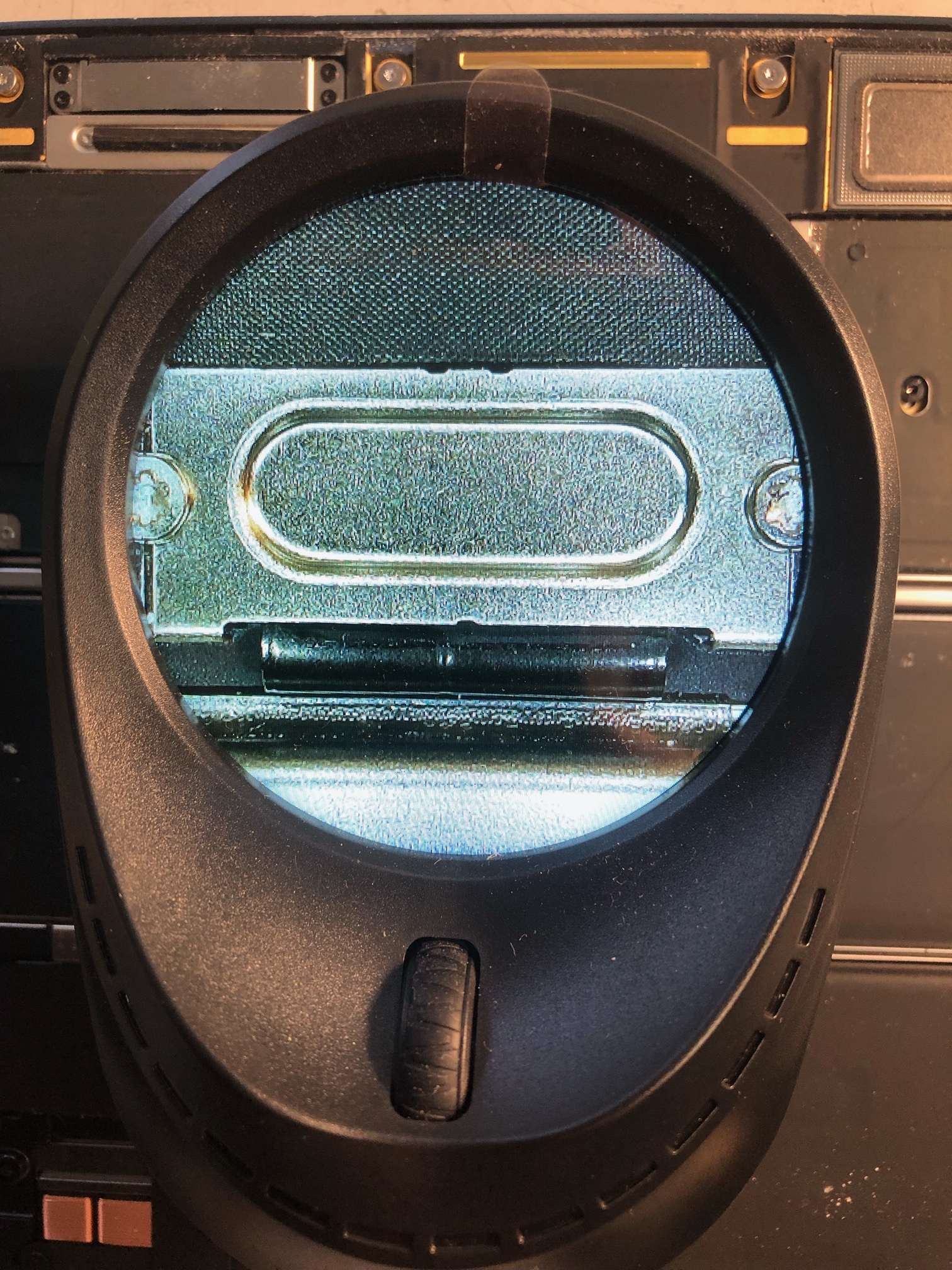

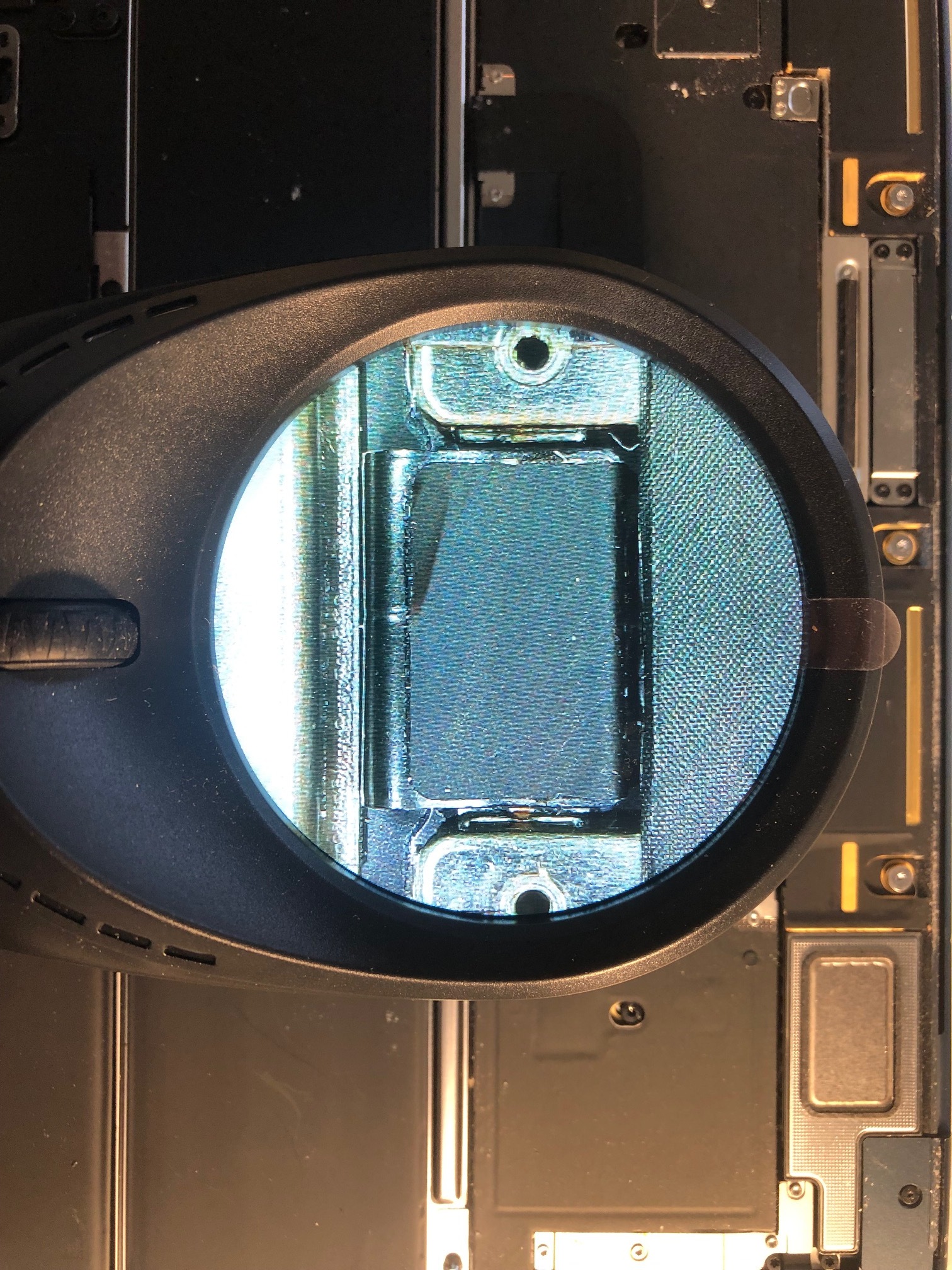

      Ok. Tested with and without this metal plate. The laptop boots in both cases using the battery only. Heard the boot chime in both cases.
      Updated feedback:
      Master Liu (trying to get him to join this forum) - stated that he replaces only the LCD for this model. The camera remains the same so Truetone is not lost.
      Seven Puppy - has sold many of this display assembly - no issues for the volumes of sales.
      Click image for larger version  Name:	IMG_3965.jpg Views:	0 Size:	948.1 KB ID:	3534794 Click image for larger version  Name:	image0 (2).jpg Views:	0 Size:	1.39 MB ID:	3534795

        To all readers - after replacing the display and facing this charging quirk - does the laptop boot using the battery ONLY? If no, then highly recommend to short the resistor from my earlier post as this is the common link to the battery charger to/from the battery = VBAT. According to the schematics, if this resistor is shorted, then VBAT line will enable. Welcome to hear feedback after testing. For us, we are out till this display assembly is more mature. Requested for the client to take it to Apple for service.
