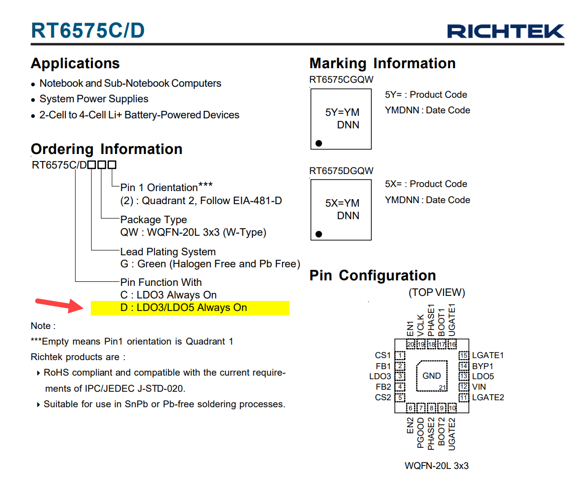

              RT6575DGQW = is a part that must always have the LDO rails for 3v3 and 5v0 ENABLED.
              Since 5v0 is missing, remove all power. Meter in resistance mode. Measure the resistance to ground on pin # 13 (VREG5) of PU28 (RT6575DGQW).
              What is the resistance in ohms?
              Can you also confirm that this IC was not replaced before you? Confirm the SMD markings against the schematic.
