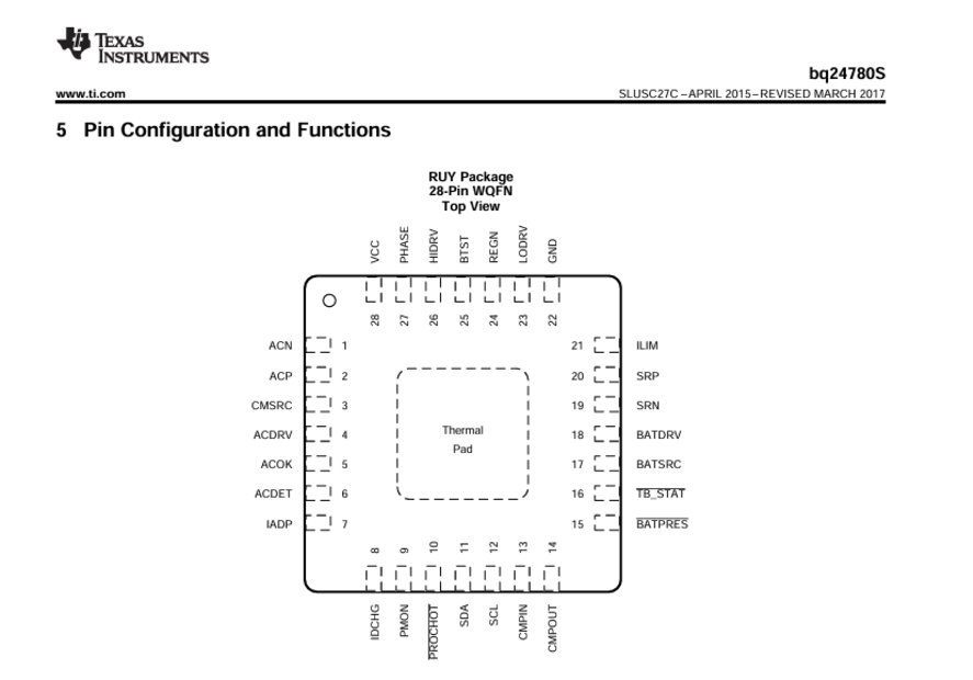

      The charging chip has the reference (BQ24780S) and yes I use the original power bank here are the photos of the chip and the power bank.
      • mon2
        • Dec 2019
        • 14631
        Perfect. See attached for the TOP side view of this charger IC.
        Remove all power. Disconnect the battery. Meter in resistance mode.
        Measure the resistance to ground of the ACP and ACN pins on this charger IC. One meter probe onto pin #1 or # 2. Other meter probe to ground. We are checking if there is a short on the main power rail that powers this logic board.
        What is the resistance to ground?
        Are your meter probes pointy to measure the pins on the charger IC? For resistance check, no issue but need to be pointy for voltage checks so the pins are not shorted.

          yes my probes are pointed my multimeter in diode mode and red probe to ground ACP (0.420) ACN (0.420).
          • mon2
            • Dec 2019
            • 14631
            Diode mode is different than resistance mode. But the diode mode measurements do not show this main power rail as being shorted. This is a good start.
            Now, apply the power. Meter in DC volts mode (30v or higher scale). Measure the voltage to ground on the
            ACDRV pin # 4 ; should be ~25v if all is ok and is used to enable the 2 x DCin mosfets in the power path
            ACOK pin # 5
            VCC pin # 28 ; used to power the IC
            REGN pin # 24 ; must be ~6 volts stable if all is ok

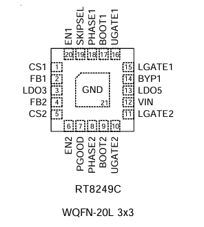

                    here is the 3v 5v chip
                    • mon2
                      • Dec 2019
                      • 14631
                      The measured temps are not considered to be hot.
                      The '2N=' marked part is
                      Richtek # RT8249CGQW

                        Measure the voltage to ground of:
                        EN1
                        EN2
                        LDO3
                        LDO5
                        on this IC.
                        • Kevin555
                          • Sep 2023
                          • 13
                          • France
                          EN1 : 0
                          EN2 : 0
                          LDO3 : 3,3v
                          LDO5 : 0

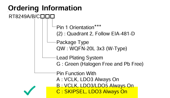

                          • mon2
                            • Dec 2019
                            • 14631
                            OK. LDO3 (only) on is good and follows the part markings.
                            Check the resistance to ground of LDO5 and the output rails on this regulator to be sure there are no downstream shorts.
                            You will have to trace where EN1 and EN2 are enabled. As per your first post, is it the EC or is it a resistor based enable using 2 resistors that are feeding from the main power rail?
                            Often there are 2 resistors building a voltage divider to lower the 19v to a safe enable voltage for EN1 and EN2. Hunt for these parts using diode mode and a tone beep.
                            If mating with the EC, then the EC power rails and clock must be confirmed to be ok.
