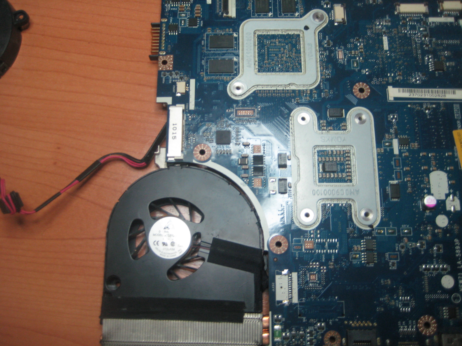

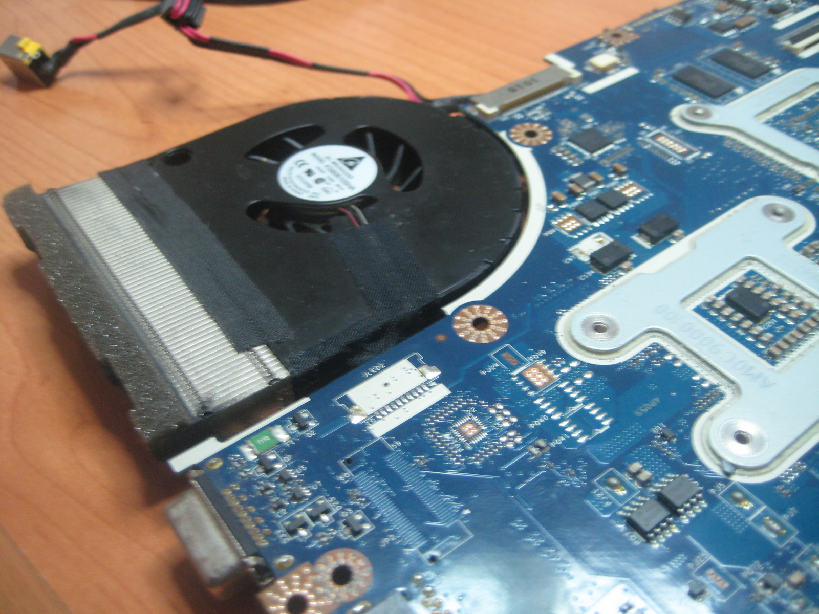

    Hey guys,
    I need some help diagnosing this board, let me explain you what happened..

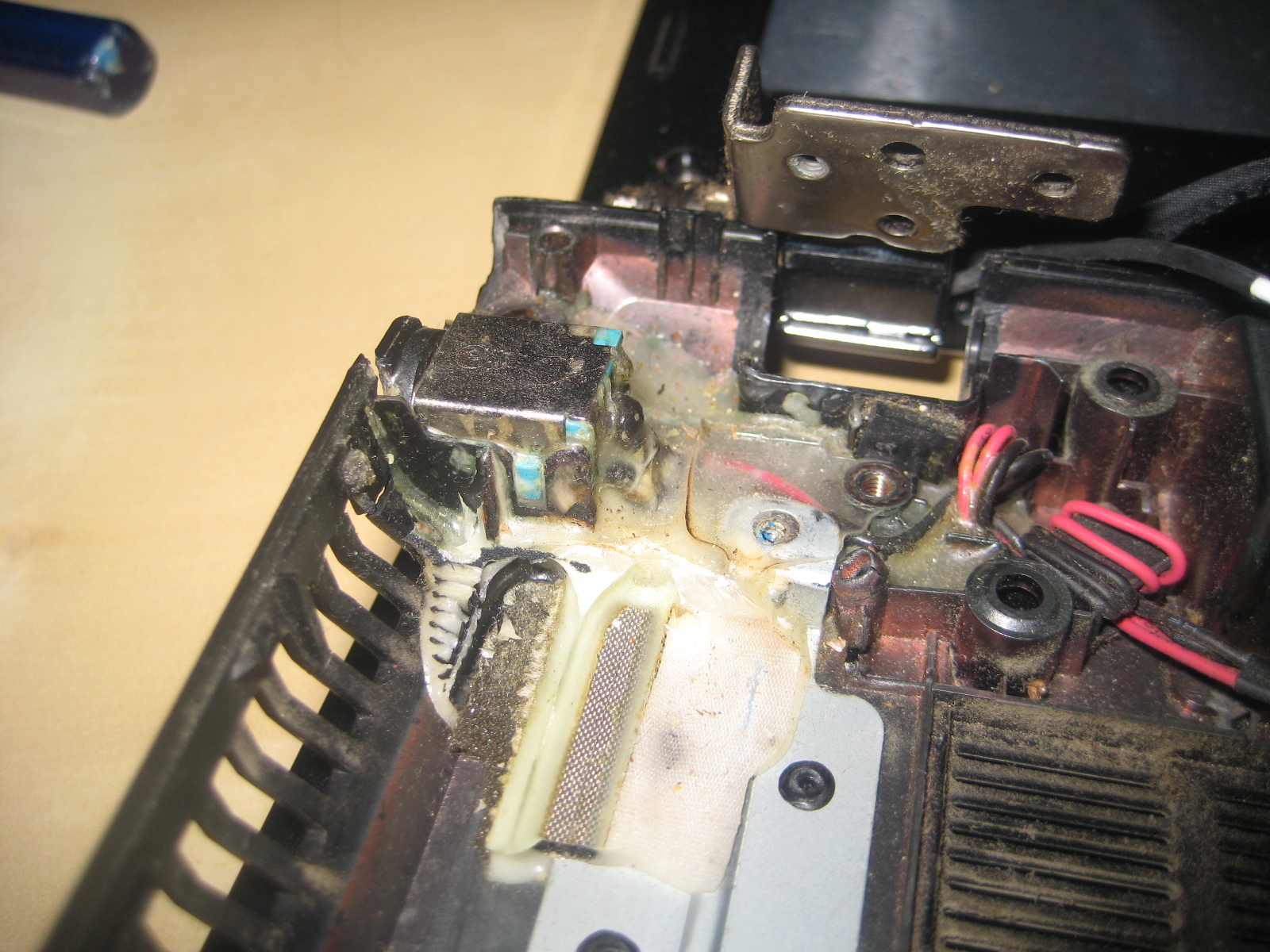

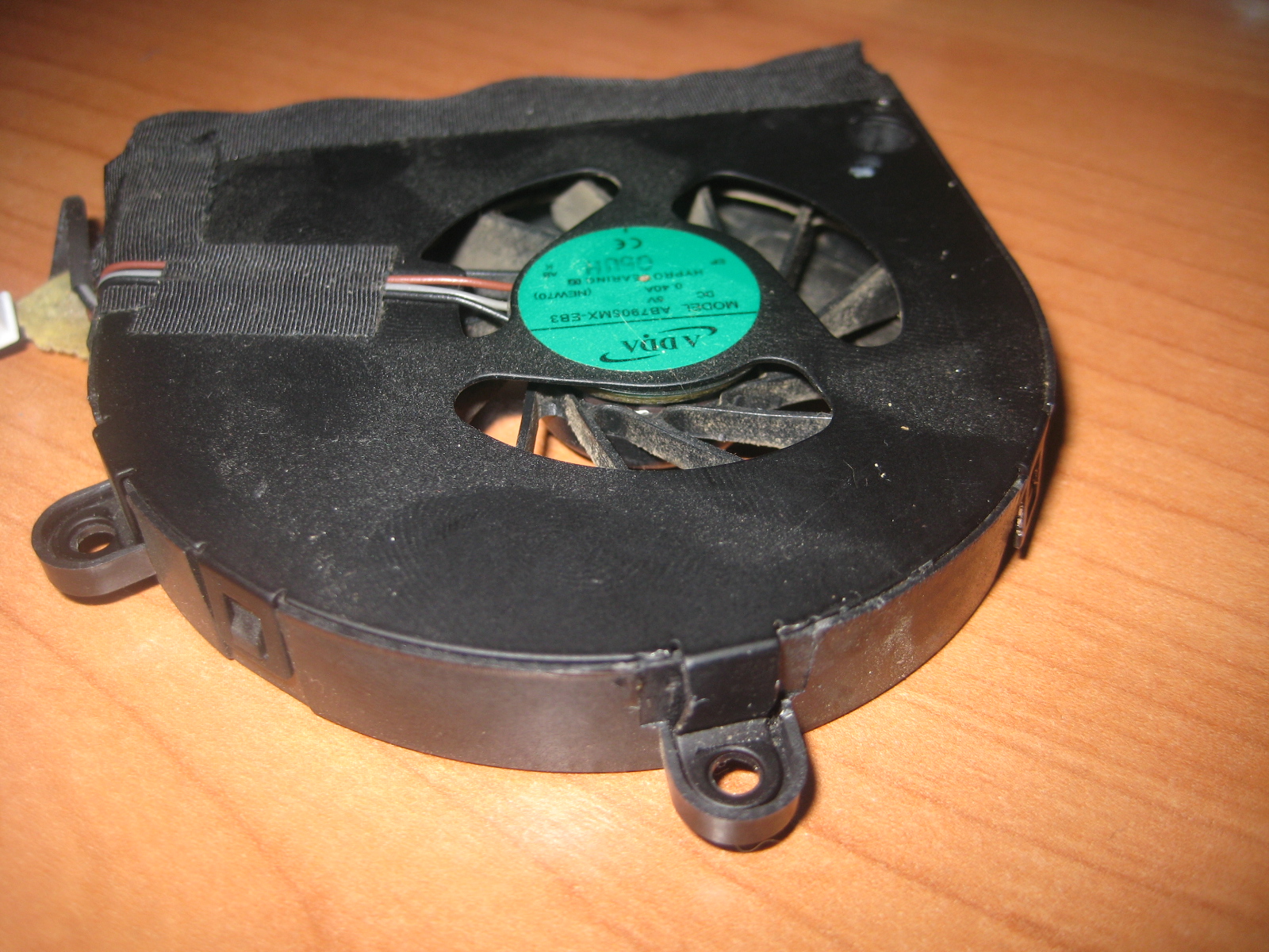

    This was a Packard Bell laptop that came to my hands with a non working fan due to dust. Because the body was full of that nasty white glue in the photos i had to dismantle the fan with board mounted on the body. The laptop was working fine (until overheat) up until i finally disassembled and cleaned the fan.
    After this I never had image anymore.. Now I got a laptop I can use the body, cooler and fan for replacement, so I want to repair the board.

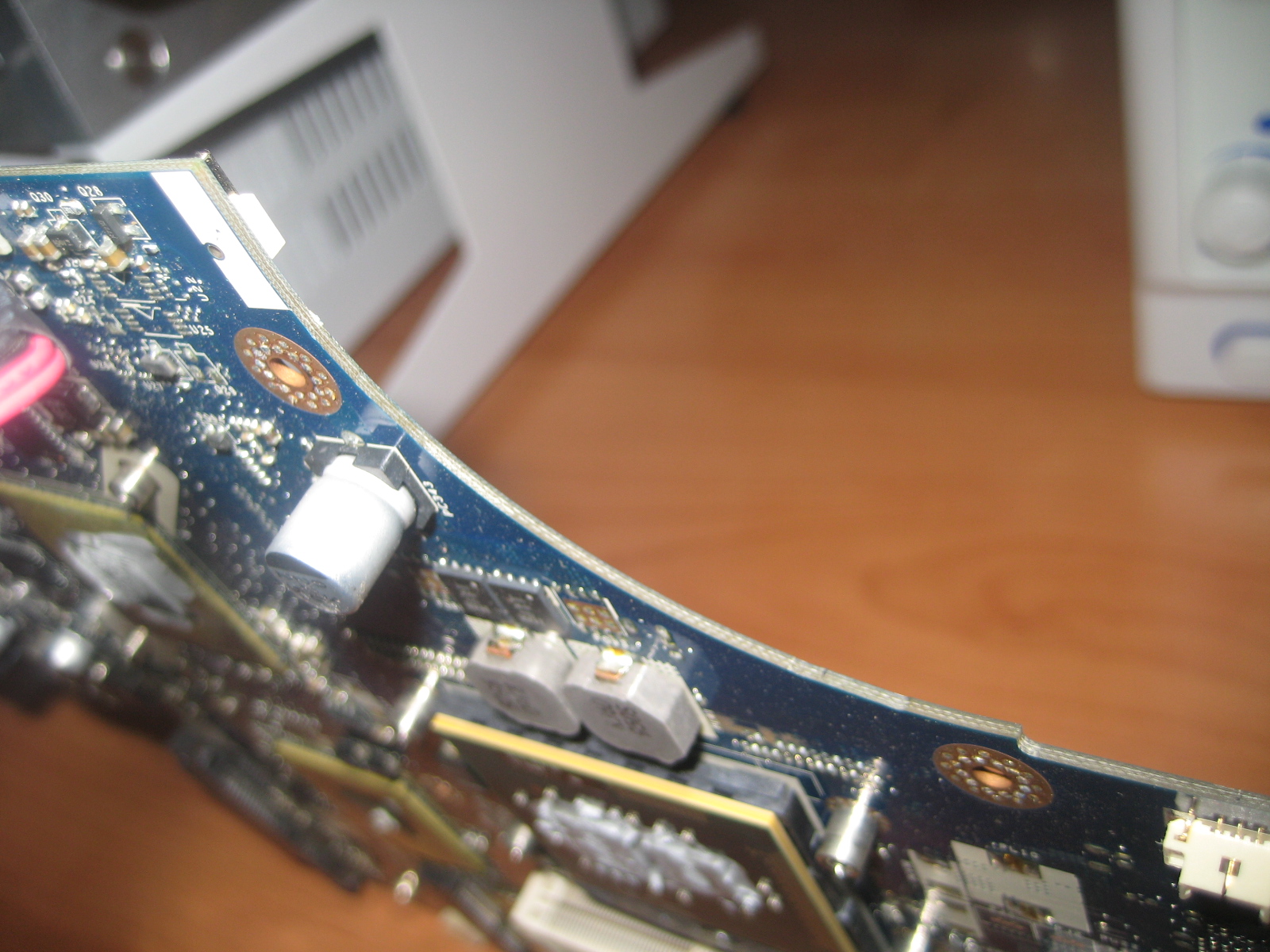

    I don't think I've damaged the board itself removing the fan but I'm unsure, I was wondering if there's anything I can check on the board before I proceed to sending it to reball.
    Thanks.
