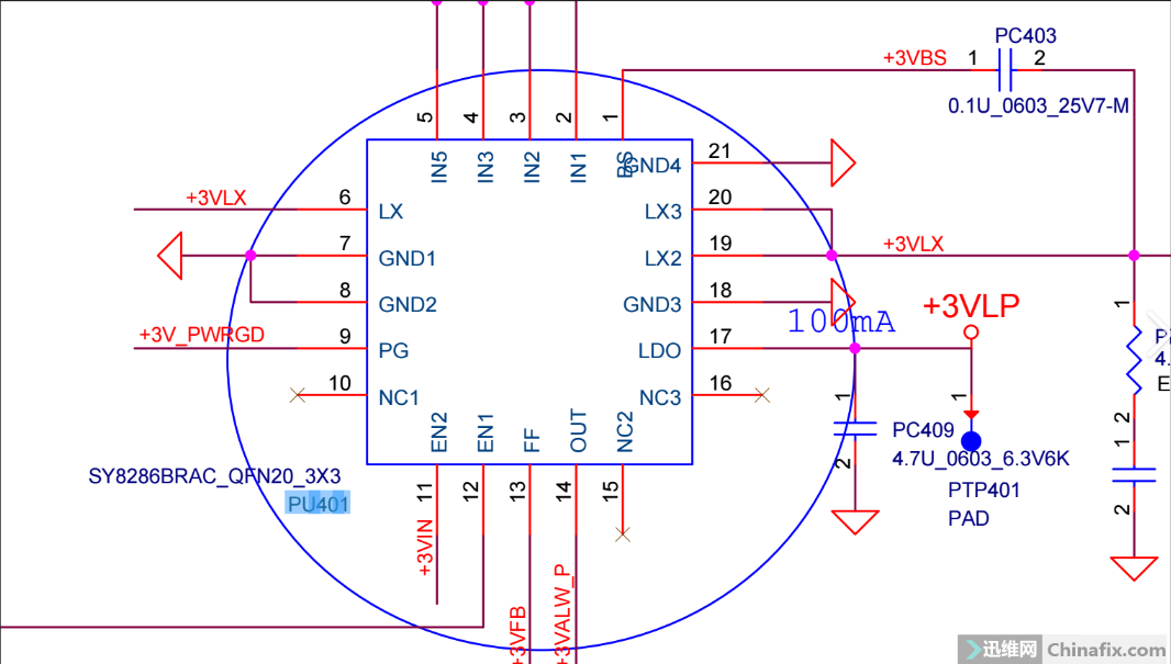

Could somebody please identify u60100? It goes up and down between 3.3V and 0V.
3.3V regulator in HP 14-dw1700nd
If the power rail is cycling then the regulator is in chirp mode. This is probably due to an excessive current draw on the output power rail or the current sense circuit is reporting it as such. Remove all power. Measure the resistance (not diode mode) to ground of this same 3v3 rail that is pulsing. What is the resistance in ohms?
A typical pinout and use of this regulator:
10pieces SY8286BRAC SY8286B (AWV5QB AWV5BB AWV5JA AWV...) QFN-20 chipset - AliExpress 502
SY8286BRAC Silergy Corp | C358653 - LCSC ElectronicsLast edited by mon2; 09-06-2024, 08:23 AM.
