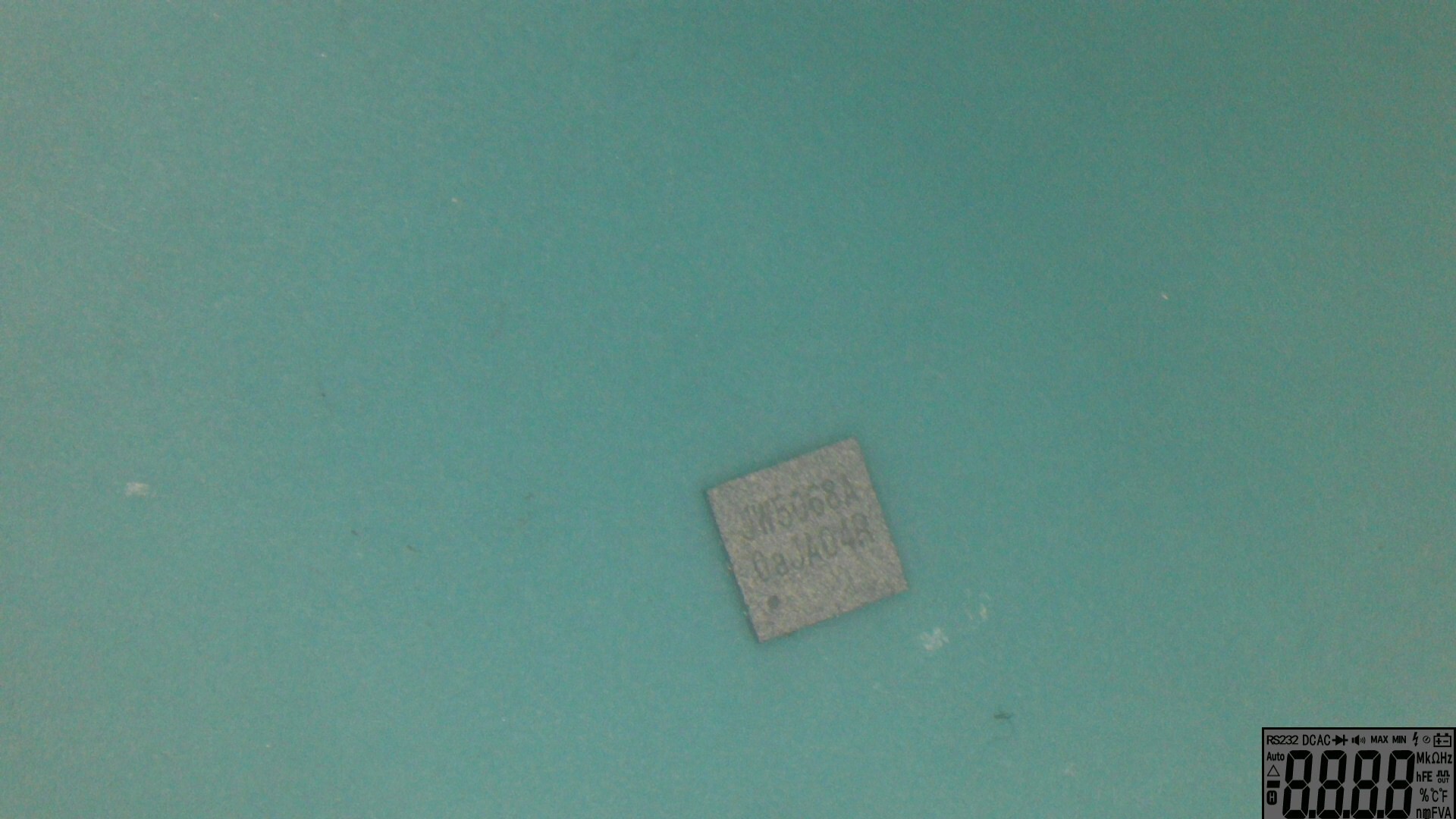

    SY8286RAC << nm-b701 ( DONOR BOARD) i found this on lenovo legion
    SY8288RAC <<LA-J871P(CLIENT BOARD) shorted 1v pch rail.. upon replacing pch.. short still not removed.. upon removing this regulator shorts gone.. but I don't have this ic
    are they compatible? acer didn't even used a syllergy IC some new kinds of regulator

    The IC in your picture is a joulwatt JW5068A
      are they compatible with SY8286RAC?
        • 21889
        Yes i think so. Compare the datasheets
        JW5068A https://arduino.ua/files/1903051031_...8A_C371422.pdf
        SY8286RAC https://www.silergy.com/download/dow...nHmkOU4yag3​
