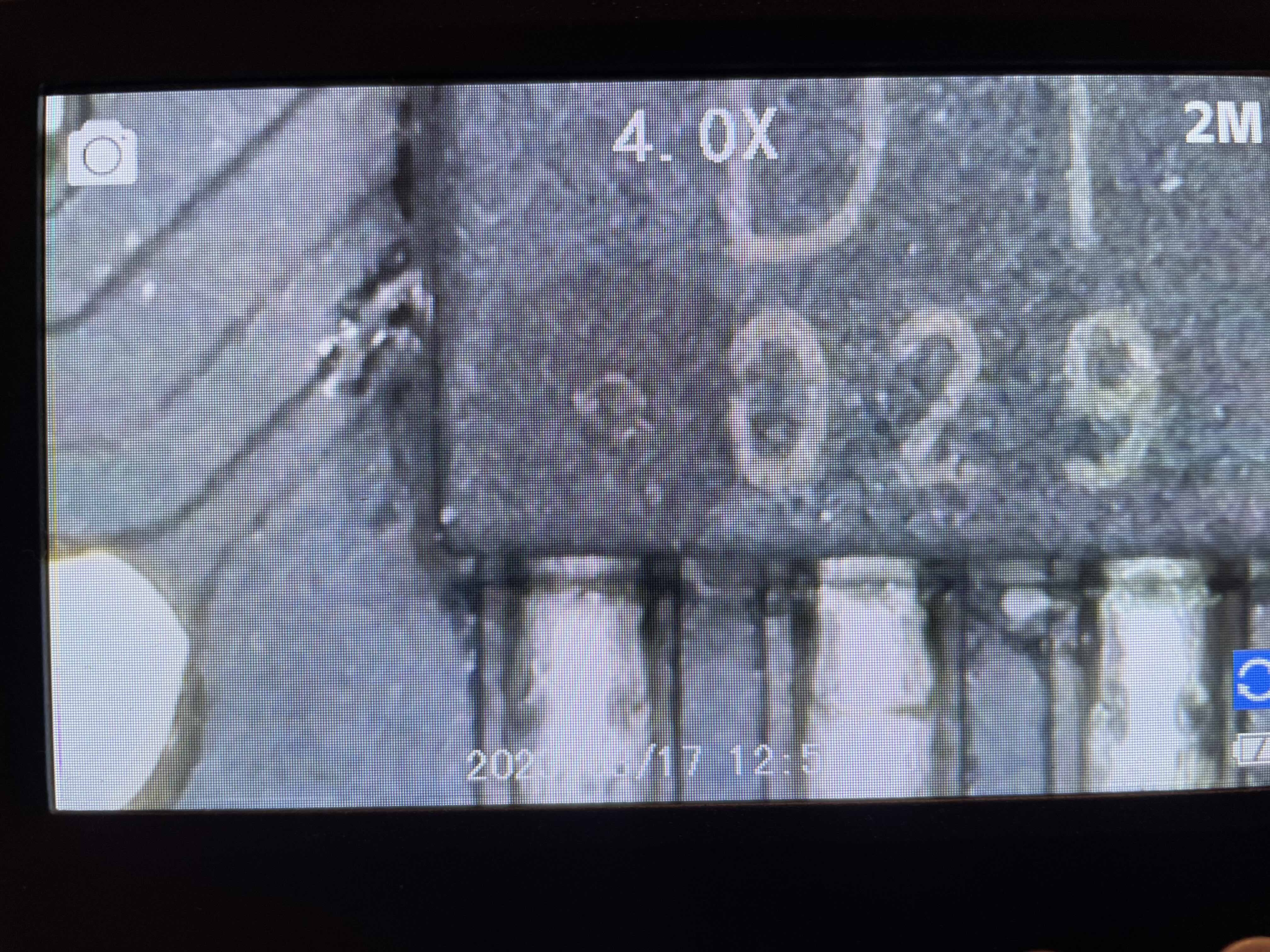

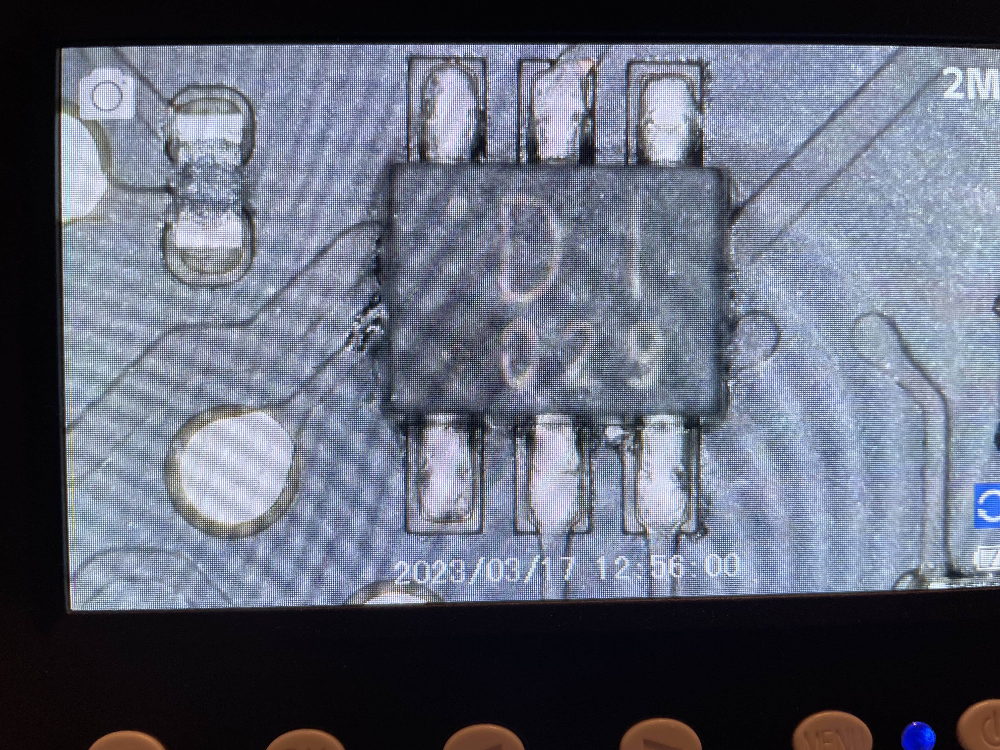

    Board draws about 0.5A for about 10 seconds, after that it goes down to 0V. Found an n channel FET (Q4830) in the backlight supply(?) that could to be blown (pictures below), not quite sure about that, but t assume that should not be relevant, because I was testing the board standalone and disassembled from the MacBook with the USB C supply only.

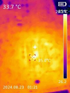

    On the thermal image U3900 seems to get pretty hot, because even the metal shielding gets hot to some point and heat dissipates through the PCB on the caps below (I know the thermal image is very low resolution, could literally be a surface picture of the sun if you consider the amount of pixels of the image)
    Click image for larger version  Name:	WhatsApp Image 2024-08-22 at 19.21.05.jpg Views:	0 Size:	10.1 KB ID:	3335435
    Click image for larger version  Name:	WhatsApp Image 2024-08-22 at 19.21.15.jpg Views:	0 Size:	10.6 KB ID:	3335430
    That is why I assume U3900 is likely dead. Does anyone know anything about U3900, it sits under the metal shield. Is it publicly available? I assume it's some kind of ASIC, because the name "POP-1GB-20NM-M-SCK" suggests it was manufactured using 20 nanometer technology.

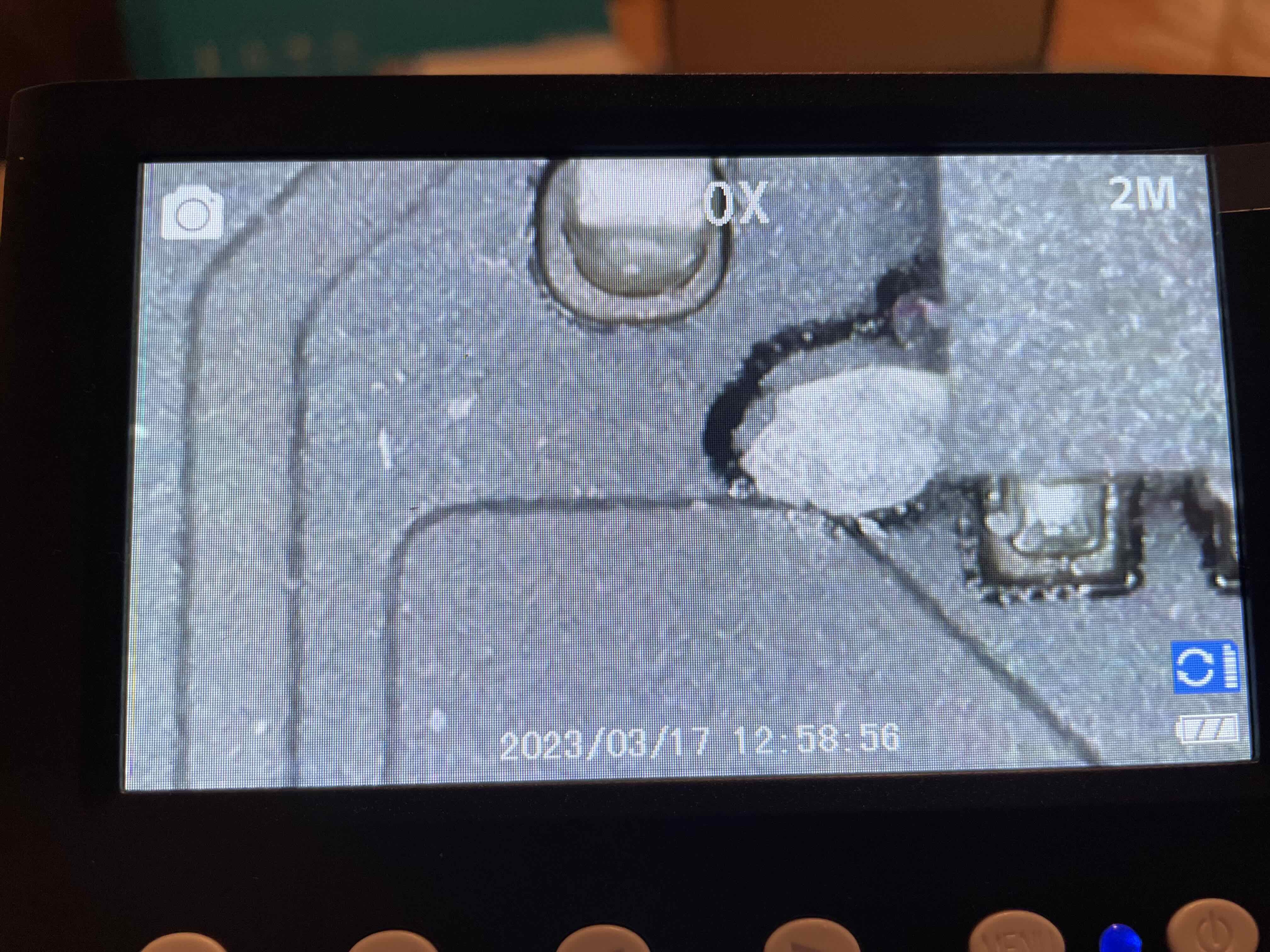

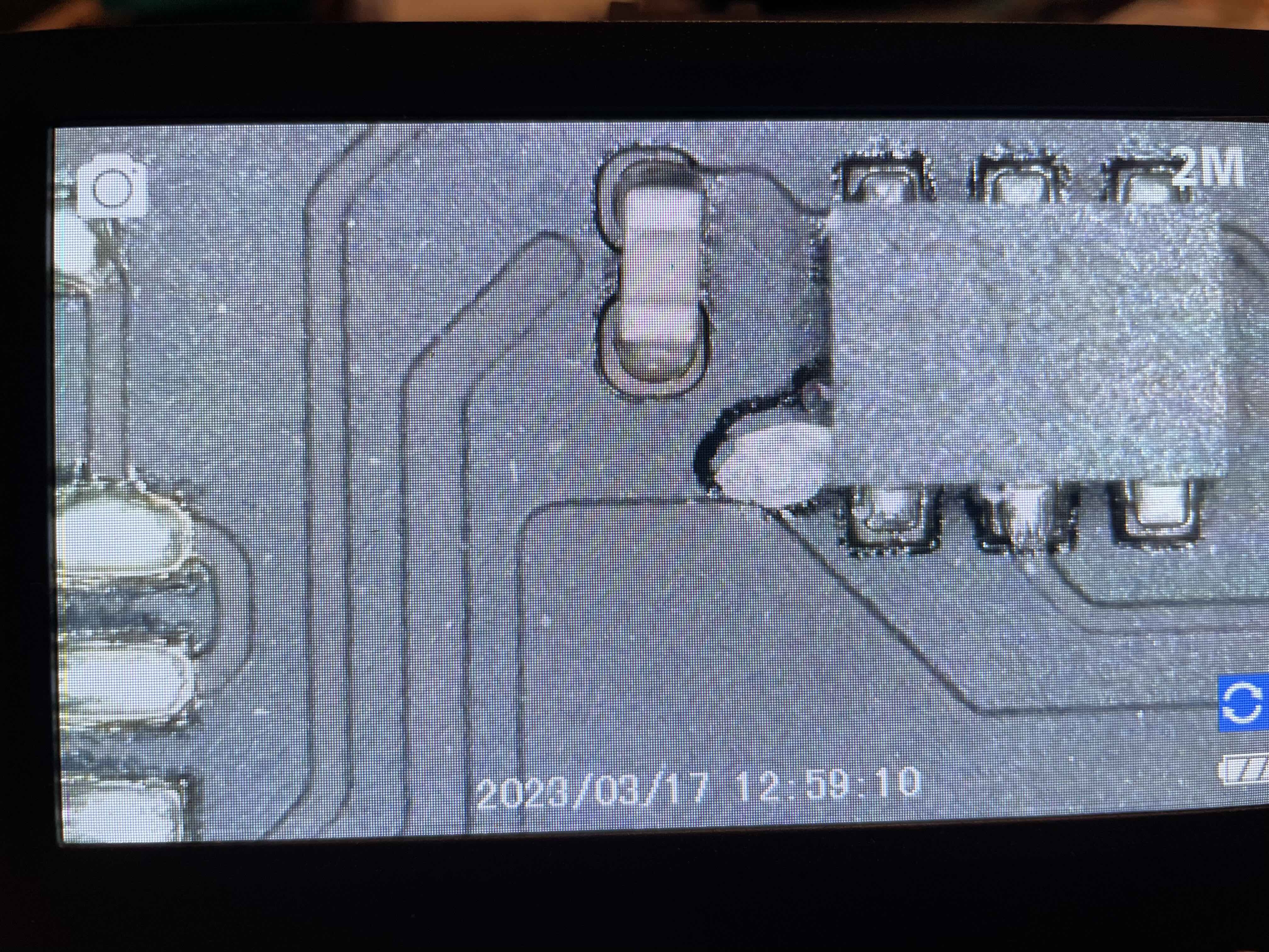

    Could the problem be related to the likely seemingness "drop of solder" / bridge on these 2 images or is it meant to be there?
