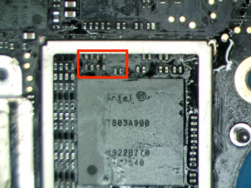

    A2141 820-01700 5v 0.200 amp draw
    This computer had an SSD failure initially and I've replaced all NANDs with known-goods and made huge stress tests on the SSDs and on the computer.. then I sold it..
    Now after two months of selling the laptop it retuned on 5v and drawing 0.200 amps.. T2 is heating up and U6960..
    T2 PMU has all voltage power outputs also U6960 is producing PP3v3_G3H normally..
    All USB-C doing the same behavior no USB-C port behaving differently all taking 5v 0.200 amps..
    I took measurements for shorts all around and found nothing..
    Board is not in DFU and does not go into DFU..
    PPBUS 12.3v
    3v3 and 1.5 USB-C LDOs reading OK in diode and volt
    NAND voltages are not present

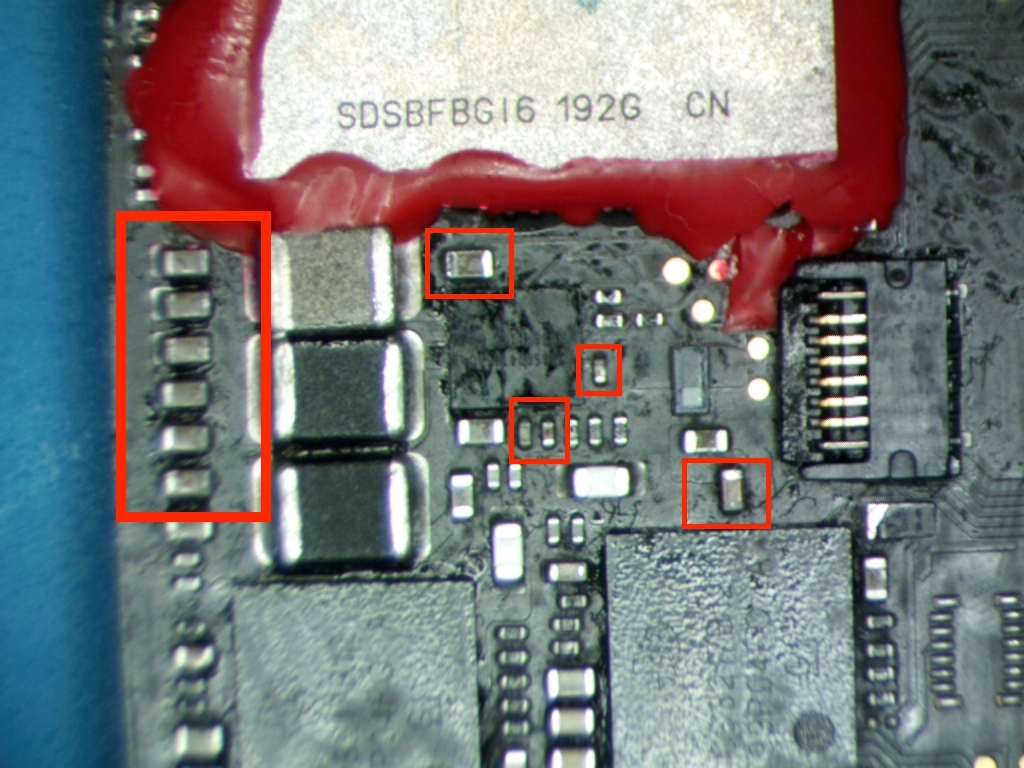

    One thing I'm not certain of is I found flux around U2800.. I'm not 100% sure if its a residue from me from the first though I highly suspect that because I've cleaned the board of course before selling the laptop.. what's making me even more sus is I found few tiny corroded capacitors around U2800.. and I'm 100% sure this computer did not have liquid damage AT ALL when I replaced the NANDs first time.. it was a matter of dust around the U9580 as always..
    They could have sent it to somebody who tried cleaning it up before returning it to me..
    But those tiny caps are driving me crazy.. are these corroded caps or am I blind? (I will post pictures when I get back to work today is my day off)..
    Anyway back the main issue.. what could be my problem on this board?

      I posted the corroded caps that caught my attention.. pics below

            LDOs were OK as I mentioned in my first post.. It's a CD3217 no 3215.. it has only two LDOs 3.3 and 1.5 and both OK on all USB-Cs..
            I've taken diode measurements around the U3100 and U3200 because the corroded looking caps are in that area.. I've found very low diode reading on R3019.. it should read 0.571 and it's reading 0.063
            R3019 side 1: 0.063
            R3019 side 2: 0.088
            Walking down the lines it goes to the TBT ROM..
            TBT_X_ROM_WP_L
            TBT_X_SPI_MISO
            Are reading very low diode readings too
            I found UPC_X_SPI_CS_L completely shorted to ground and this line goes to the thunderbolt chip (U2800)
            I am certain now that the thunderbolt chip is bad and it's been water damaged and tempered with.. I wanted to go all the way through to be as just as possible.

              Can I put a U2800 from another device normally or do I need to transfer TBT ROM alongside with it? I looked in my donor drawer and found an exact replacement

                I've a replacement U2800 to the board.. now it's switching to 20V consuming 0.02-0.13 amps.. heat coming from T2 nothing else..
                I thought it needs its TBT ROM.. so I also moved it..
                I thought it needs revive; failed on error 9
                Tried restore; failed on error 9 as well; I tried multiple times to restore..
                SSD1 and SSD0 rails volts are all coming in..
