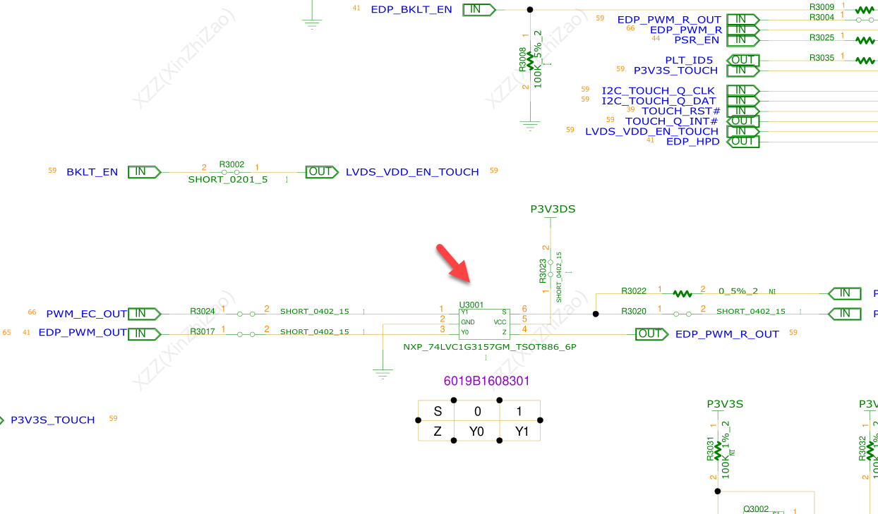

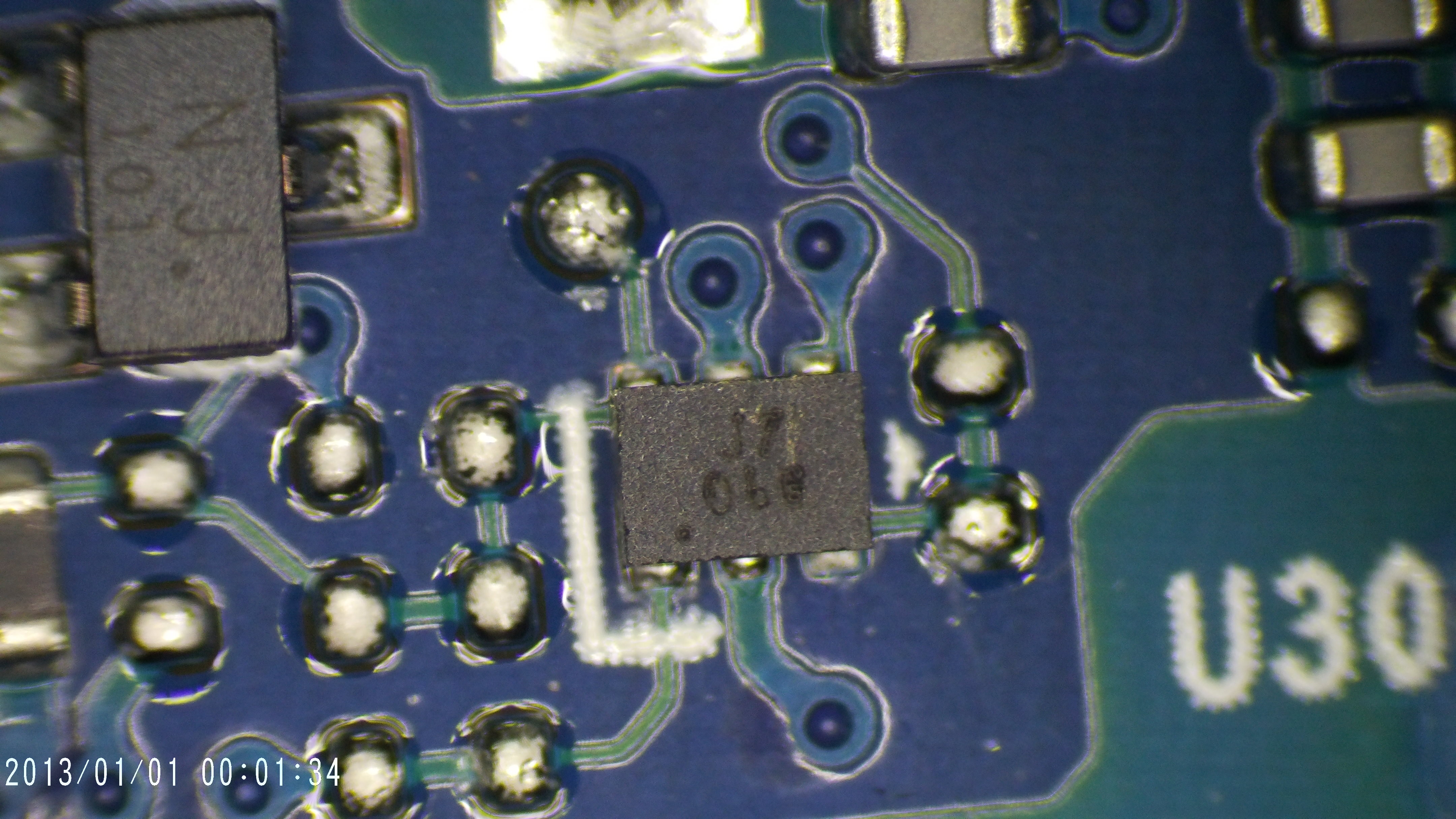

    Can someone help me identify this chip?
    U3003 board 6050A3028501 - MB - A01 (scheme not available) ProBook 650 G5
    Marking code j7 0b0?
    Package DFN6 1x1.5mm
    Pin 2 : GND
    Pin 5: 3,3V
    Near LVDS conector.
    Thanks in advance.

    Could be this one (used on similar boards from HP):

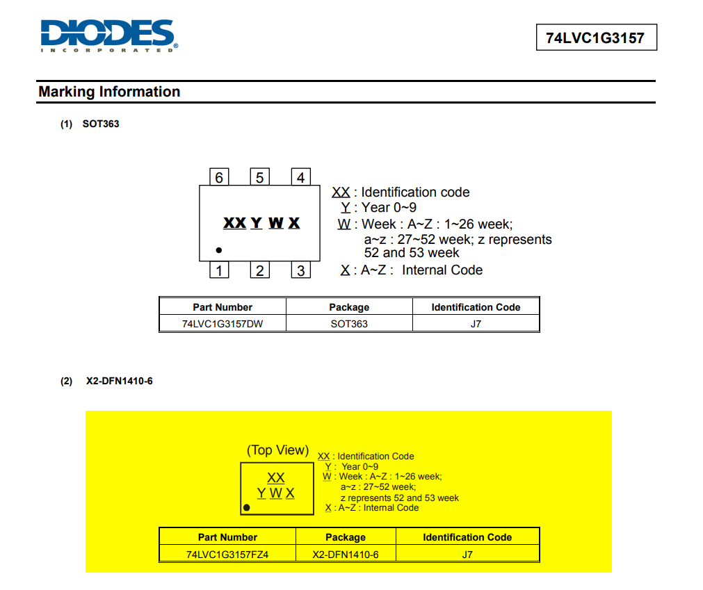

    Part # 74LVC1G3157FZ4 (can be replaced with NXP = Nexperia 74LVC1G3157GM
    74LVC1G3157 (diodes.com)

      Thanks for the information🙏
      It's an analog switch! 🤦‍♂️
      My board has the missing component and there is no image on the panel
      I'm going to try short 1->4 or 3->4
      At the moment I have not found any donor board in my scrapyard​

        Finally I connected pin 1 to 4 and the laptop is working. Thank you very much mon2
