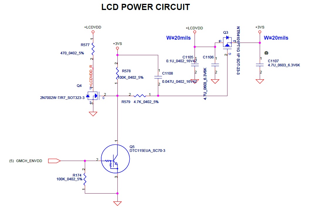

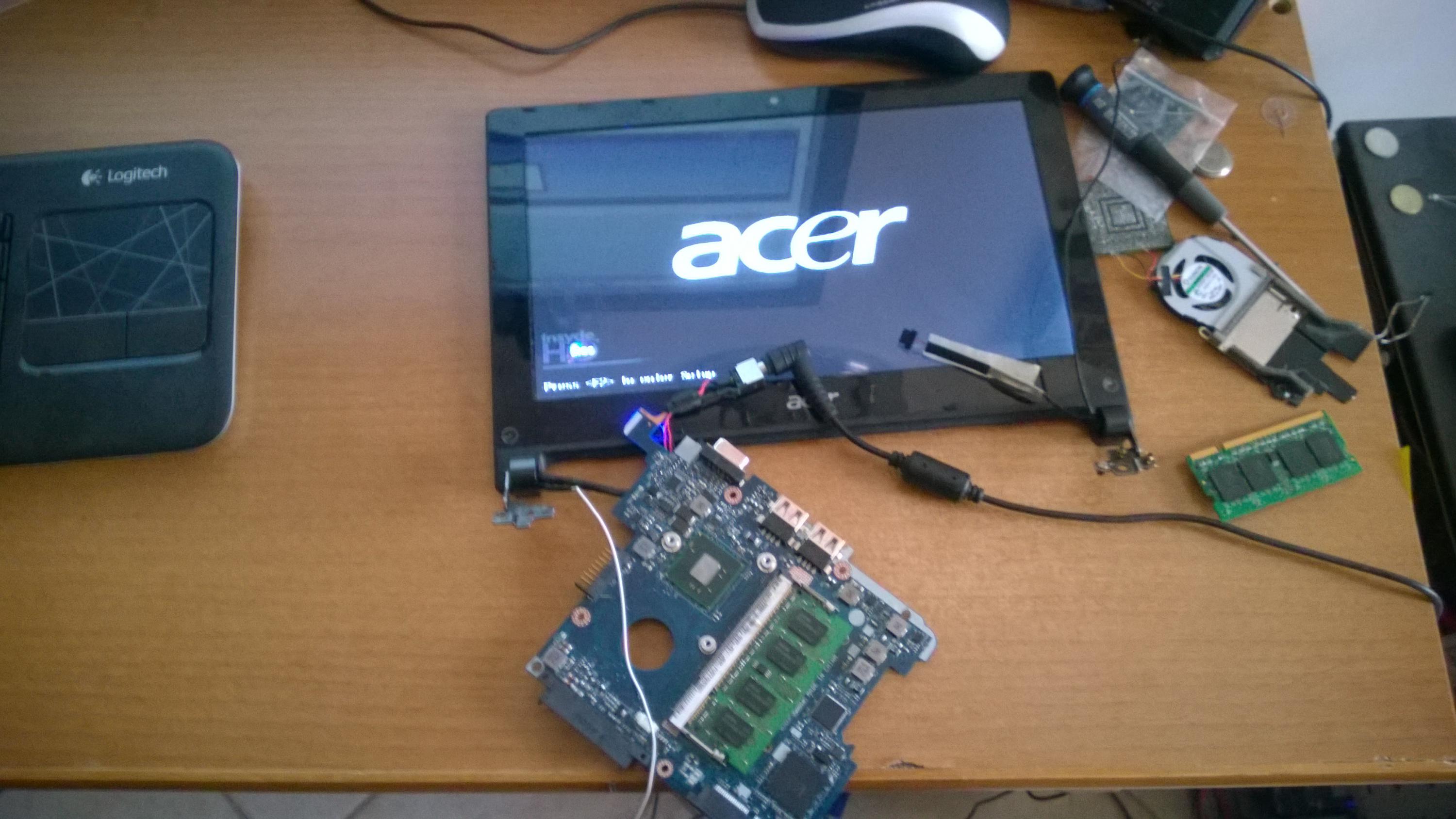

                                changed pu4 and now pc light comes on . also all voltage on coils are present, but i have no video. maybe because i dont have any fans connected ?
                                edit: connected fan still the same..... atom reflow ?
                                edit2: on pin 2-3 of q3 i have 3 volt. 0volt on pin 1.
                                on q4 i have volt on pin2
                                on q5 i have volt on pin 1
                                on L1 i have 19volt
                                bad q3 ?
                                NTR4101PT1G 1P SOT-23-3 is Q3 where can i find it in europe ?
                                • dellxps15
                                  • Feb 2014
                                  • 1585
                                  • italy
                                  Re: acer d260 netbook nav50 la-5651p
                                  can someone explain me that circuit ?
                                  is it a gmc problem ?
                                  r174 is 66k instead of 100.... change it ?
                                  edit changed and also 66k.
                                  edit2: whaaaaaaaaaaaaaaaaaaaaa changed another ram (used a 512mb and tryed with a 1gb ) and.... it works

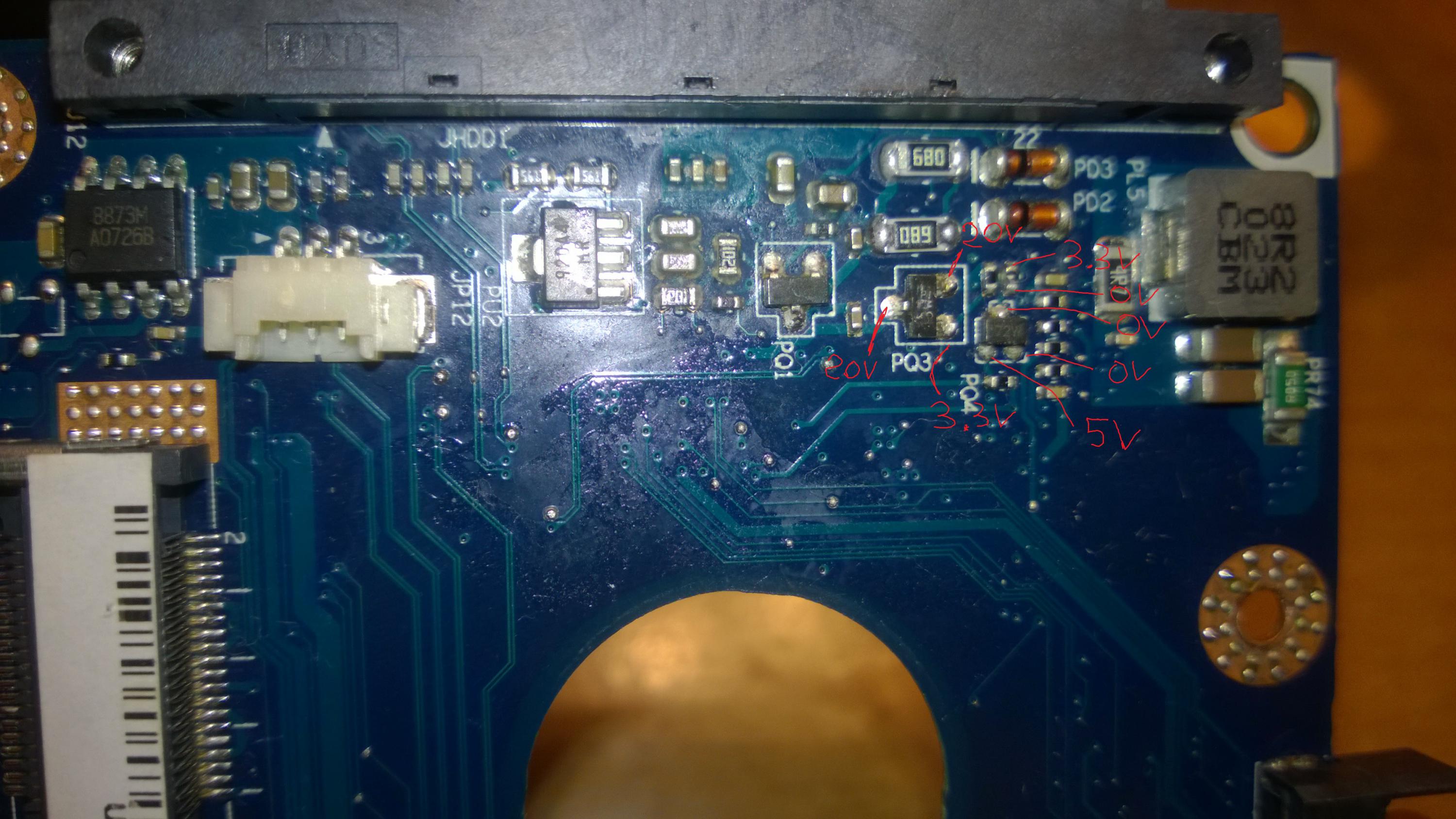

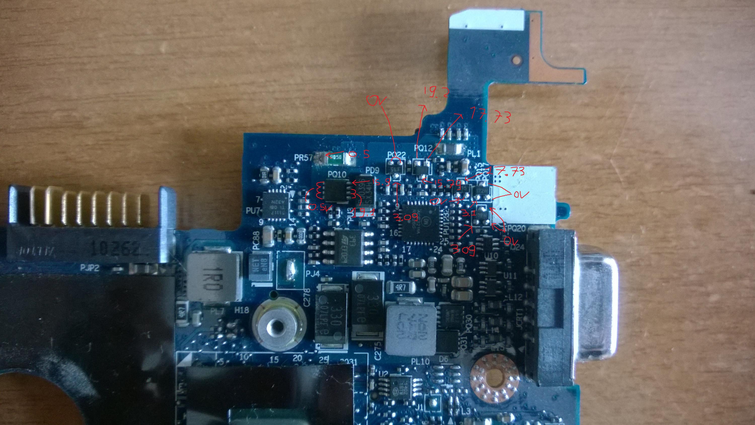

                                    hi, today i got another nav50 acer 260d mainboard. it works fine with battery, but dont boot on power supply only. with psu i have no 3.3 and 5 volt. on pr57 i have about 1.5 volt.
                                    on pq10 i have 18volt on pin 1-2-3. i have 16volt on pin 4 and 1.5 volt on pin 5-6-7-8.
                                    so i suspect pin 4 should be lower to enable that fet.
                                    can someone explain please that circui part on page 25 ?
                                    tnx in advance
                                    • khaahk
                                      • Dec 2013
                                      • 746
                                      • Estonia
                                      pq20 gate voltage?
                                      • dellxps15
                                        • Feb 2014
                                        • 1585
                                        • italy
                                        i have a working and no working board. the first difference i see are on pq12 pin 3 ; in working board i have 7.5volt, while in the non working i have 15.79v.
