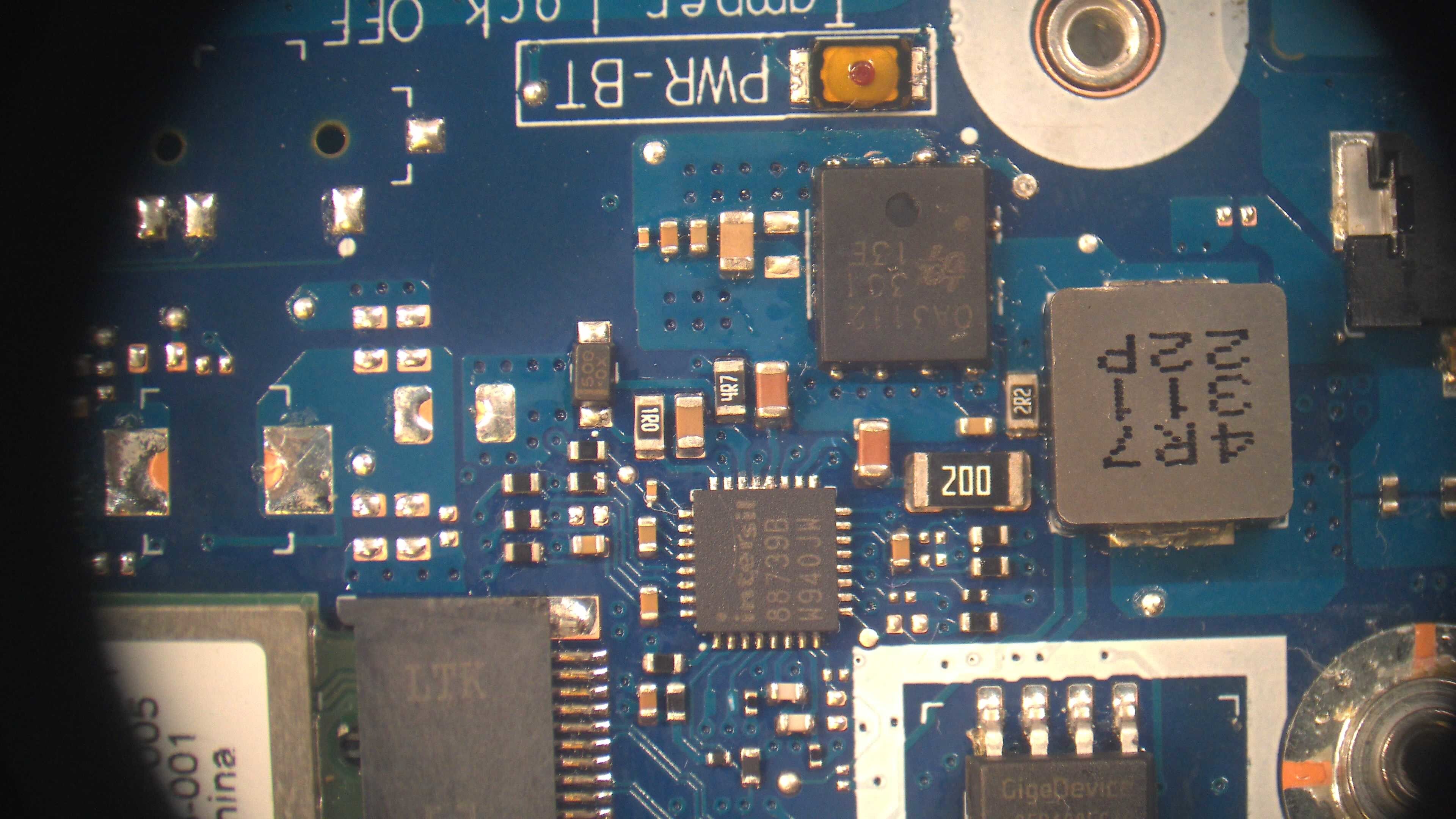

    Hi, everyone.
    I need help with this repair, please.
    This laptop came with no signs of life.
    There is no orange/ white light on the charger.
    The only voltage present on the motherboard is 19V.
    After inspecting it with a thermal camera I found the charging IC (ISL88739B) very hot.
    Pin 21 shorted to ground which goes to the date to the mosfet next to it.
    I've replaced it with another ISL88739A and the short is gone it started to get an orange and white light on the charging port.
    5V present

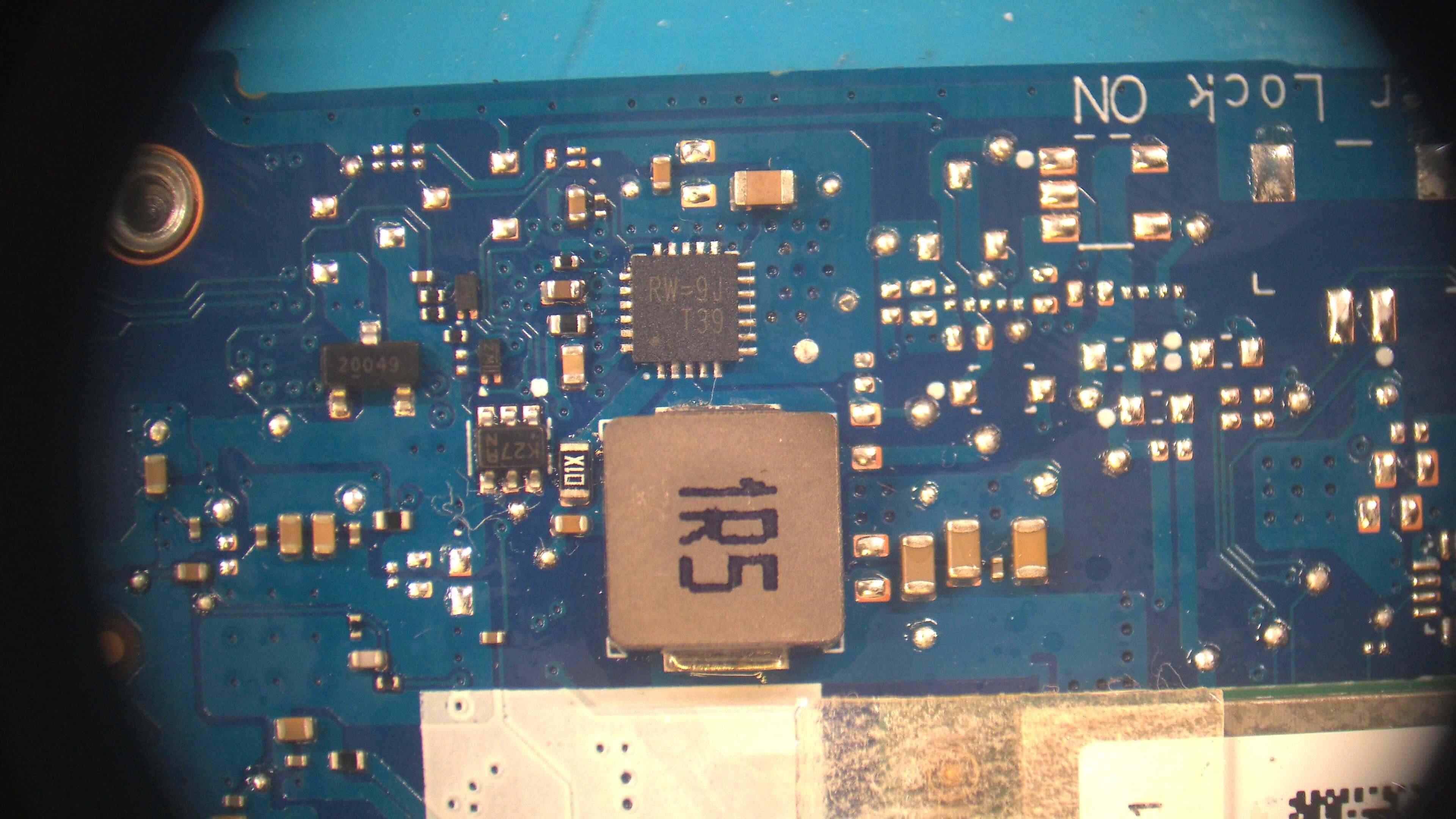

    3.3V line not present. The IC on the picture RW=9J T39 which created the 3.3V is receiving 19V, but not creating 3.3V.
    3.3V on the BIOS and Power button present.
    So after a few minutes, all the lines are gone again and just 19V is present as before and no LED light on the charger.
    No shorts on the motherboard or heat is under the thermal camera.
    I replace the ISL with the correct one ISL88739B and still the same. Is the ISL88739A different from the ISL88739B?
    I can't find schematics for the motherboard or datasheet for ISL88739B or RW=9J T39.
    Thanks in advance for the help.

    In most of the HP gaming laptops only 5V is present before switching. 3.3V comes after switching.
    Dont know whether 88739A/88739B id different or not.
