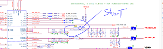

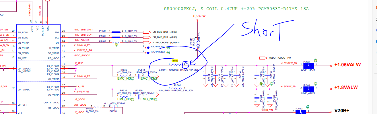

                PL3501 3V3
                PL3502 5V
                PL3502 0V2
                PL503 0V => I notice a short on PL503 pin 2, I don't see any capacitors in poor condition, I will try to inject voltage to see where it heats up, unless the 32 ohm resistor is normal ?
                Click image for larger version  Name:	PL503.png Views:	0 Size:	135.9 KB ID:	3305991
                PL501 0V
                PL7502 0V
                PL3201 0V

                  Wait - 32 ohms is fine since this is a low voltage rail. This is normal.
                  • madjid911
                    • Dec 2016
                    • 410
                    • France
                    ok thanks for the infomation, I didn't inject any voltage, I don't see any other problem
