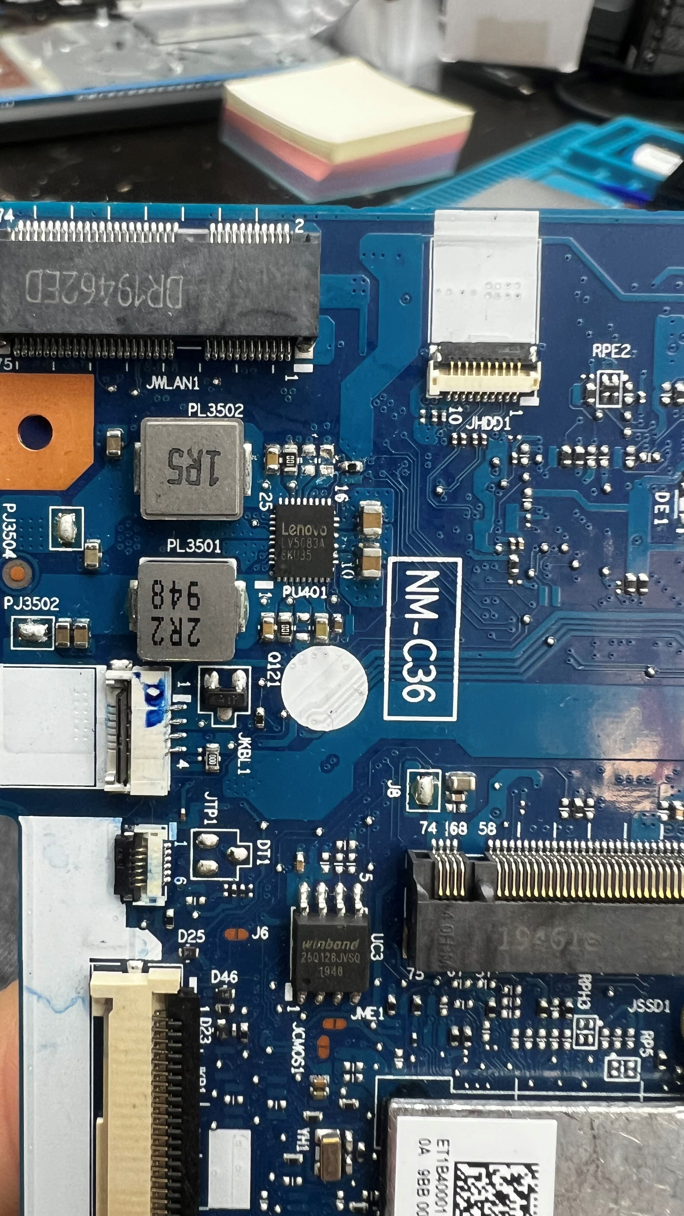

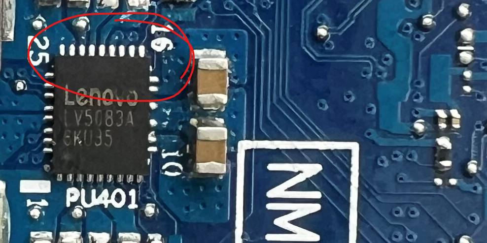

    i've got for repair Lenovo L340-15IRH fg541/fg741 nm-c362 rev 1.0, laptop have instant short 20v 0.20amp draw, lv5083a goes to 100degree, i've removed 1 shorted cap next to the IC and short still remain, from look of it short comes from legs 16-25, i can't find what this IC i believe is 3/5V regulator?
    First mosfets normal 20v Source and drain and Gate 25v

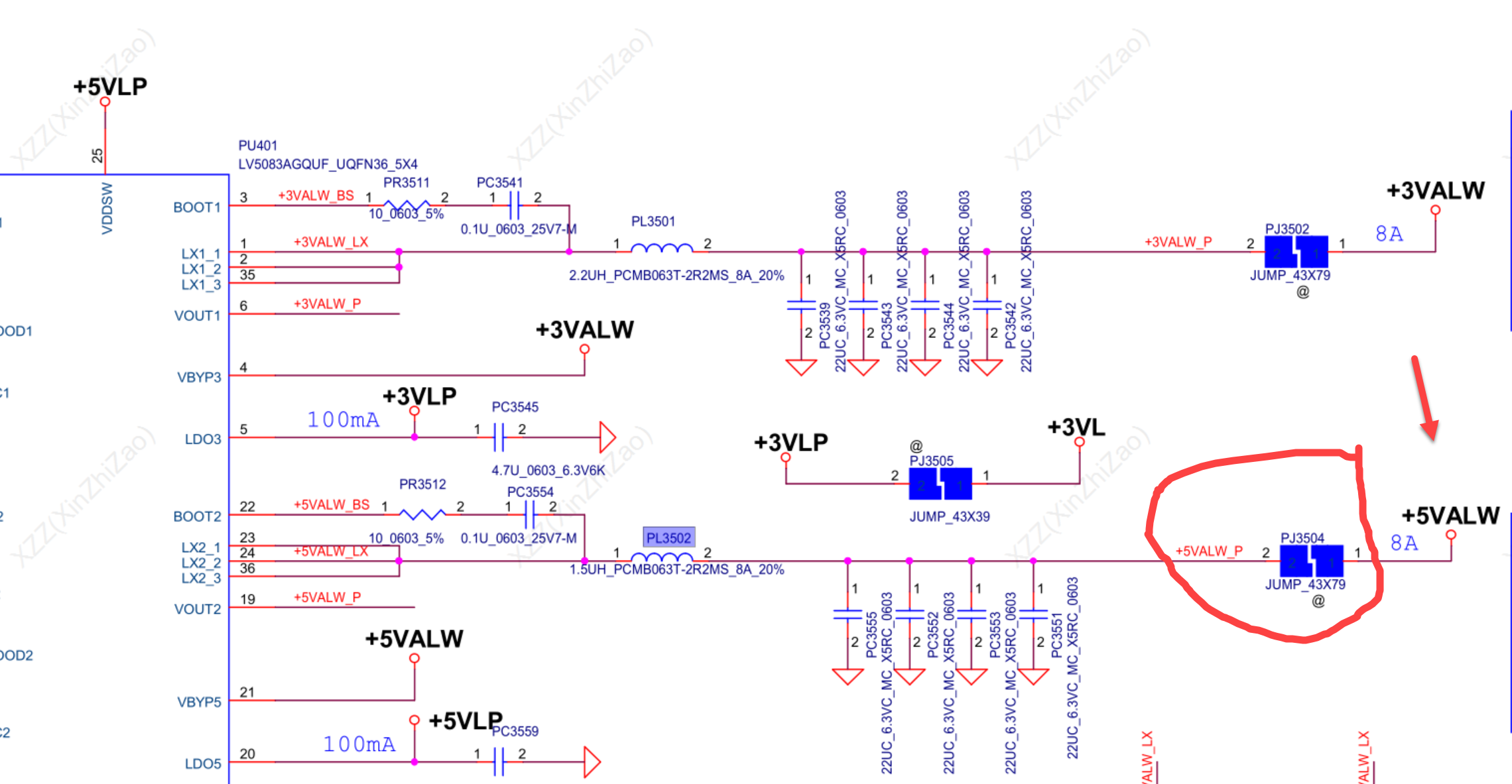

    Can you confirm this part #? Unable to locate it in my schematic.
      Lenovo LV5083A 6KU35 looks that this is the same component: https://www.aliexpress.com/item/1005002465864417.html
        Measure the resistance to ground of the 2 inductors (PL****) to the left side of this regulator.
          PL3502 7Ohm
          PL3501 1.6k Ohm

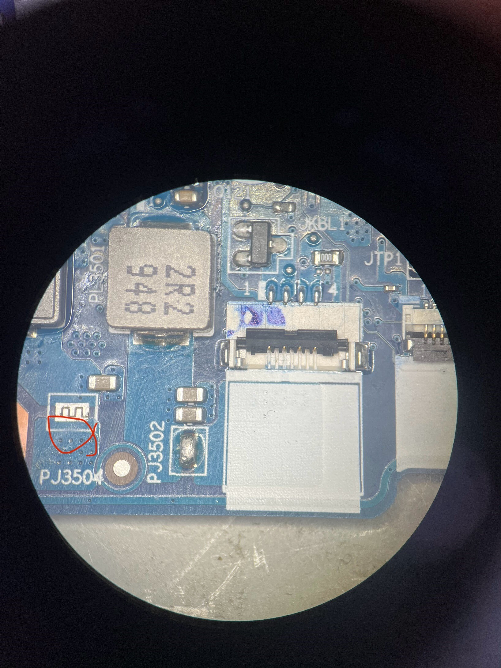

            Flux and carefully remove the solder blob at PJ3504. Do not power up without this blob.
            Measure the resistance to ground again at the inductors. Post the measurement.
              PL3502 About 60k Ohm (slightly going up)
              PL3501 1.6k Ohm
                Proceed to test the resistance to ground AFTER the solder blob pad. You have isolated the inductor and this PU401 by Lenovo and suspecting that it will no longer heat up as the shorted condition is removed. TBD.
                At this time, your short is on the consumer side of the +5ALW power rail. Confirm it with the resistance check.
                Would you have an adjustable power supply available for voltage injection? It will need to be set to 1 volt (not higher, to be safe) and 3-5A. For injection AFTER this removed solder short blob.

                    Measure the resistance to ground on each side of the pcb pads for PJ3504. One side was shorted. This last tested site is not shorting. Post the measurements. No power during these tests.
                      Bottom side (edge of the board) 6.5Ohm (Is the one where after applying 1v IC gets hot), top side 60kOhm
                        Can you post a pic of where and what is getting hot?
                          Left side of the IC
