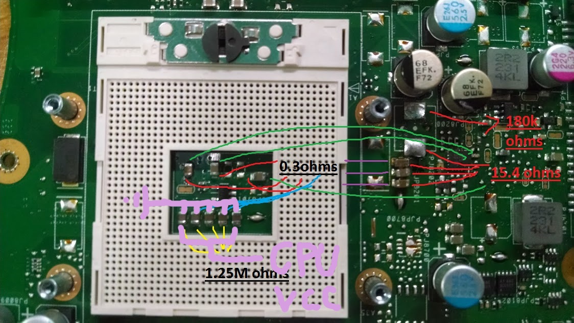

                                  • orientalsniper
                                    • Apr 2013
                                    • 461
                                    Re: Asus X401A Dead
                                    Don't do it unless you have done it before, you might damage the pads on the mb.
                                    Leave the chipset for now I don't think it's the problem, there are other things to rule out first. Do you have the 3.3V and 5V on the regulator IC.
                                    Searching for the short is a pain in the ass isn't it, having no schematic makes it even worse.
                                    Maybe someone has some ideas what could be the problem?
                                    I have practiced before taking out BGA chips, but I haven't had much success putting them back since I lack a stencil tool. I was starting to measure RT8206L, had 3.5V at pin 14 and 1V at pin 13V, couldn't measure the rest cuz I had to do something, when I got back they were all 0V.
                                    "I found a short in a coil against ground"
                                    Define some terms:
                                    what do you call a short, how many ohms?
                                    If a cpu socket cap is shorted (you measure across the cap ~ 0 ohms), then the same resistance should also be in cpu power coils (without the cpu), is it so? If it is, then use a 1V from lab supply to find the short...
                                    The desoldered coil does not look like it is from cpu power rail.

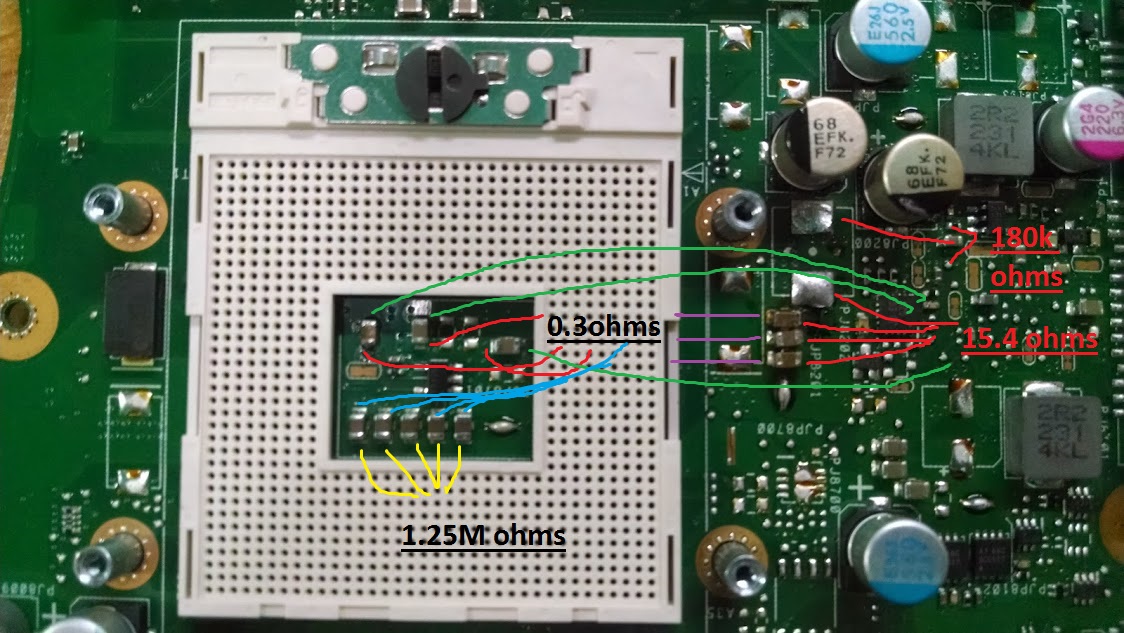

                                    I was using the continuity test in the Fluke DMM. If it beeped I called it a short. And for some reason now, only 3 out of the 8 capacitors are showing shorts.
                                    With the coil removed, the shorted pad has 15.4 ohms and the other pad has 180k ohms.
                                    I attached picture for better visualization.
                                    • khaahk
                                      • Dec 2013
                                      • 812
                                      • Estonia
                                      Re: Asus X401A Dead
                                      Forget the continuity test when looking for shorts on laptop mainboard. 15 ohms is normal resistance for low voltage rail which supplies northbridge, 6 ohms is normal resistance for graphics chip.
                                      I modded the picture to show the probable schematics of the mainboard in the cpu socket. One side of the caps is connected to the ground so 0.3 ohms is ok, the other side is connecting to the cpu voltage rail, this must show high resistance when cpu is not installed, as it does. So you do not have short in these rails. Look for short elsewhere or some other fault.
                                      • orientalsniper
                                        • Apr 2013
                                        • 461
                                        Re: Asus X401A Dead
                                        Thank you, at least I can start looking somewhere else.
