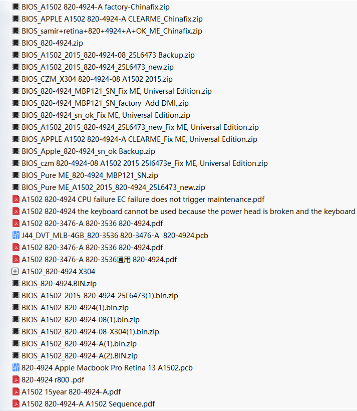

      If required, have access to a number of bios images for this model. Let me know.

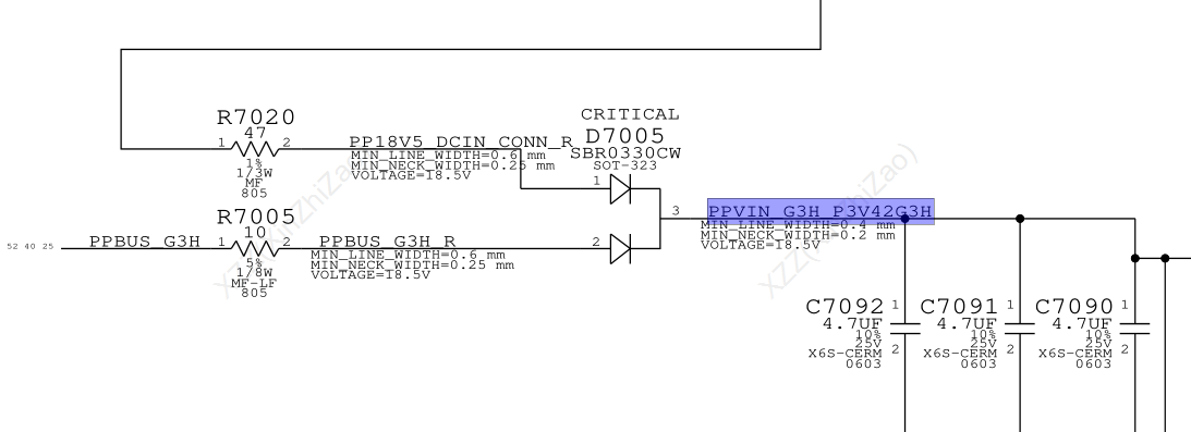

              Remove all power. Meter in DIODE mode.
              Measure the dual common cathode diode @ D7005.
              Red meter probe on pin # 1 of D7005; black meter probe on pin # 2 of D7005. The diode should conduct. Reverse the meter leads and the diode should block.
              Repeat the tests with pins # 3 & pin # 2.
              Post all measurements.

                Pin 1 with RED pin 2 with black: 2.328
                Pin 1 with BLACK pin 2 with red: OL
                Pin 3 with RED pin 2 with black: 2.460
                Pin 3 with BLACK pin 2 with red: 0.227
                Pin 3 with RED pin 1 with black: OL
                Pin 3 with BLACK pin 1 with red: 0.226​
                • mon2
                  • Dec 2019
                  • 14715
                  Replace this part and test again.
                  Pin 3 with BLACK pin 2 with red: 0.227​
                  confirms this part is defective.

                    I have replaced the diode and board is still exhibiting the same behavior.. I have compared the measurements I have taken from another board and it reads the same.. the diode readings was and still OK I suppose.

                        With no power to the board, measure the resistance to ground of each pin of this dual diode.
                        So measure pin #1 to ground; #2 to ground; #3 to ground. Post each measurement.

                          Pin #1 resistance to ground 72 kilo ohms.
                          Pin #2 45kilo ohms
                          Pin #3 490 kilo ohms

                            Check the resistance to ground of the CPU power rails. If too low, the CPU may be defective. The diode measurements are ok.
