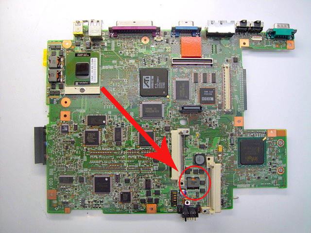

    I had my friends old IBM thinkpad a30 brought in for a fix. I didn't notice the noise till it was time to sleep. Searched for the noise everywhere, trust me I had a laugh at it.
    Finally found his IBM was making the noise, disassembled the laptop and found what seems to look like a coil, near the battery connecting pins. The sound it makes, drives me crazy!!!
    It could be the same problem with your G4, since both laptops are pretty old.

        The laptop was charging fine, if powered off and the batt. left in, it would make the strange noise.
        Same thing for the IBM a30, it looks brand new, externally and internally. Nice to see old hardware still in use.
        Test it with your new battery first, then I would update the bios.
        If the symptoms are not gone then I would start checking the mb.
