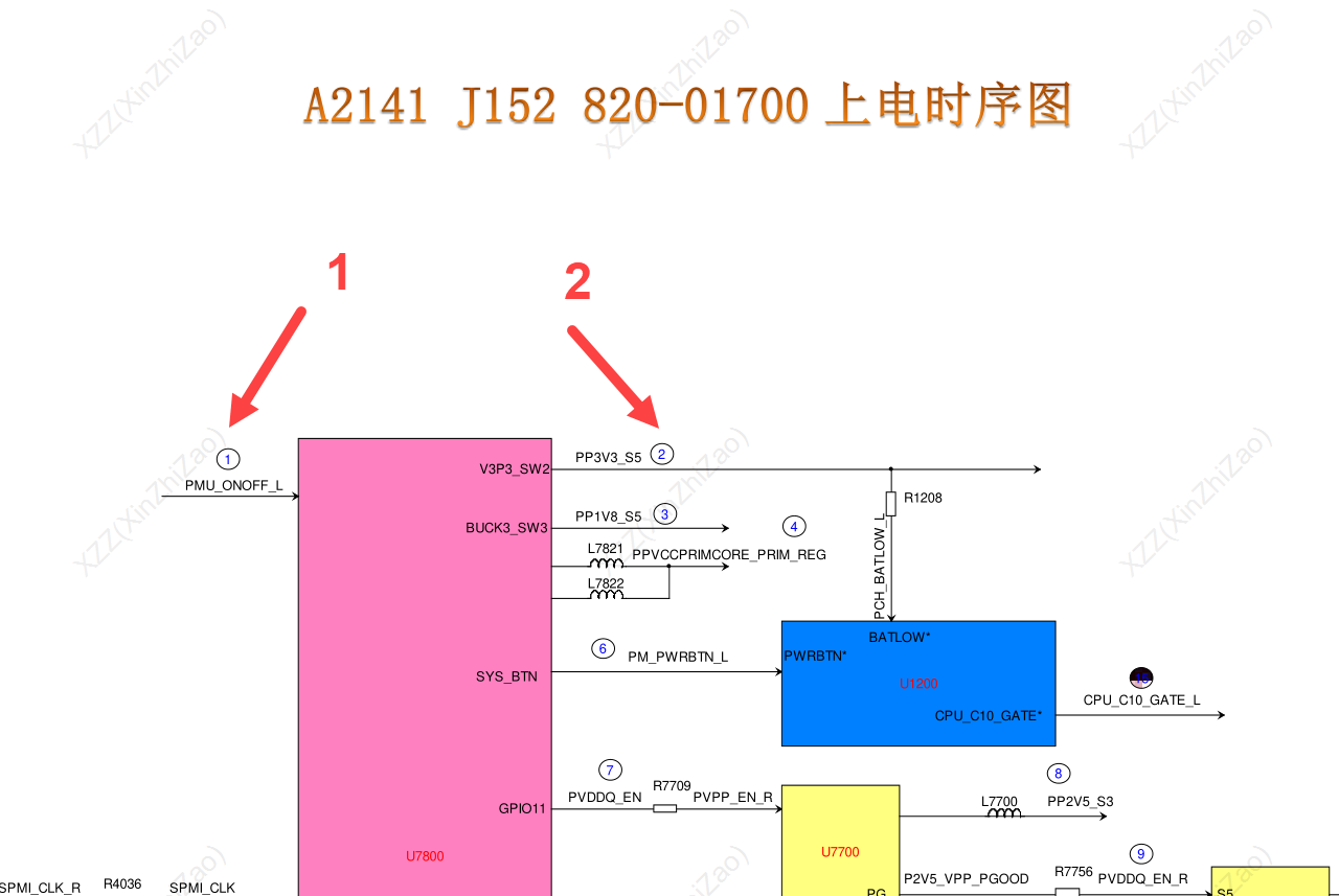

      With no power to the board -> measure the resistance to ground of PP3V3_S5 (created by U7800, N10). What is the resistance to ground ?
      • Sergio Kub
        • Jul 2018
        • 177
        • Brasil
        18.2 K Ohm... measured at R9802 (1)
        Is there an enable for this source on this IC?
        • mon2
          • Dec 2019
          • 14679
          See attached. The enable will be from step # 1. What is the voltage to ground @ #1 stage ?

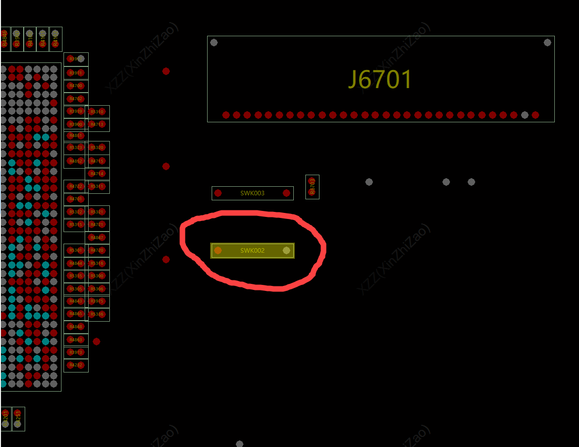

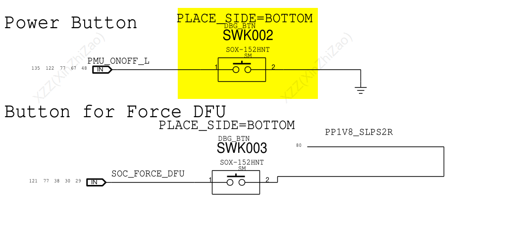

          This is the PMU_ONOFF_L signal.
          Review the power button pads to mimic the ON/OFF power button.

            Measure the outputs of the IC (U7800) and all with high resistance.
            The lowest resistance outputs were B1 8.7 Ohms and L16 47.5 Ohms, which I think is ok​
