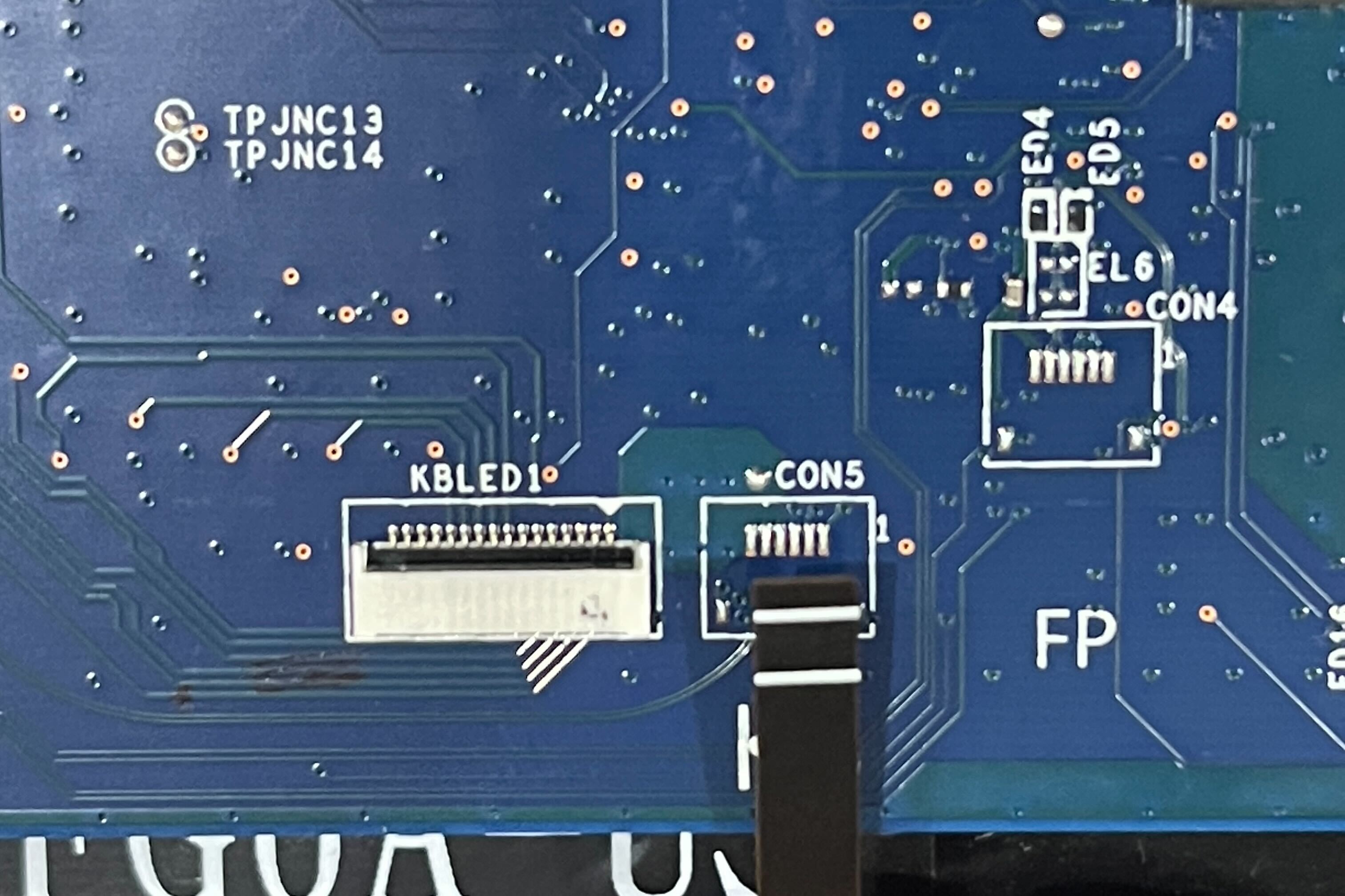

MSI Katana B12VFK keyboard backlight
  • Dobrowol
    • Dec 2020
    • 9
    • Poland
    Hi. I need to replace the keyboard in MSI Katana B12VFK. Unfortunately, there are no keyboards with a wide backlight flex available. However, they come with a narrow flex. Do you think that if I put a connector that the manufacturer did not install in this version, will the keyboard backlight work?​
  • mon2
    • Dec 2019
    • 14731
    Carefully measure the voltage to ground of each of the missing connector's PCB pads. The large cluster of pins = ground. This will confirm if the exercise will be successful or not.
