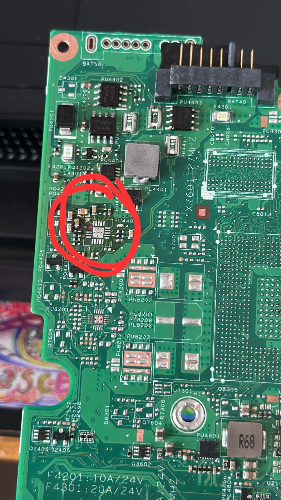

    GOOD DAY,
    I NEED HELP SOMEONE KNOWS WHAT CHARGING IC HANDLES THIS BOARD, IT IS FROM A LENOVO S410P, BUT I REMOVED THE INTEGRATED ONE AND IT IS IN VERY BAD CONDITION YOU CAN'T SEE THE LETTERS.
    IT'S A "BQ​"

    What does the silk screen read? It is covered in the red pen.
    PU4401 ?

      in the screen printing it is PU4401

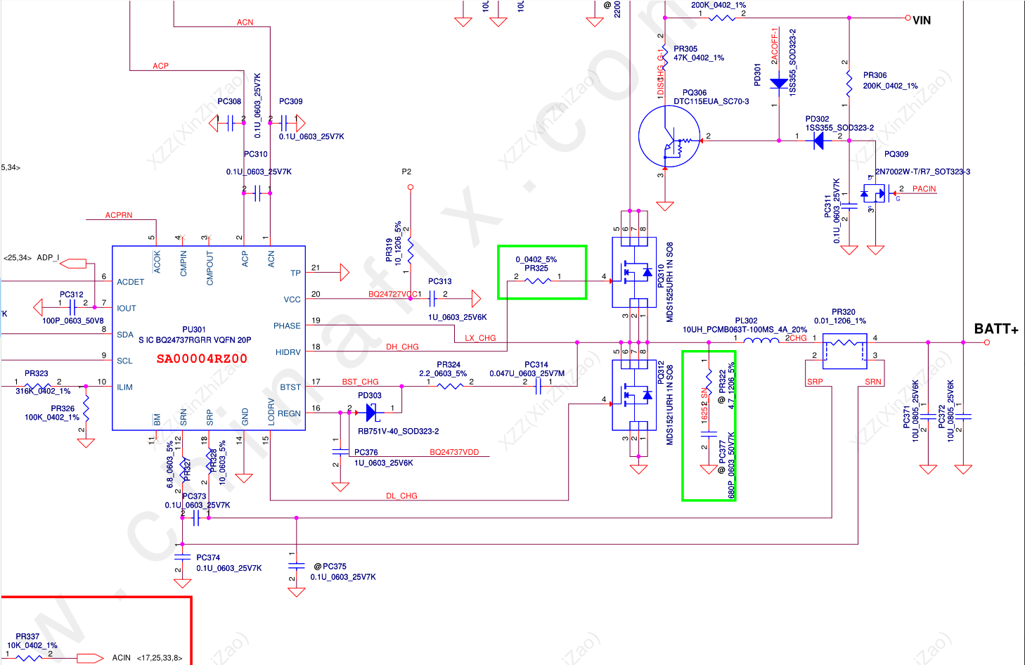

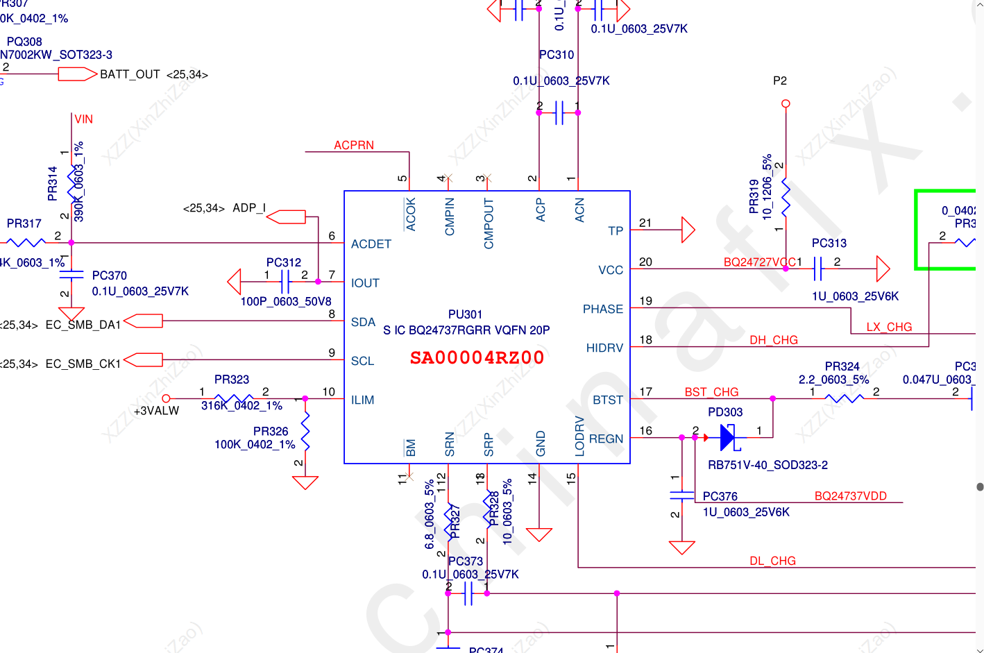

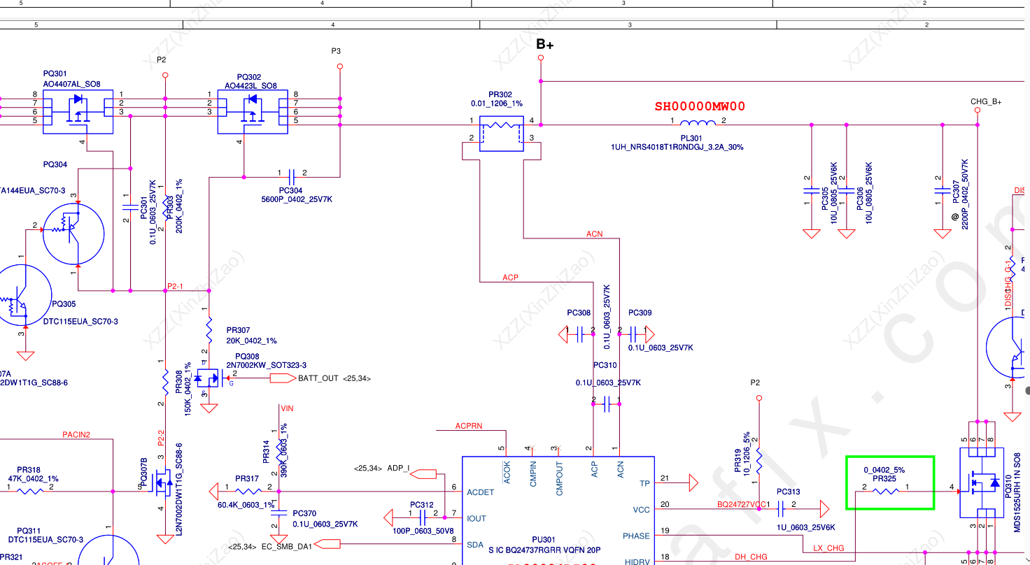

        My bet is on this part is BQ24737RGRR = 20 pin QFN. Review pins 12 & 13 and you will see 2 x black SMD resistors on the RIGHT side of the part. Measure their resistance of each and post their values.
        These are current sense path related resistors. One should be 6R8 ohms and the other should be 10R ohms. Confirm this detail.
        See a partial schematic from another Lenovo design.
        On your board - QFN pins 1 & 2 are missing and these are linked to the ACN (pin 1) and ACP (pin 2) if our guess for the charger IC is correct.
        These pins will be difficult to solder back but not impossible.

          Suggest to post another pic of this logic board and the missing charger IC (without the red marker) - need to study the other parts that surround this QFN PCB layout.

              pin 12 = 7.6 ohm
              pin 13 = 10.2 ohm
              I was checking pin 1 and 2 and I have continuity. It is normal?
              These are all good measurements. You have confirmed the resistor on pin 12 and also the one on pin 13 and they are matching the expected schematic values.
              Yes, pin 1 to 2 will appear to be like a direct short since there is expected to be a 10 milli-ohm = 10/1000 ohms resistor across these 2 pins. This is a special current sense resistor.
              From the above details, fairly confident that you should be to consider the same charger IC as posted in the above partial schematics. Certainly do review other feedback but this 20 pin charger IC looks to be the winner.
