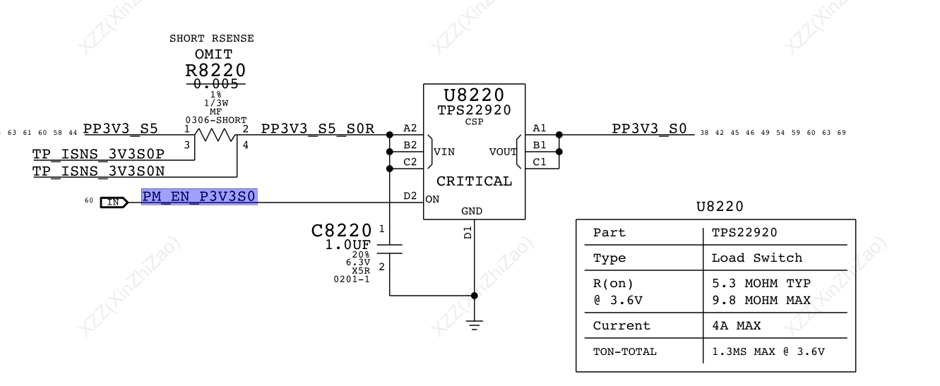

    Good Afternoon,
    This is my first post here so I apologize if I miss something.
    I'm working on an A1708 that draws 20v and 0a with the board removed.
    When installed in the machine, it takes 20v and 0.1a. The fan spins up and the trackpad clicks.
    Some measurements:
    PPBUS_G3H: 13.13v
    PP3V3_S5: 3.3v
    PP5V_S4: 5.1v
    PP3V3_S0: 0.6v
    Any help would be appreciated. Let me know if more measurements would help.
    Thanks in advance

    Welcome.
    PP3V3_S0: 0.6v
    Remove all power -> meter in resistance mode -> measure the resistance to ground of:
    ​​​​​​​PP3V3_S0
    Post your measurement in ohms.

      Thanks for the reply. I apologize for the late response.
      I'm reading 17.8 k ohms on PP3v3_S0 or 0.376 in diode mode

        This rail is not shorted.
        Carefully measure the voltage to ground for the following related signals:
        PP3V3_S5_S0R ; near U8220
        PM_EN_P3V3S0 ; neat U8220 - this is the enable signal for this PM_EN_P3V3S0 power rail
        Suspecting that with the partial voltage present on PM_EN_P3V3S0, that U8220 is being enabled but this load switch is defective. Post each measurement.

          I have 3.3v on both:
          PP3V3_S5_S0R: 3.3v
          PM_EN_P3V3S0: 3.3v
          I noticed U8220 is missing! I'll take one from a donor board and see if that solves the issue. I don't see any other signs that the board has been messed with.

            Replacing the missing U8220 fixed the issue and it's working perfectly.
            Thank you so much!
