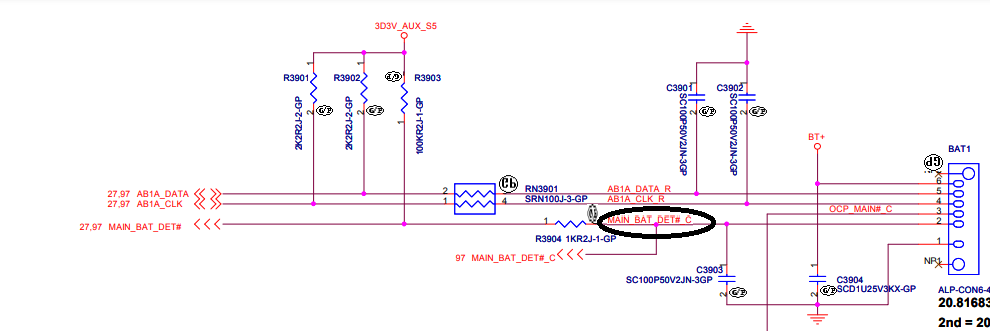

                      Contact # 6 on the battery connector is BAT_DET#. The '#' suffix denotes an ACTIVE LOW signal. If this line is a logic LOW = '0', then the battery is present; otherwise with a logic '1', the battery is ABSENT.
                      You have a logic '1'. Take a piece of wire and ground this contact #6 AND have a battery installed. Test again.

                            Pin 6 is BAT+
                            Your "pin6" is same as "pin2" in my interpretation. I have "BI" symbol on that pin from battery side. I believe it means "Battery In".
                            So, I did it correctly and SDA value stays the same (((.
                            I use this schematics and it suites my pinout 100%.
                            • mon2
                              • Dec 2019
                              • 14544
                              Sorry - my bad. Just came back from a Costco run. My reference is a G3 schematic - can you link yours in the schematic forum?
                              What is the voltage to ground of the pull-up voltage = 3D3V_AUX_S5 ?

                                Here is the schematics I rely on.
                                Page 39.
                                https://www.badcaps.net/forum/troubl...849#post770849

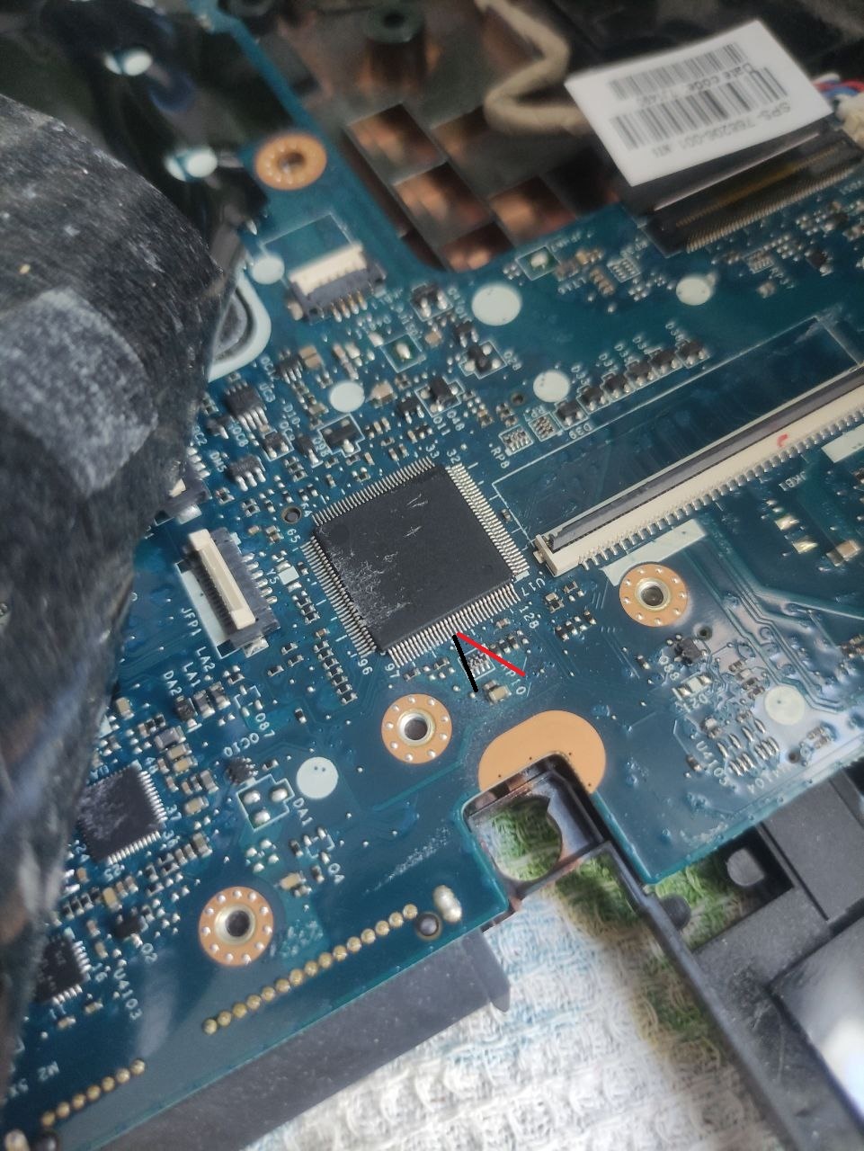

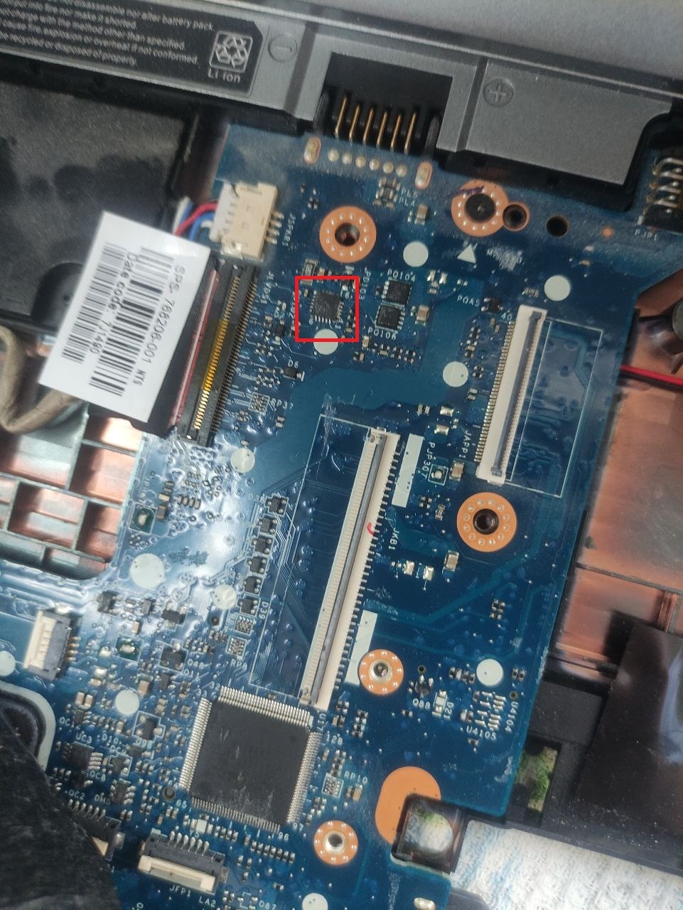

                                    CMOS Battery was 2.67V. Changed it to a new one. Now it's 3.3V.
                                    I had to disassemble laptop to confirm rtc bat, so, I made some additional tests.
                                    I checked charger BQ pins 8 and 9. They are 2.55 (SDA) and 3.38 (SCL).
                                    After that I checked pins 111 and 112 of MEC1322-NU. They have same measurements for SDA and SCL - 2.55 and 3.38.
                                    Is it possible that my MEC is malfunction?
                                    How can detect BQ version (it has no writings on it (((( )?

                                        With no power -> also confirm the resistance of R3902.
