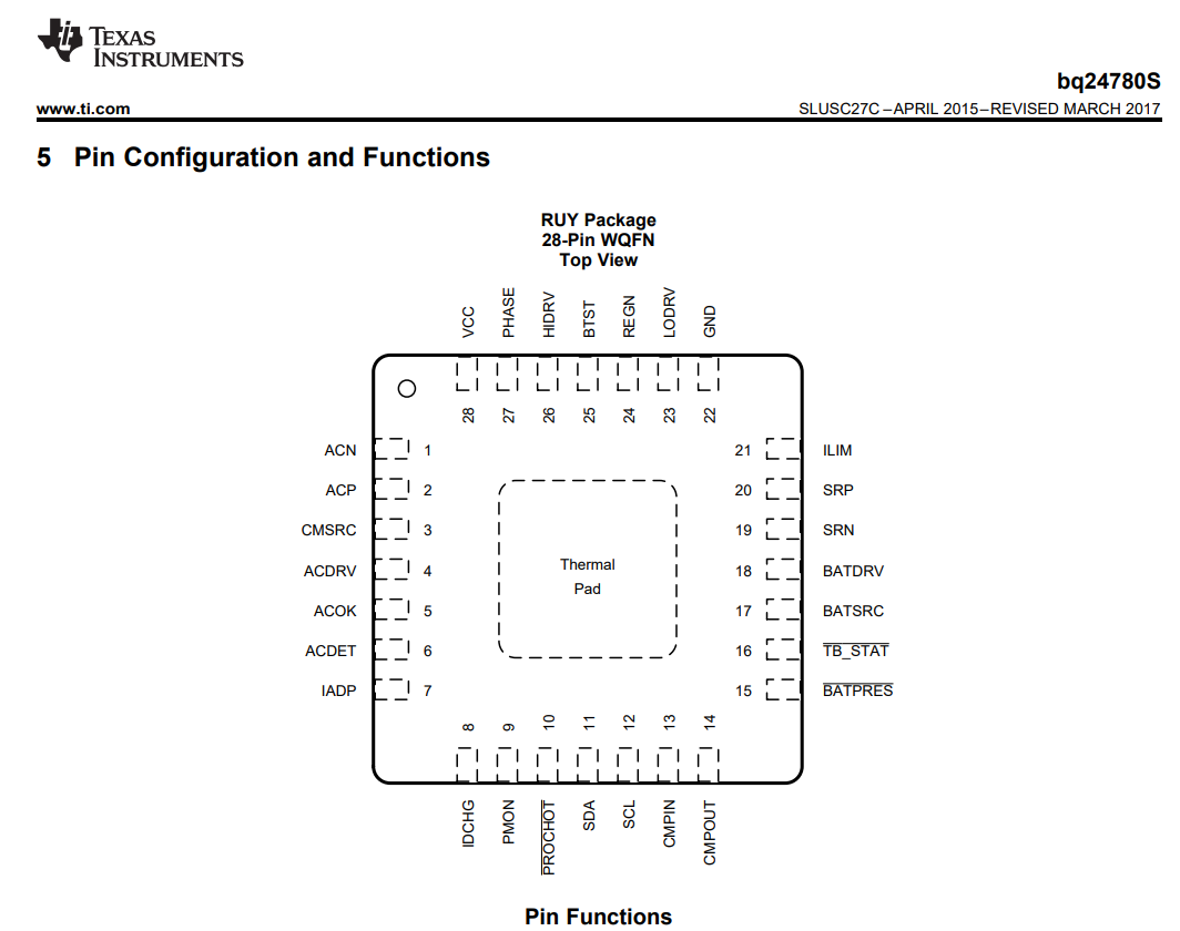

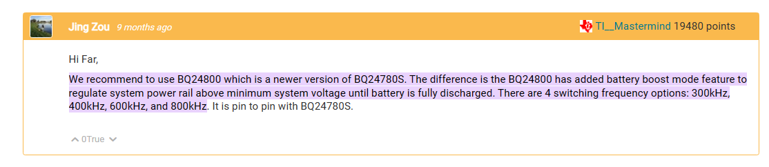

        The ‘R’ has a few more features than the ‘S’ version. If the software makes use of the extra registers then no it will not work. However the parts are drop in replacements for each other so no harm to test it if the part is available to you.

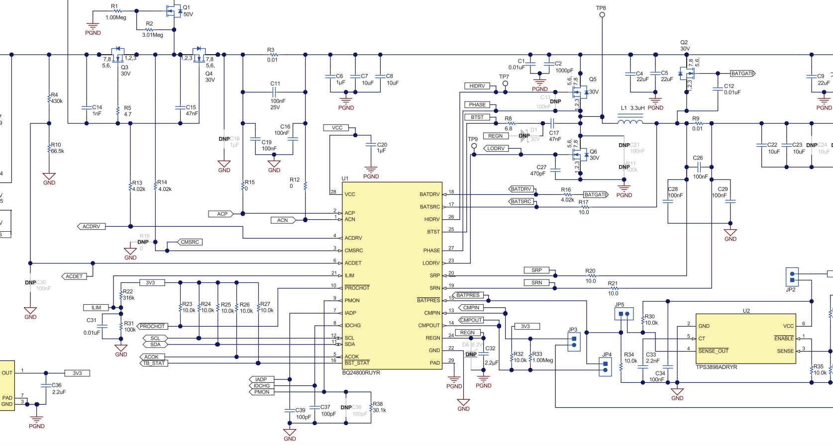

            OMG - yet the TI forum (FAE) states the 2 devices are pin-for-pin compatible with each other.
            From the pinout - they look to be compatible as mentioned in the TI forum. Could there be another fault on the logic board?

              BQ24780S is suitable replacement for 24800. the IC has burnt for some other reason. You need to remove the charging IC and share resistance to GND on each and every pin of charging IC
