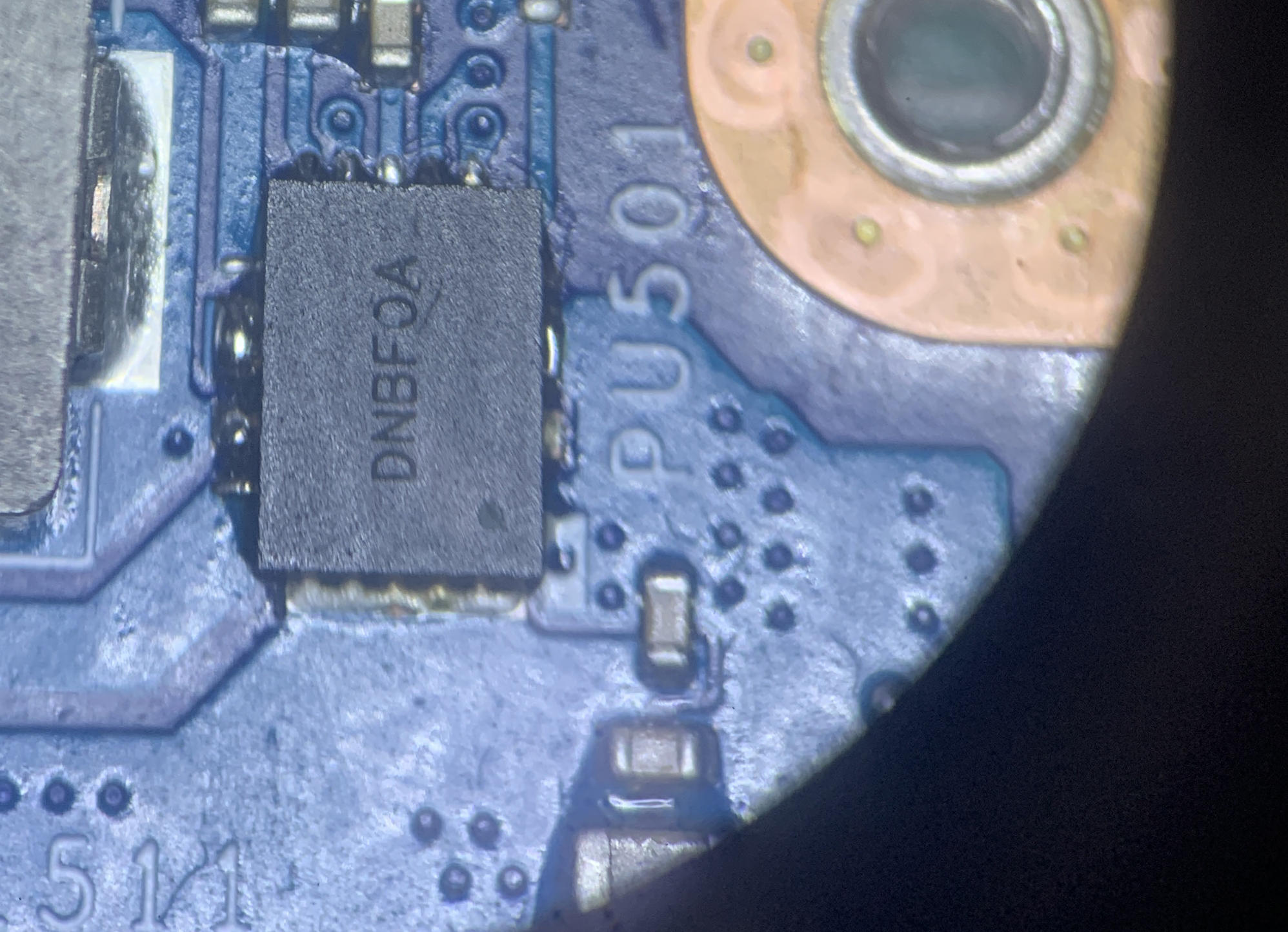

Compal LA-M36AP .Need help identify this ic please

    Need some help to identify this laptop ic please.

    Should we guest what board that you trying to repair ?

      DNB*** = Silergy but must be in the witness protection program. Not seen, so far, on public stores.

        LA-M36AP Dell
