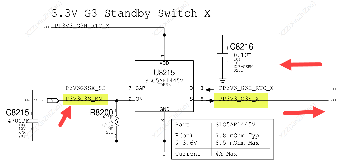

            Inject 1v at 3-5A onto this rail and check who heats up. Do not go higher than 1v.
            • shlomim412
              • May 2018
              • 45
              • israel
              i injected 1v to PP3V3_G3S_X and it only draws 0.02amp
              nothing seem to get warm... got it up to 1.5v around 0.04amp draw.. nothing seem to get hot...
              could be bad U3730 at this point?​
              • mon2
                • Dec 2019
                • 14636
                Some misunderstanding here. If you truly have a 1R5 ohms resistance to ground on PP3V3_G3S_X rail then someone will be heating up and the current draw will be much higher. Since you do not have this observation of the current draw, the resistance measurement may be in error.
                Remove all power -> meter in resistance mode -> measure the resistance to ground again of this power rail. Post a pic of the front face of your meter for a review.
                This power rail is being switched through a load switch (acts like a solid state relay) @ U8215.

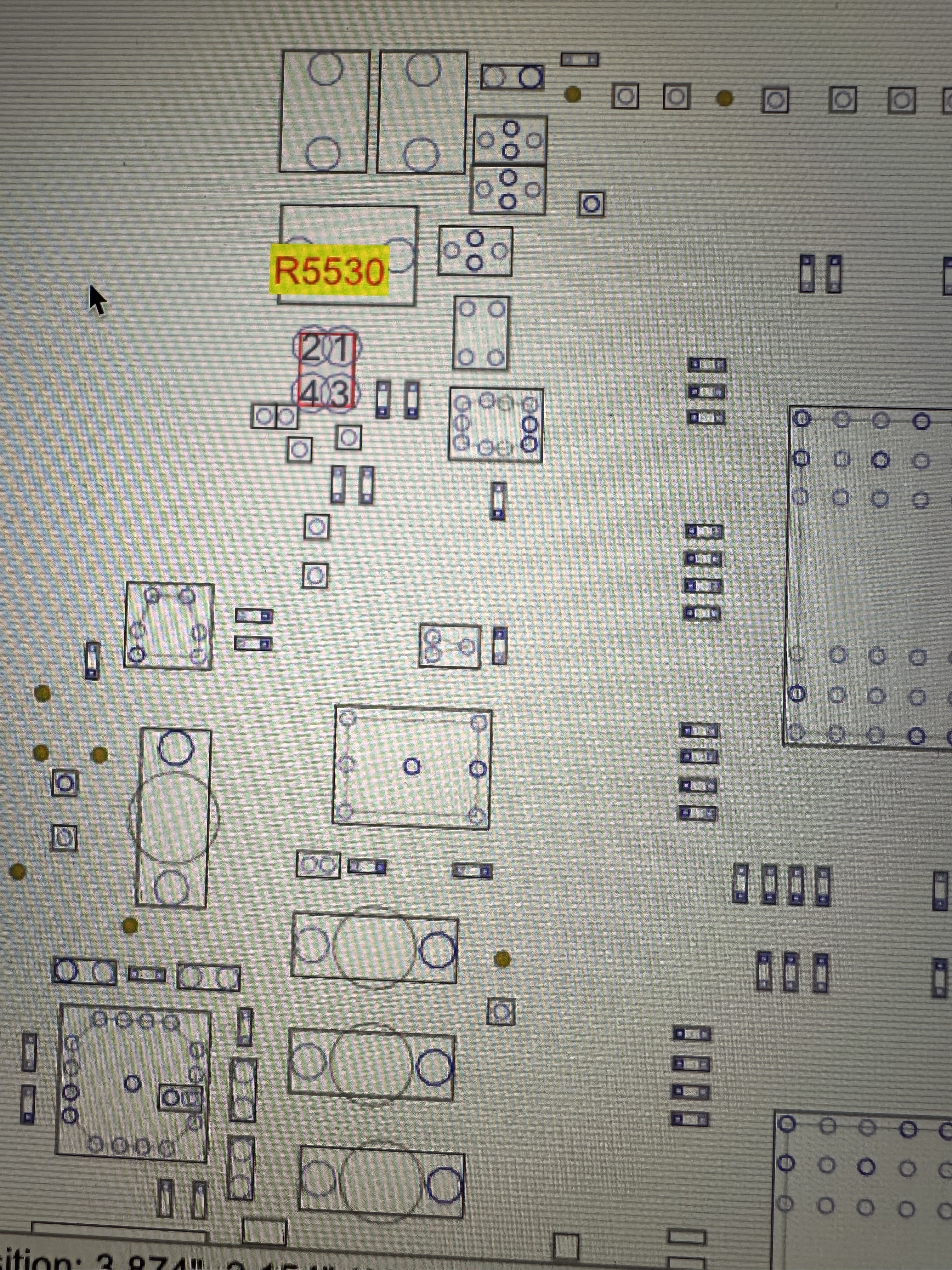

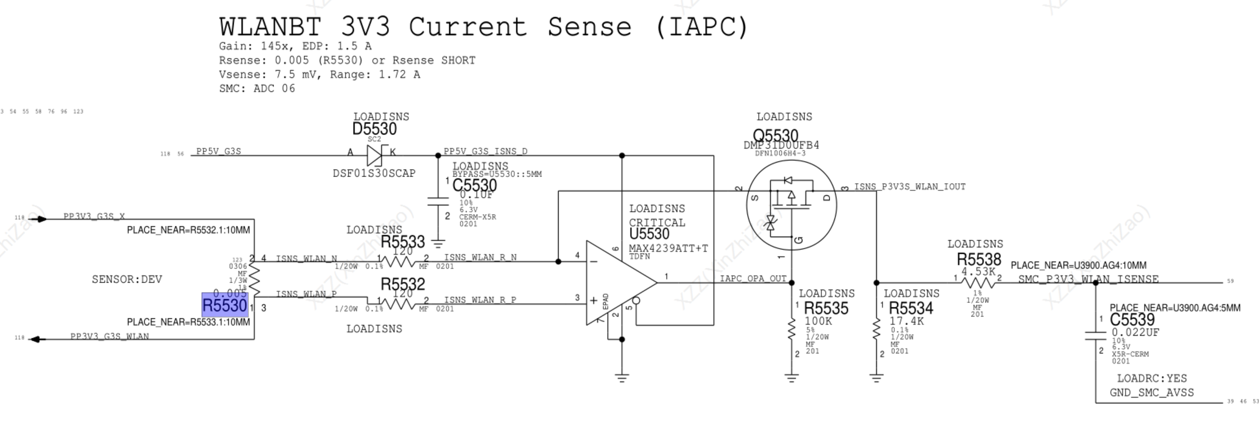

                            r5530 seem to be missing... also missing on other boards from the same model as well.
                            hmm...have these boards been worked on before? By another shop? I could be wrong here but believe this current sense resistor and related parts should be present on the board.
                            Do you see U5530 onboard? If yes, then this current sense resistor should also be present otherwise, the op-amp will report the wrong condition of the current sense.

                            • shlomim412
                              • May 2018
                              • 45
                              • israel
                              r5530 and u5530 is missing
                              the boards never been touched, all original and look like it's missing by design.
                              here are some attached photos of it..
                              also missing those components on a good working board
                              the low resistance on these rails could be the cause of the issue - PP3V3_G3S_X and PP3V3_GS3_WLAN ?
                              what is connecting between the two?
                              if yes, how would you recommend to try and resolve it?
                              thank you!
