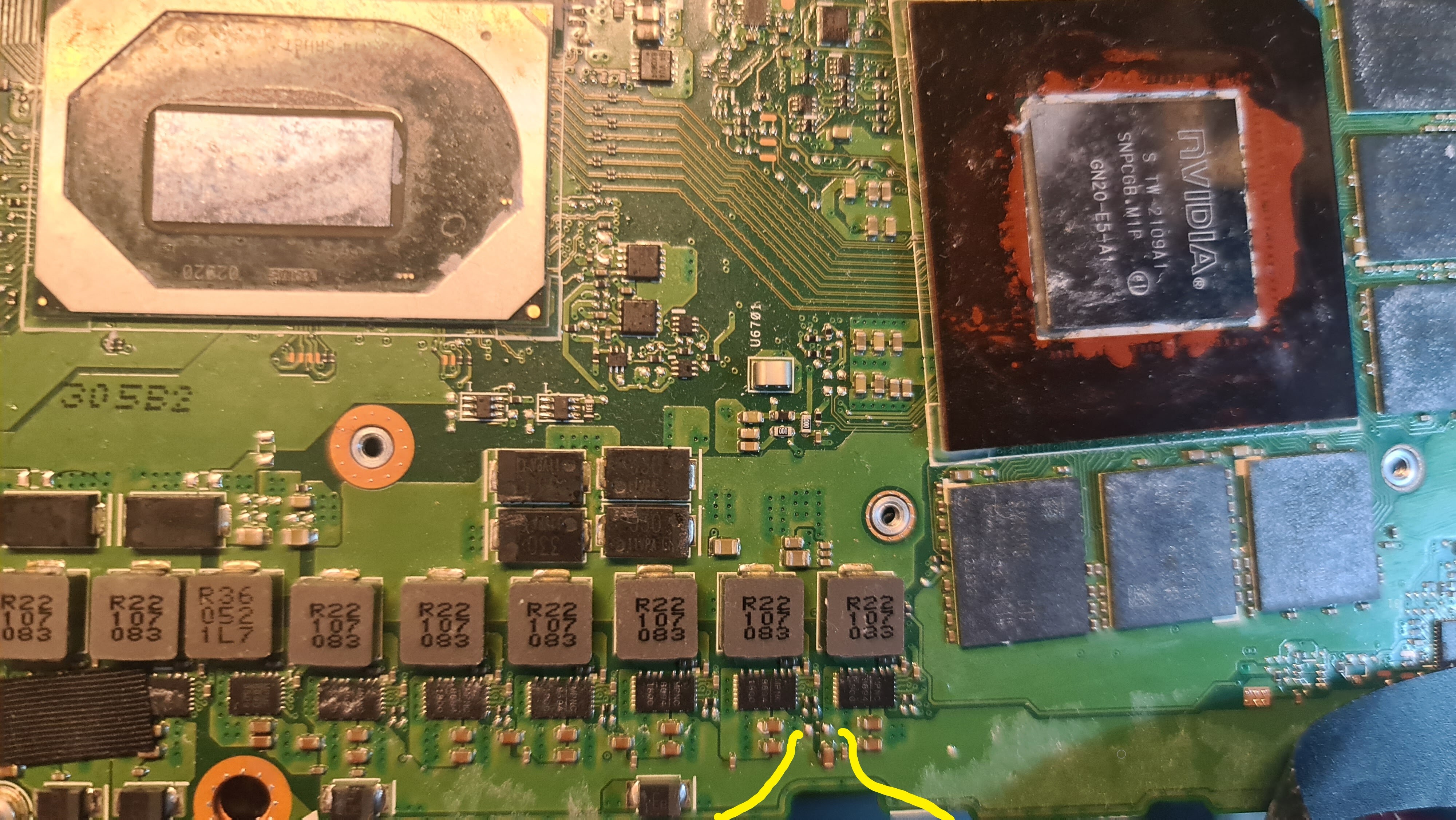

Asus UX582L no power

    So your +19V rail is shorted to GND. Remove the CLR and inject +1V/5A on the shorted pad of CLR. Dont inject more then 1V

      So I fixed this in the end and thank you very much mon2 for staying with me on this. I greatly appreciate it.
      It was a shorted cap as shown in the picture below. I replaced it from another board which was also not turning on so I will be troubleshooting that one too at some point. I have a couple of questions:
      1) Is there any way to find out what rating etc this capacitor is? I'm assuming the neighbouring ones are going to be the same.
      2) This seems to be a GPU or CPU cap. How would it have shown as a full short on the charging circuitry? I thought it would have had to go through a ~1v voltage regulator etc before getting back to the charging circuitry so would never show up as a full short.
