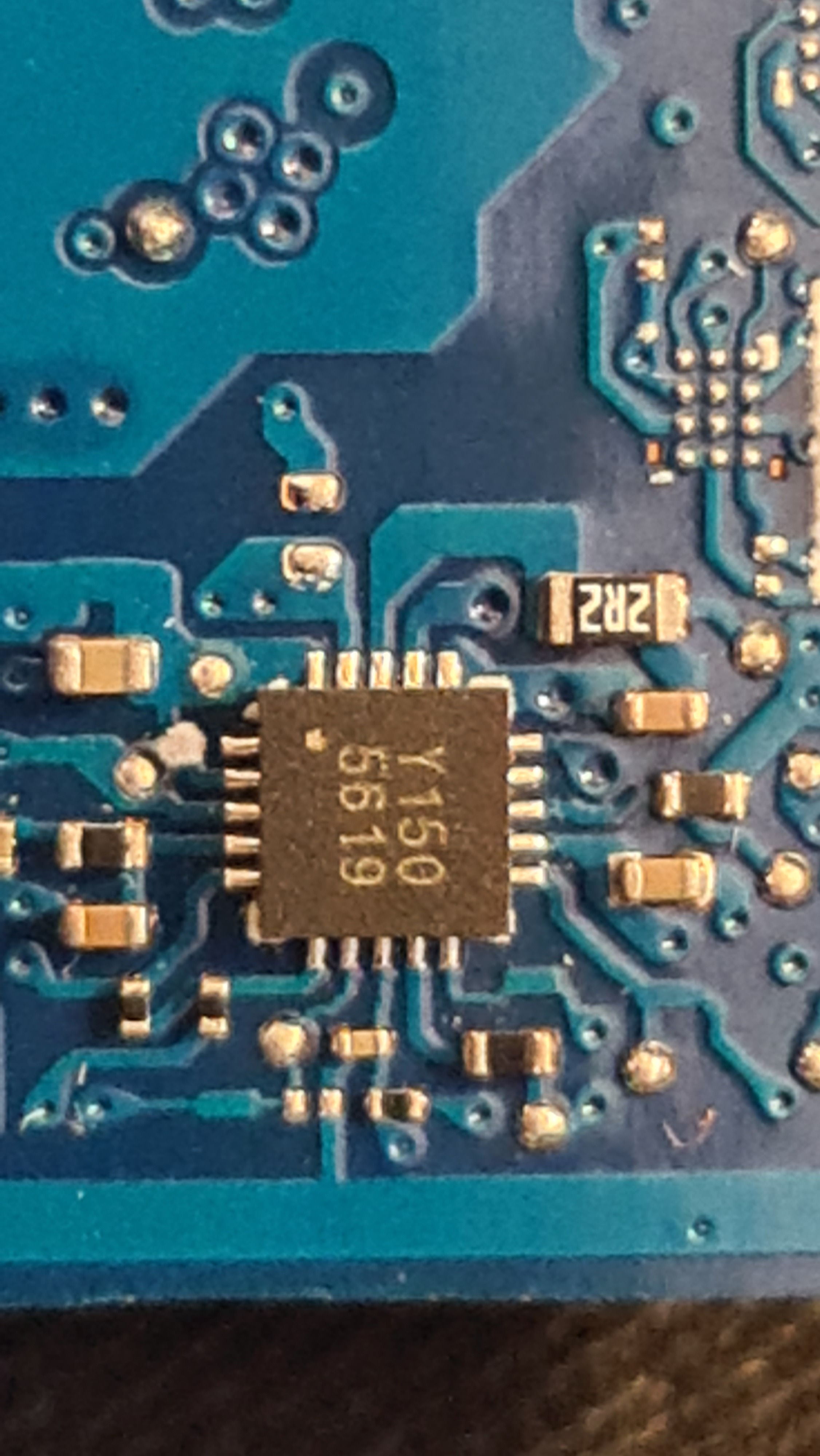

    board DAG7GCMB8E0 IC identification
    HP Laptop 14-dv2514sa board DAG7GCMB8E0. Checked the IC markings page but couldn't seem to find a match to this one.Click image for larger version  Name:	20240411_160724.jpg Views:	9 Size:	968.2 KB ID:	3251142

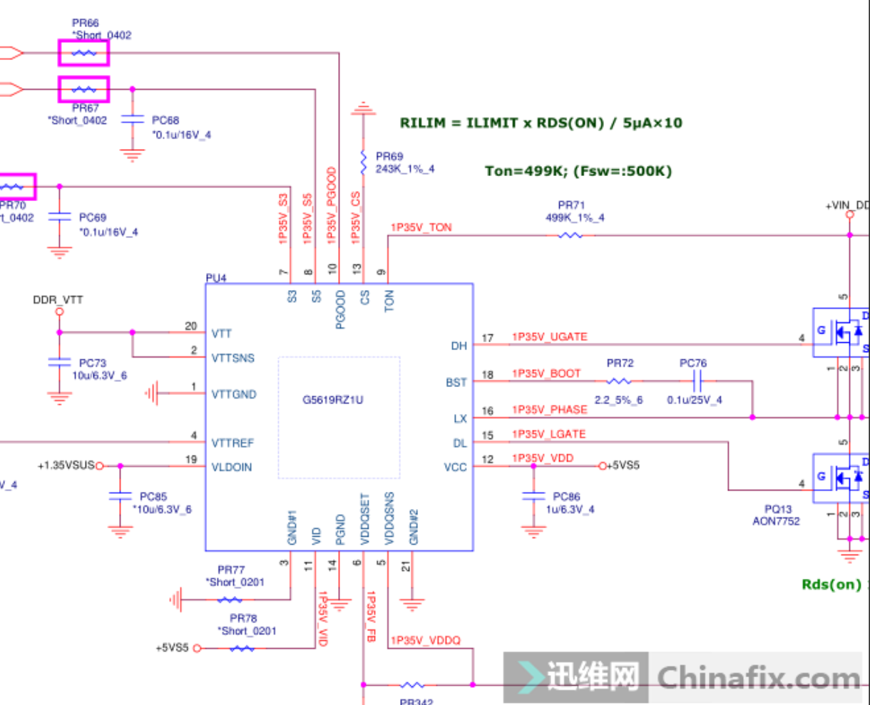

    • 14634
    GMT # G5619RZ1U

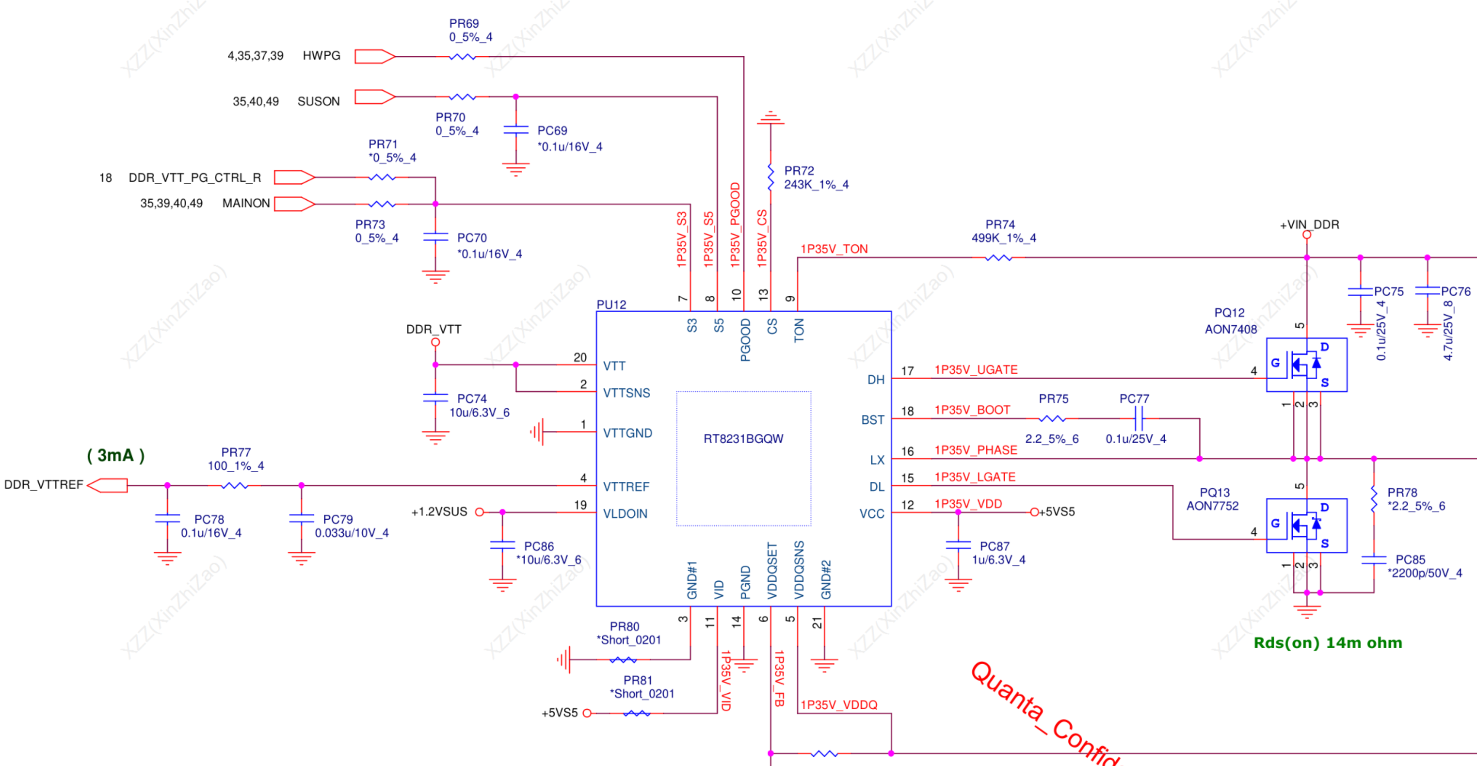

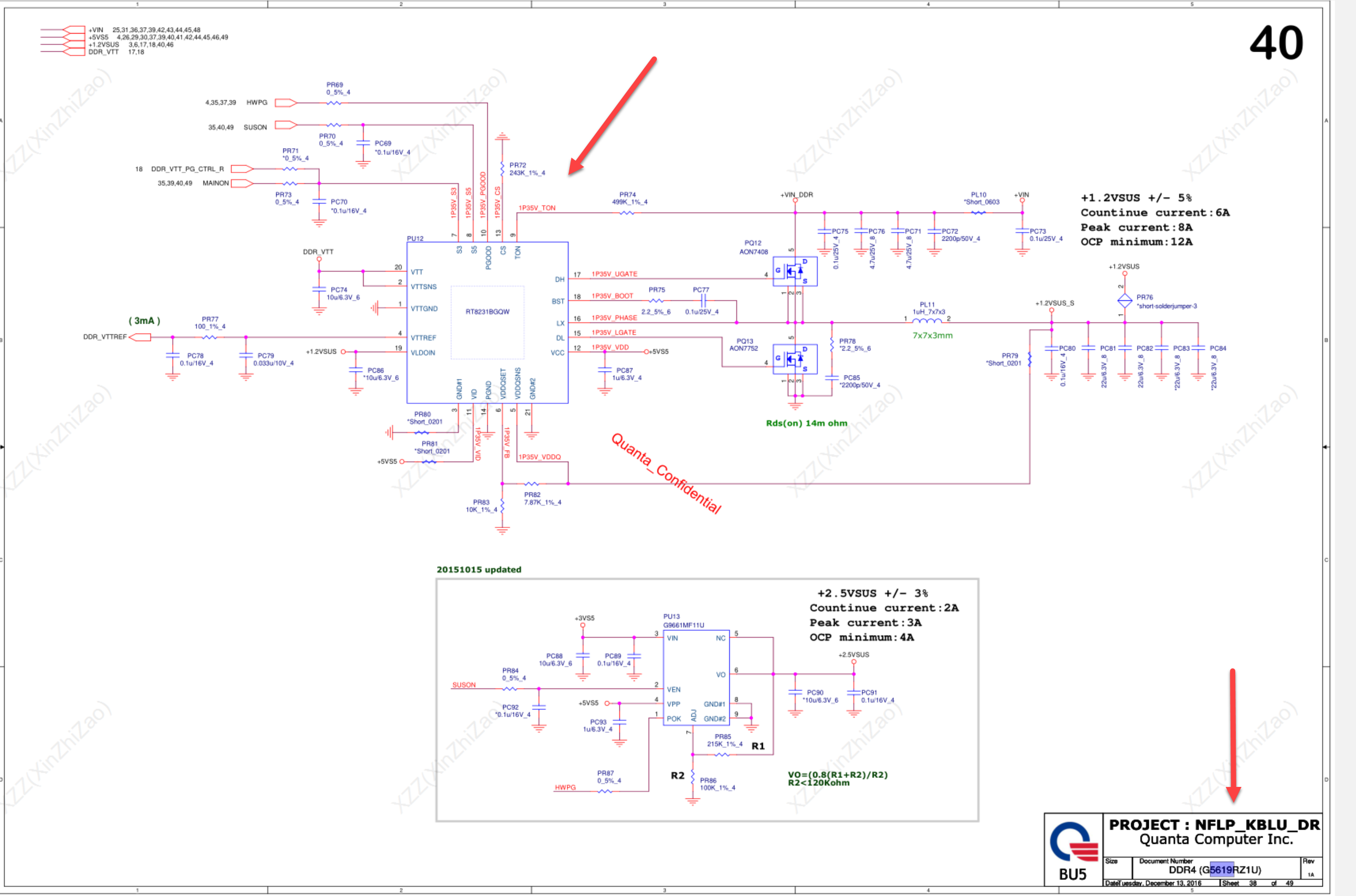

        Interesting find..see attached.
        The title block references the same part from GMT as posted in post # 2. But the actual suffed part is from Richtek with p.n . RT8231BGQW
        (2-5piece)100% New RT8231BGQW RT8231B 3T=FK 3T= QFN-20 Chipset - AliExpress
        * confirm with the vendor that they will supply the exact part
        Full datasheet:
        Complete DDR Memory Power Supply Controller (richtek.com)
        So it appears that these parts are drop in replacements for each other. Do double check the details of the pinout before sourcing.
