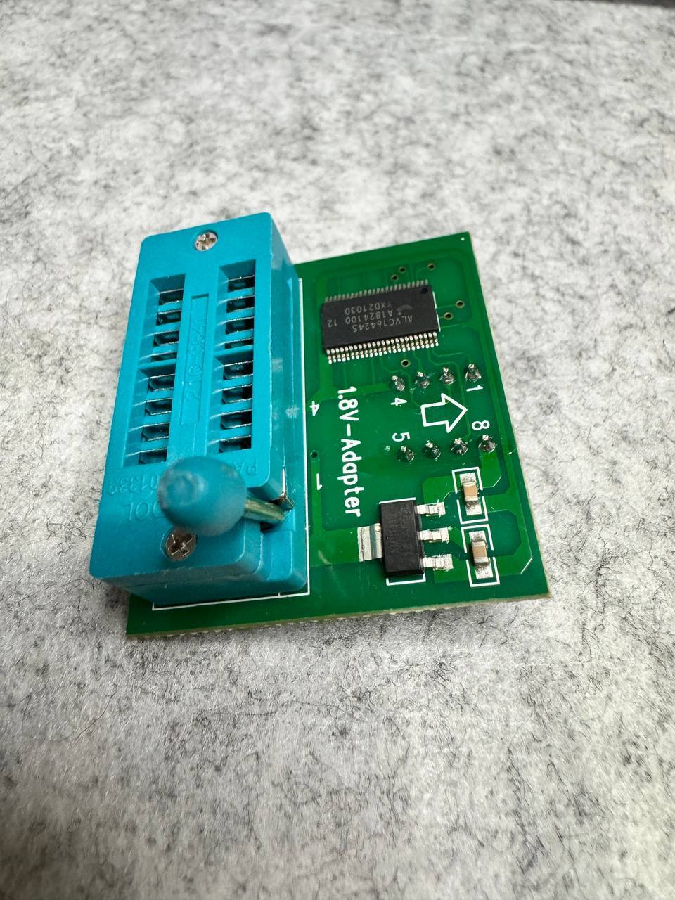

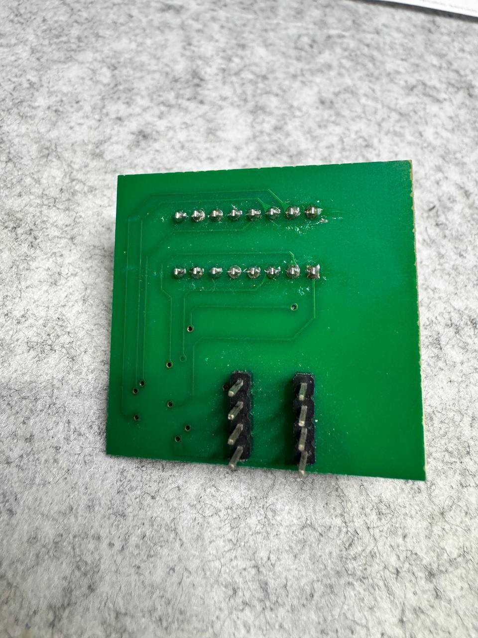

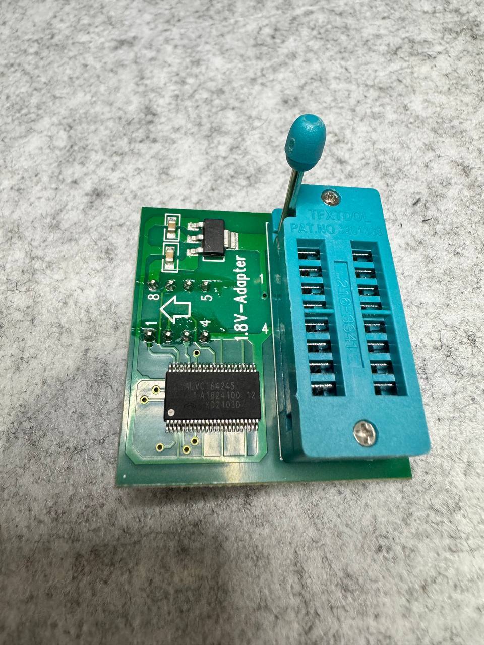

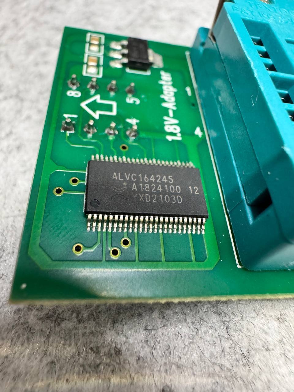

          Sure. Please see the photos attached. It is based on ALVC164245 IC and buck converter AMS1117 1.8V. I assume AMS1117 can be replaced with the one that outputs 1.2V instead of 1.8V. The question is can I replace ALVC164245 with TXB0108PWR? I should figure it out.
          Thank you for your explanation! If any level shifter is available for purchase in US/China, I can buy it and wait some time for delivery. Although, I think with your help I can built my own based on TXB0108PWR.

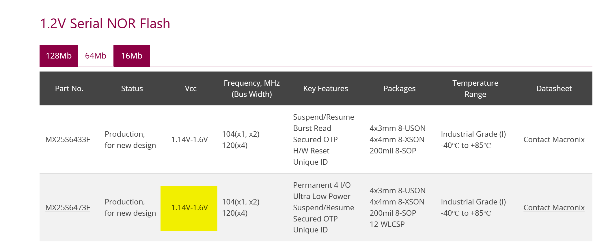

            Actually, it seems that Nexperia ALVC164245 used in my 3.3 to 1.8 level shifter supports wide voltage range, from 1.5 to 3.6V (https://assets.nexperia.com/document...ALVC164245.pdf).
            MX25S6473F (IC from MacBook) has Vcc range of 1.14V-1.6V, according to its documentation (https://www.mxic.com.tw/en-us/produc...Flash&n=PM2860).
            How do you think, will it be okay to just convert my level shifter to 1.5V (by replacing ASM1117) and use it with MX25S6473F IC? Yet it should work fine with 1.5V as Vcc, I don't know it it's okay to supply 1.5V onto its logic inputs.

              Yes, found the same on our local Amazon store. This is a bit of a pickle.
              The LOWEST voltage supported by this AVLC16425 (from the datasheet) is 2v7. Technically, 1v8 is beyond spec unless the vendor they have used supports this lower voltage. Respectively, the use of 1v2 for the low side is even further away from the officially supported voltage rail for the VCC. We need to be able to use 1v2 on one side and 3v3 on the other side.
              Perhaps this silicon can be 'pushed' down to use 1v2 which means just switch out the SOT223 LDO from 1v8 to a 1v2. Let me see if they have this in stock locally here in Canada for experimenting. We have 1v2 LDOs in the building. It will be a hack but the most simple test is to just use a 1v2 rail for the same piece of hardware you have.
              LOL - we are almost on the same wavelength - worth testing but not sure who makes the level shifter on your board. Are you sure yours is from NXP? TI also offers these but they have a higher VCC requirement.

                🙂 Yes, TI version has higher voltage requirements. It even does not support 1.8V and meant to be used in 5V to 3V shifters. It confused me too. But I think the logo on my IC is Nexperia (or its Chinese knockoff), which supports 1.8V.
                I can order both ASM1117 for 1.5V and 1.2V and try it out. With 1.5V it should work just fine, don't know about 1.2V.
                According to my latest question, do you think it is safe to put 1.5V on MX25S6473F inputs? Vcc can be 1.14V-1.6V.

                  Yes, we are thinking the same here again. Yes, it is perfectly safe to feed 1v5 on your flash device if the flash device is powered from 1v5. I think it is safe and borderline ok to consider this experiment to operate the level shifter @ 1v5 on the low side and 3v3 on the high side.

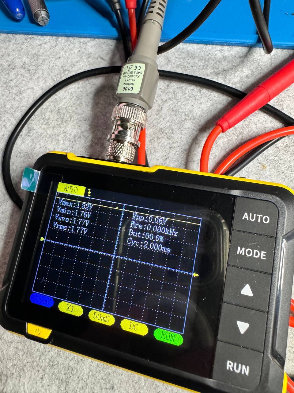

                                This is how 1.8V output looks like, please see the attachment.
                                I can borrow some tantalum caps from MacBook boards, if needed.
                                • mon2
                                  • Dec 2019
                                  • 14671
                                  No issue here. Your LDO is most likely ok with the use of the caps onboard.
